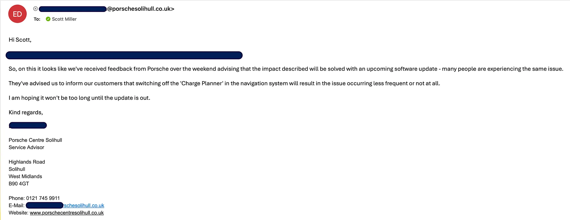

I got my reply form Porsche to my email (posted here earlier) telling them that customers were exasperated at the inconsistent information - most of which was garbage (I paraphrase) and some were taking coordinated action on this
The thanked me for the information on customers etc. and more or less acknowledged that the 3885 solution does not work, they suggested to use the switching off charge planner solution, they said that a team was working on a solution as a matter of urgency.
so FWIW replied thus.....
Many thanks Hannah for your prompt and positive reply.
It is heartening to hear that a team is working on this - perhaps Porsche PAG should publish a notice to customers on that simple point, so they don't feel they are being kept in the dark.
It is also good to hear you accept/imply that the 3885 solution does not work. Perhaps Porsche PAG could also address that with a notice to customers and perhaps avoid customers jumping through that unnecessary hoop? Again it would help to harmonise the information being given to OPCs and customers on this.
FYI The charge planner workaround you suggest has been identified and promulgated weeks ago by one of the Taycanform members - but this is the first time I have heard it from Porsche. Also, of course, not every Taycan owner is a member of the Taycan Forum and so many may not be aware of this workaround. Perhaps Porsche PAG could add this to a note to customers?
The main benefit of this kind of harmonising and honest communication, even if it does not solve the issue, is that it may help to make your customers feel valued; and, to understand steps are being taken to resolve the issue (eventually).
Anyways, I will paraphrase your reply on the Taycan forum so at least that small tranche of customers will have some consistent information - even if it's not direct from the horse's mouth.

Hi,
I just had a call from my dealer that my PCM has been replaced and after some tests they don't have the issue.
We know that it's not the case and I can see that there are in private mode now so it's not the same as when I'll drive it.
I will ask which PCM version was installed but I'm pretty sure it will be the old one with the 3885 software version.
Question to you guys, if we switch off the 'charge planner', what will change ? What are we going to miss during navigation with the pcm?
Jasper4S
Jasper4S
Jasper
Oct 5, 2022
1,508
2,207
Netherlands
Hi,
the car will not plan charging stops. Rest of navigation works as expected
