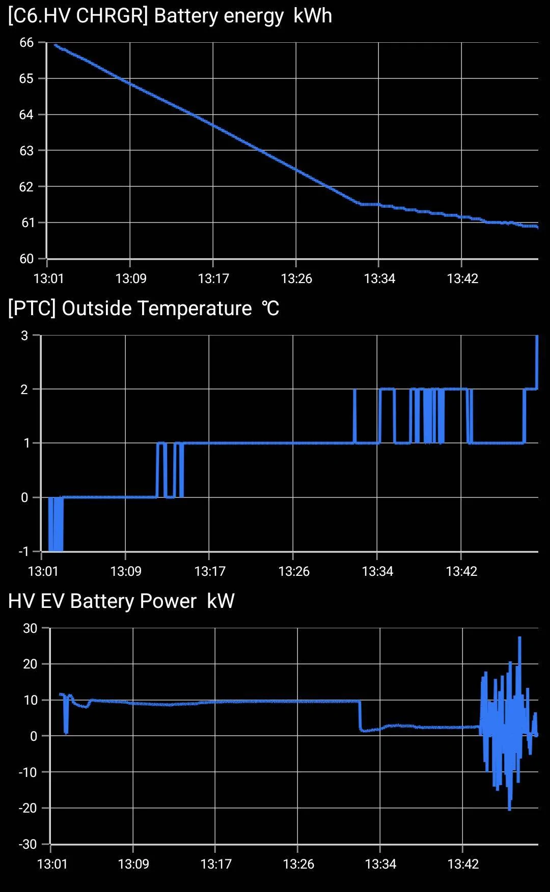

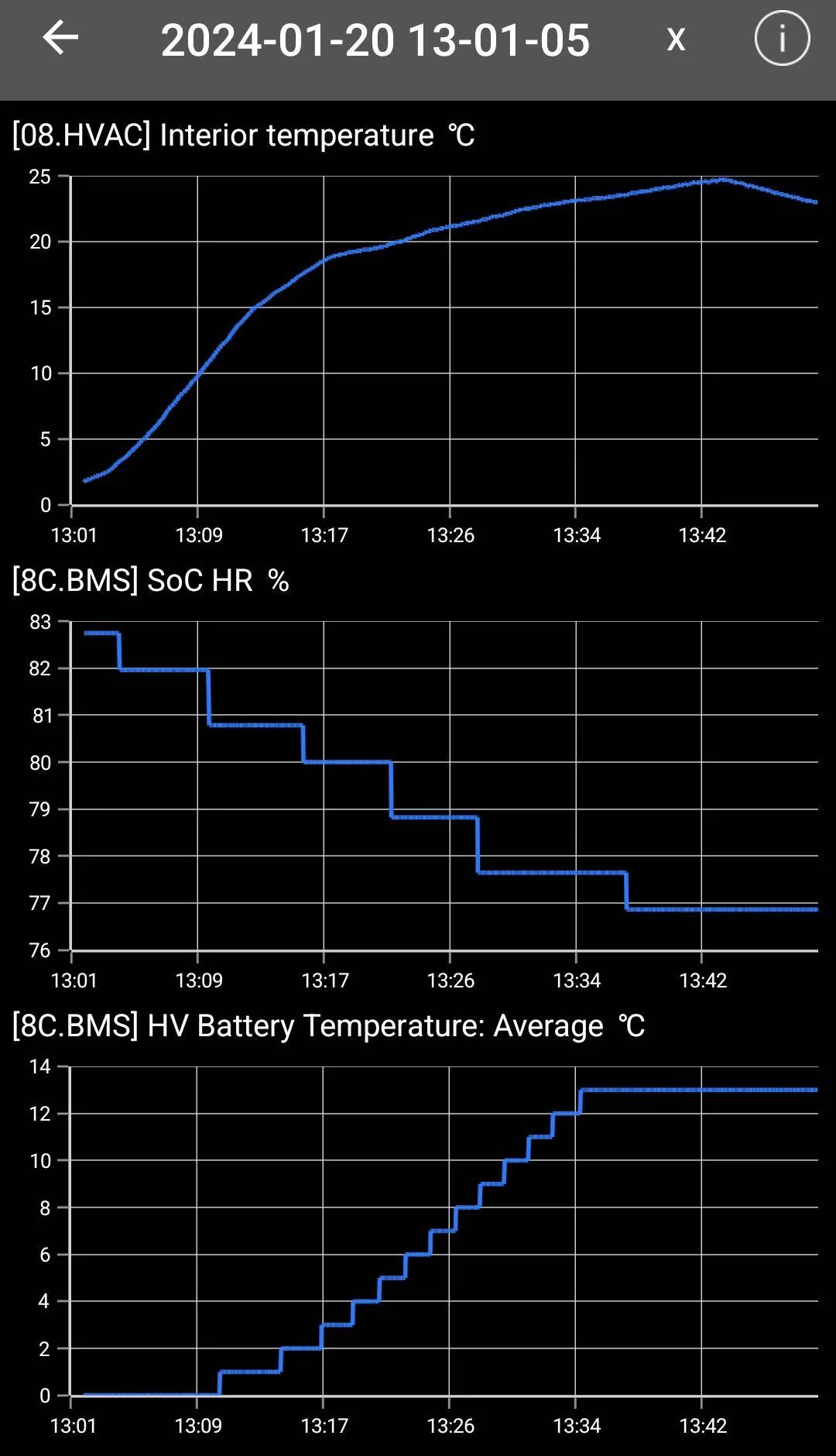

i ran a test this morning:
- initial conditions: car stayed outside all night, not plugged. All temperatures (outside, inside, battery) were equal to 0°. Battery was at about 83%
- i activated the pre-heat for about 40mn then drove the car. Temp required : 21°
Results are below :
- SoC went down by 6%, around 5kWh loss
- power required to heat the battery and the inside of the car is around 10kW. Quite high value, meaning if plugged at home, you are likely to see a SoC below than what you asked.
it goes down to around 2or 3kW when only waming the inside
- interior temperature raise by 20° in about 20 mn. it's already 15°C inside after 10 mn
- battery temperature : flat for almost the first 10mn (i guess that is the time needed to warm the heating system), then linear increase up to 13° in about 20mn, then flat. so in total 30mn to warm the battery
Conclusion :
in quite "extreme" condition (at least for Belgium), you'll need 30mn to warm the car, at a cost of about 6% SoC

Well measured!
I plugged mine in and it drew 6.8kW so still a small loss of SOC over the hour. Interesting mine got to 16C and yours stabilised at 13C.

How did you monitor this data?

Well measured!
OTOH I only used the dash display.
I used Car Scanner with an ODB II adapter.
Indeed, strange that one went up to 13° and the other 16°. I see two possibilities:
- different software version
or
- the battery is again heated after 45 (?) mn. I stopped after 40mn while you pre-heated the battery for 1hr
unless because yours was plugged (although I was still above 75% SoC)
