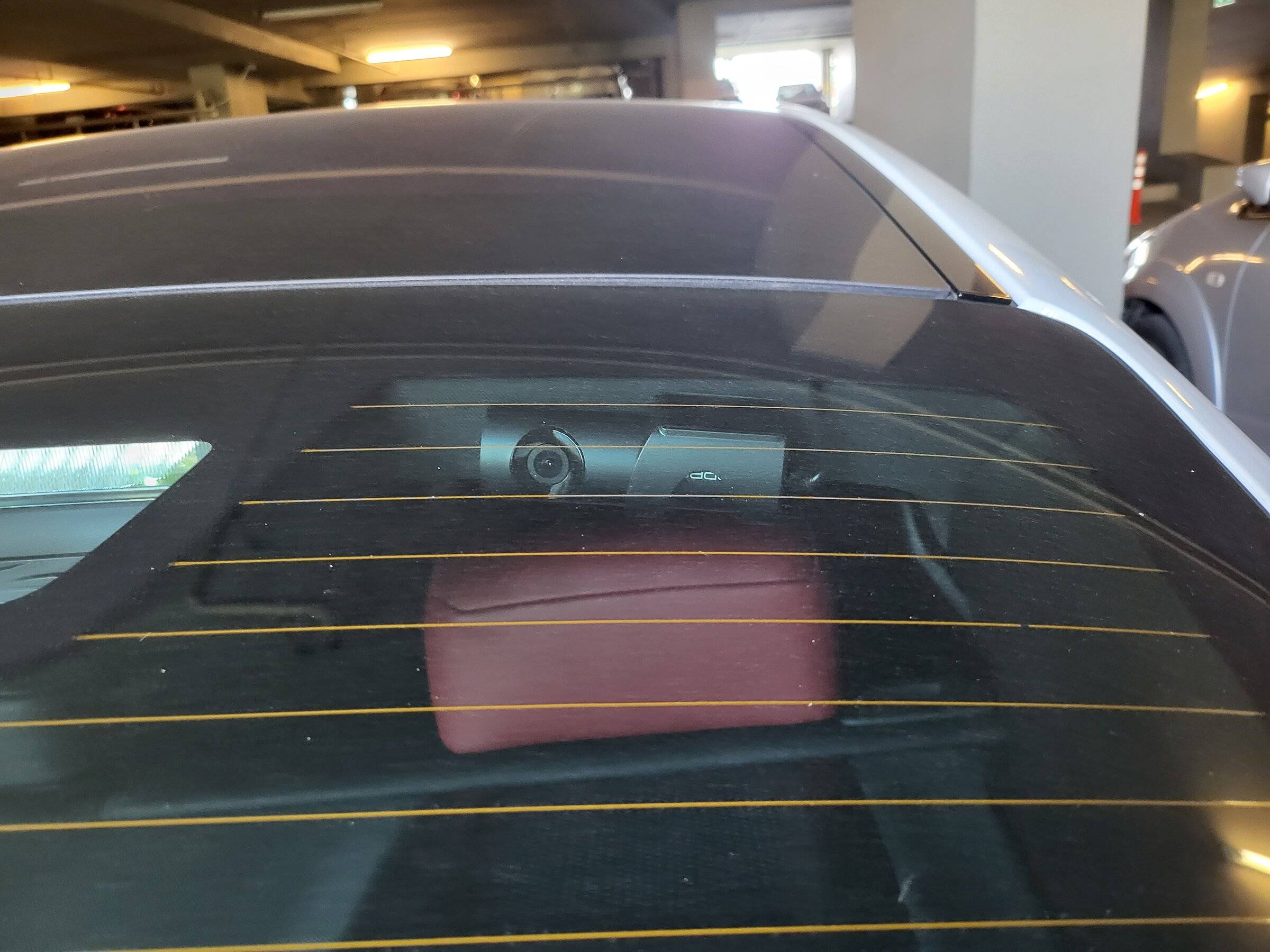

Or you could go with the Fitcamx for the front and get another cam for the rear. That's what I did. It makes wiring a lot easier, with no wire connecting front and rear. For the rear, you can just run the wire along the rear window rim and go under the rear speaker to reach the 12v socket in the trunk.
As a bonus, if you place the rear cam in the recess beside the 3rd brake light, you won't see it from the rear mirror!

In my setup, I actually use 2 separate cams to cover the front and rear, so there is NO connection between the 2. Each cam have their own storage and power supply. The front is Fitcamx 4k powered by the rain sensor and the rear is DDPai mini 3 powered by a 12v socket in the trunk. I choose the latter because of its low profile so that I can hide it in that recess.
The one FitcamX listed as Front + Rear will need a cable connecting both together and are powered by the rain sensor alone.
Hope this help.

I have currently installed a Blueskysea b1w on the rear screen. Used a cable tie to get cable behind plastic trim around rear screen then tucked under roof lining and edge of hatch rubber seal to power from 12v socket in rear of CT. I still need to work out how best to route a cable to the front camera ...
Job for another day
