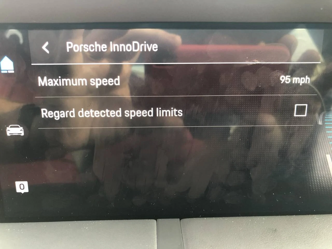

I got a solid 8-10 hours seat time in highway driving this weekend with Innodrive in full control of my vehicle for long periods of time. I can report that the option to disable/enable speed-limit adherence makes a world of difference in my personal satisfaction with Innodrive.
For those that are new to this - Innodrive adaptive cruise control will sometimes decelerate when it thinks you have changes speed-limit zones - you can be cooking along at 65 mph and suddently for no apparent reason Innodrive will set the max speed to 35 mph and aggressively slow the vehicle to the suprise and delight of the driver and the vehicle behind you that thinks you’ve just brake checked them in attempted insurancd scam - and then less than 1/4 mile father down the road the vehicle will return to it’s 65 mph setting…
well a week or so ago I found the following very interesting settings screen:
Porsche Taycan fixing Innodrive - a trip report D1BC00D0-06FA-43D1-8558-DEB55C9BB562
I can report my driving experience is vastly improved with “Regard detected speed limits” disabled - the vehicle never once adjusted speed without my permission and never brake checked the vehicle behind me.
If you’re having trouble with Innodrive automatic speed adjustments - I highly recomend you check out this setting and adjust it to your personal taste.

Can i ask if you had the Porsche native navigation switched on?
On my mercedes i find that it acts strangely if you dont have the route guidance switched on, for example if you are on a flyover and the speed above is 50 but below is 30, unless nav is on it would pick the slower speed
160
5,810
8,648
this weekend I used the sytem with the NAV on and off - same behiavor.

Great update. It looks in the manual like if you have "consider speed limits" deselected it still detects the speed limit but just asks if you want to change, rather than just doing it automatically.
That actually seems like a better system anyway, there are some roads where I always stick to the speed limit and some... where I have a more relaxed attitude :)
This very same "oopsy brake check" behavior was rampant in my former 2018 Panamera Turbo S e-Hybrid when InnoDrive was selected. It was a damn nuisance and a little bit dangerous. I fixed it in the Panamera using the same type setting as you point out.
'Twas easy for me to repeat disabling the Obey Speed Limits check box ..... before I took my first highway outing at 27 miles on the Odometer.
