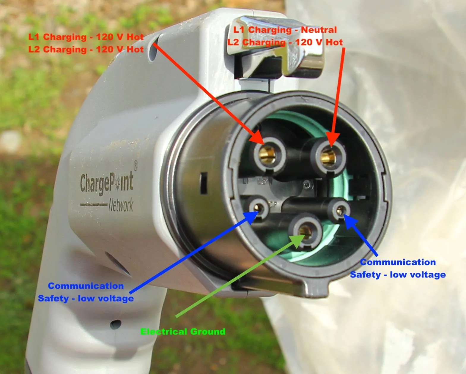

  1. there are _NO_ North American 22 kW EVSE (EV Chargers) - maximum EVSE is a 100 amp ClipperCreek, Porsche Wall Charger, Tesla Gen2 and a few others
    1. the Porsche Wall charger only supports 100 amp breaker settings (80 amp charge) 19.2 kW max L2 charge rate _IF_ the Taycan were to support 22 kW charger you'd think the PowerWall charger sold in Canada and North America would support 22 kW charging - but again the Internals of the Porsche Wall charger only support 3 electrical "feeds" - 2 120V AC "hots" and one electrical "ground" - and there is no dip-switch setting for 22 kW.
  2. there is no protocol support in J-1772 to report to the vehicle there is a 115/92 amp breaker
  3. the European connectors has AC power/hot connections for 3 leads
  4. the North American J-1772 connector only has electrical connections for 2 leads (2 hots) - see picture below - to support 3 phase 22 kW charging you'd need a 3rd L3 charging pin in the J-1772 connector - there is no such connector/pin.
Porsche Taycan 19.2 kW charging Retrofit cost in US - price breakdown SAE_J1772_7058855567
I see NO METHOD to support 22 kW charging for any Canadian/US/Mexico Taycan - the plug is physically incapable of supporting the 22 kW charge rate and the wire gauge is also to small for such a load.

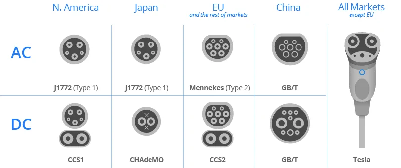

you'd have to have a European EVSE (the PMCC in Europe supports 22 kW) and the European charging port on your vehicle. Mennekes (Type2) listed below…3rd column - Canada vehicles come with the J1772 Type1 Connector same as US (1st column in the table below)
Porsche Taycan 19.2 kW charging Retrofit cost in US - price breakdown Charger-types
but yeah with a Eurospec EVSE and the Eurospec charging port 22 kW would probably work - not sure however about the vehicle software - not clear if there is a universal build for all Taycan's or if you'd have side load some eurospec Taycan software on the vehicle to support 22 kW charging or if it would "just" work…

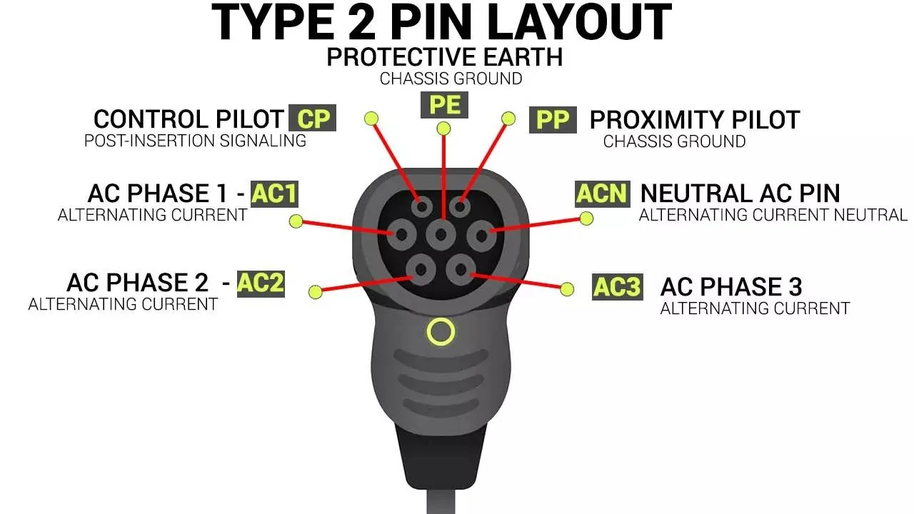

Here Is the pin diagram of the European EV connector - note the additional pin for the 3rd electrical phase…
the following PINs present in the European connector are missing from J-1772
  • AC3 for 3rd phase power
  • ACN Neutral AC PIN
22 kW charging requires these pins…and a different communcation/safety protocol run across the CP/PP communication pins.
Porsche Taycan 19.2 kW charging Retrofit cost in US - price breakdown xtype-2-pin-layout.jpg.pagespeed.ic.glMvVS4EmO
