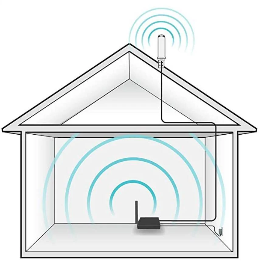

In the U.S., you can use a home "cell spot" to create cellular coverage in a dead spot using your home internet connection. (This is not to be confused with cellular hotspots which do the opposite by providing WiFi via a cellular connection.)
The AT&T micro-cell no longer an option, as 3G is gone. A cellular signal booster, like this:
https://www.amazon.com/SureCall-Fusion4Home-Signal-Booster-Carriers/dp/B01AWGY4TE
can be a good option, if you have cellular coverage outside of the garage. The principle is to have an antenna somewhere where there is coverage, and run a wire into the garage, like this:
Porsche Taycan Hard-wired internet connection? 1647687450497
Some day, if/when Porsche manages to build me a car, I will probably end up doing exactly this, so that I can connect to the car from the phone app while the car is in the garage. Today we only have Teslas, so I just installed an access point for them, but with Taycan, unless I end up hacking the Conn Box, a cellular repeater will be needed.

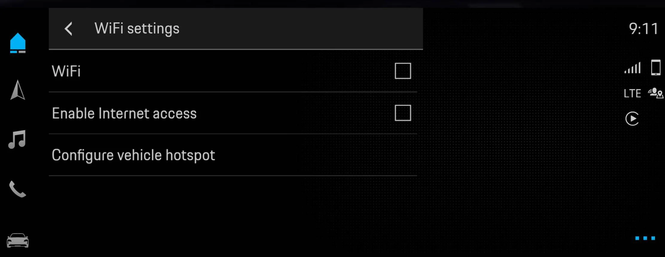

Not sure if this is the right place to ask, but here goes….
My iPhone shows that there is an internet connection with my Taycan when I get in the car. However, the phone will not accept e-mails or send/receive WhatsApp messages, nor will it go to websites.
I therefore have to turn the internet off to make it work on 4G. And then turn it back on when I leave the car.
Is this supposed to happen, or might I be doing something wrong ?

The car only offers a WiFi hotspot to share with devices but does not provide internet access UNLESS you paid extra for the monthly data package (don't do it!) - better to share your phone as a hotspot if you want that type of connectivity.
The in car hotspot also allows you to connect your mobile device to the PCM calendar for synchronization if you need to do this but that's all.
Separate to this is the car's own LTE connection used exclusively for Porsche / Porsche Connect data services.

Thanks for that. Bit of a nuisance then, eh ?
I never have the hotspot enabled in the car as it is useless in my case and sounds like you should do the same.
To disable go into the PCM and disable to avoid the faff you currently experience.

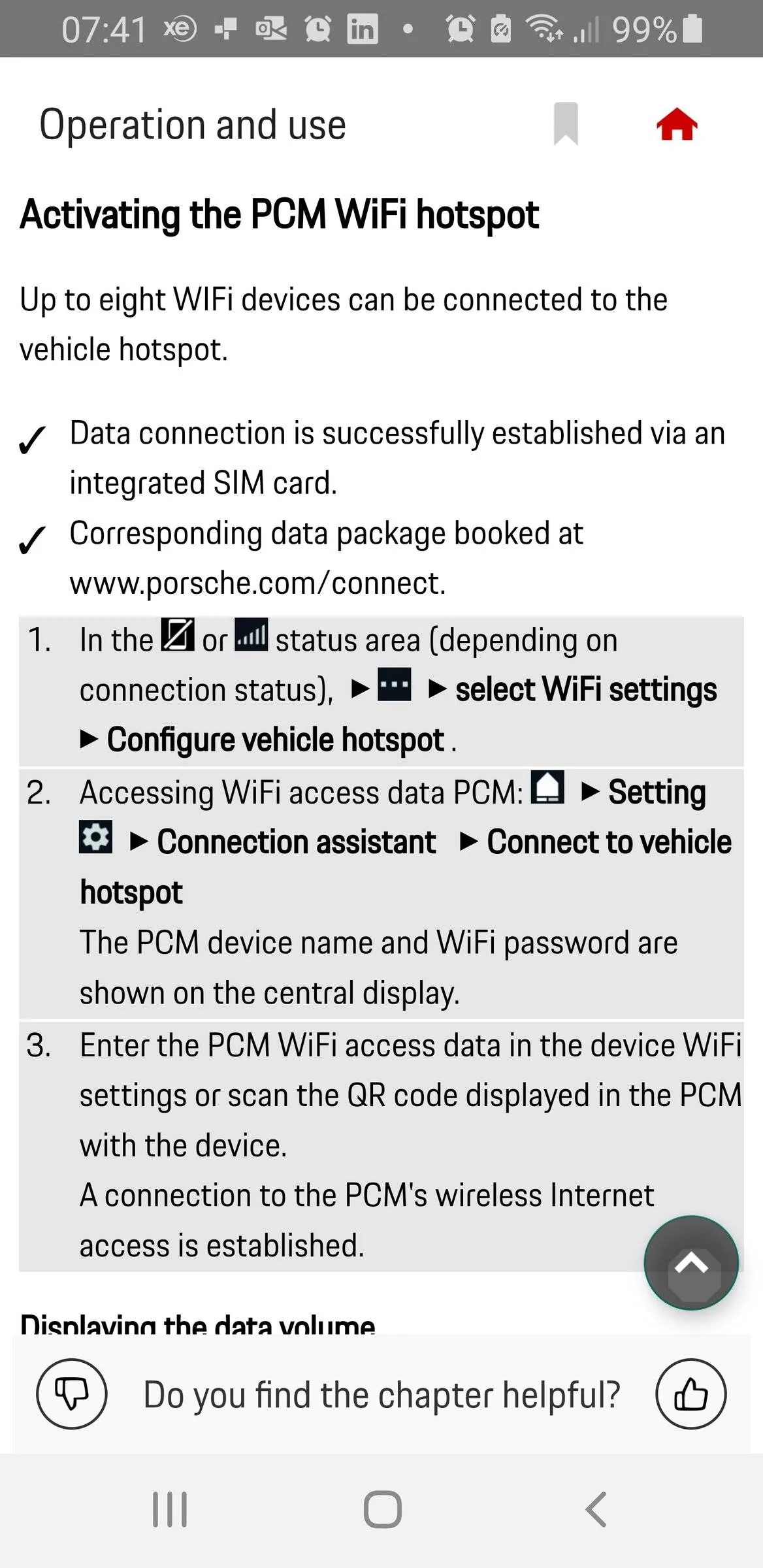

Porsche Good To Know App will help - page below talks through activation but you'll also see how to disable.
