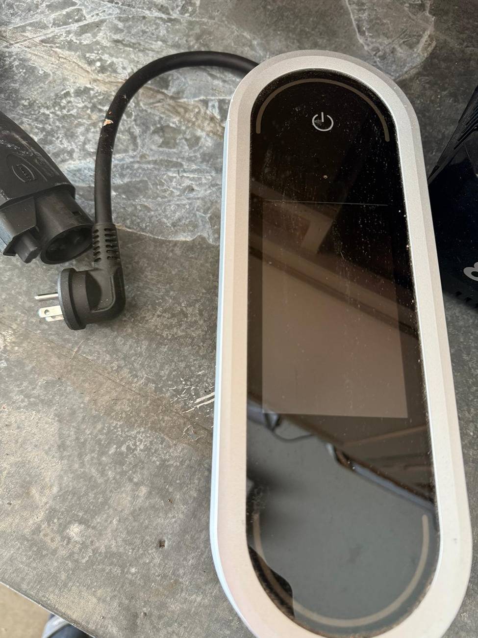

I appreciate this is going to sound like a very stupid question but here goes.
When I got my 2024 Taycan 4S a year ago I was told there was an issue with the charger cable which I assumed was the cable to connect the Porsche charger to a NEMA 14-XX outlet because the charger arrived with just the standard 110V plug. They also sent me an ENEL Juicebox which remains in its box because at the time it didn't bother me because my garage only had 110V circuits and I was going to upgrade the entire garage (take down to the studs and rebuild). Now the time has come and the garage rebuild will entail a full electrical update (my wife also has a PIH requiring L2 7.2KW).
I'd really like to use the Porsche charger for my Taycan and repurpose the Juicebox to my wife's car. Am I right in thinking that I need to replace the cable which currently is 110V plug with a NEMA plug cable and do I need to now try and get that from Porsche?. so, do I need a NEMA 14-50 circuit ?
Apologies if its a stupid question.

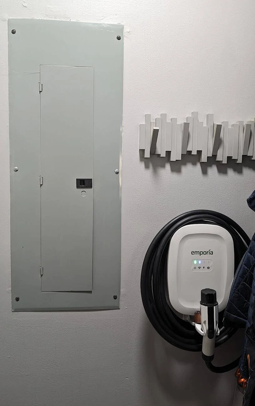

As mentioned by a well-known expert @daveo4EV above, make it simple.
- 110/120v charging at home is useless and only should be done in absolute emergency
- do not use anything Porsche branded and get yourself a 3rd party EVSE
- you are doing garage rebuild so make it hardwired with a 60Amp circuit
This is my hardwired setup with a 3rd party EVSE and 25ft cable reaching 2 cars.
Panel 60Amp -> invisible copper behind the wall -> 3rd Party EVSE -> Happy Porsche EV
this is _EXCELLENT_ advise I would make "one" minor change:
you are doing garage rebuild so make it hardwired with at least 60Amp circuit - more is also good up to and including 100 amps
apologies @SergeyIndy we normally are in complete agreement
if you're doing a garage rebuild - get a 100 amp sub panel - and then you can do specific/individual circuits for one or more EVSE's as needed.

@BigAndy1234, just listen to @daveo4EV, yes a 100Amp panel is ideal so you can charge 2 cars at the same time. My point was to demonstrate simplicity for a one car setup with at least a 60Amp circuit is a perfect correction.
If you currently only have the 120V pigtail but your Porsche charger has the recall, when you take it in the for the recall they will give you the 240V pigtail. At least, that's how it went down for me.
