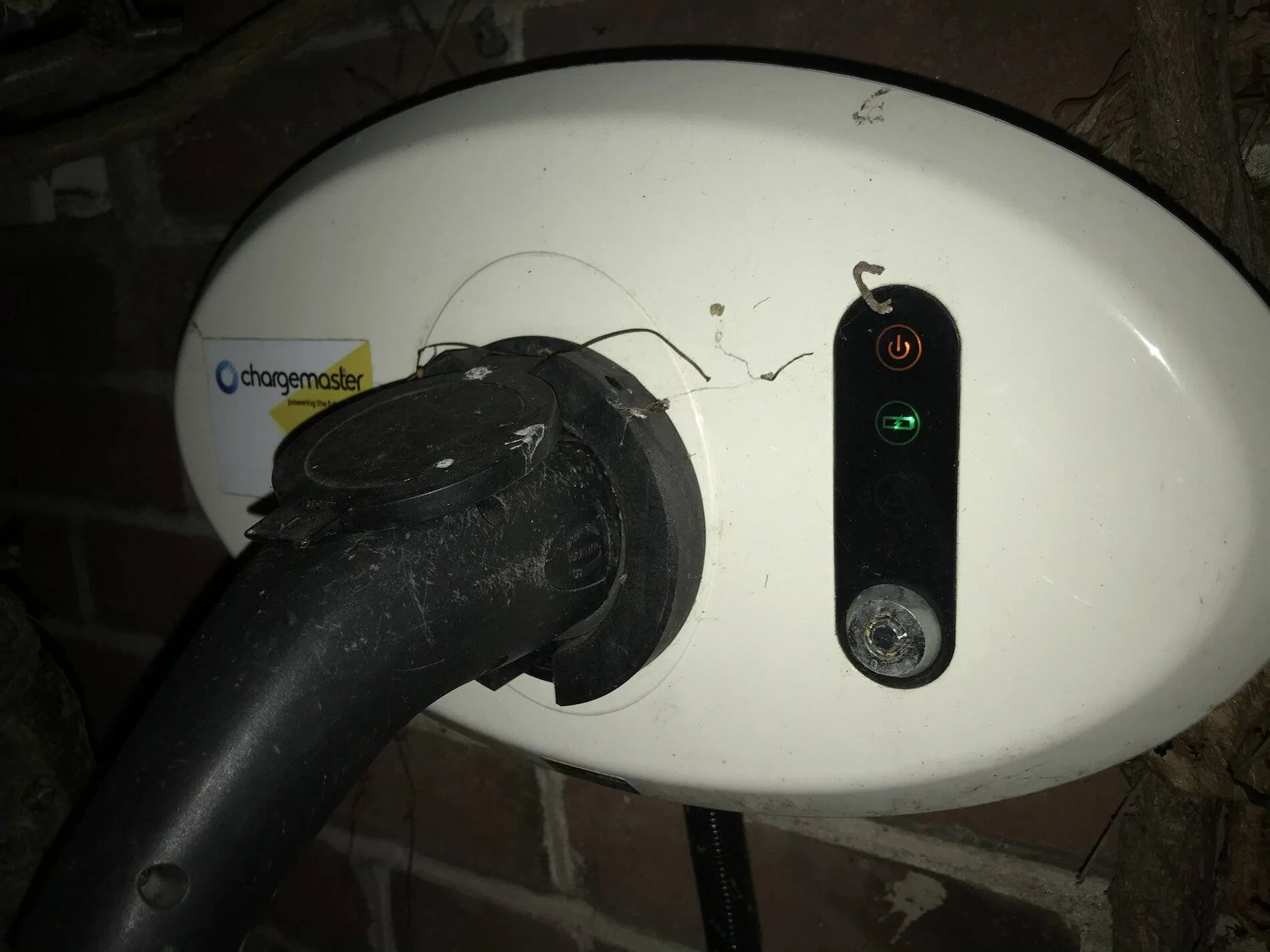

That looks like some kind of distributor/installer in the UK. Do you have the model number for the EVSE? Can you take a picture? Does it have a label on it?
Edit: it looks like It may also be an EVSE made by BP, but I can’t get the BP page to load...
Edit 2: page finally loaded, but not much help. I haven’t found any manuals online yet either. I did see a Wikipedia page for the BP Pulse that references the Chargemaster coming in 3.6kW and 7.2kW variants. It’s possible that there’s a dip switch or setting for this on the EVSE...or you may have the wrong unit...? Pictures? Labels?
Edit 3: I did find a forum talking about a setting for 16A vs 32A. May help.
https://www.speakev.com/threads/chargemaster-homecharge-installation-manual.151057/
Edit 4: Post #7 on that thread specifically calls out a jumper that, when removed, reduces output from 32A to 16A.

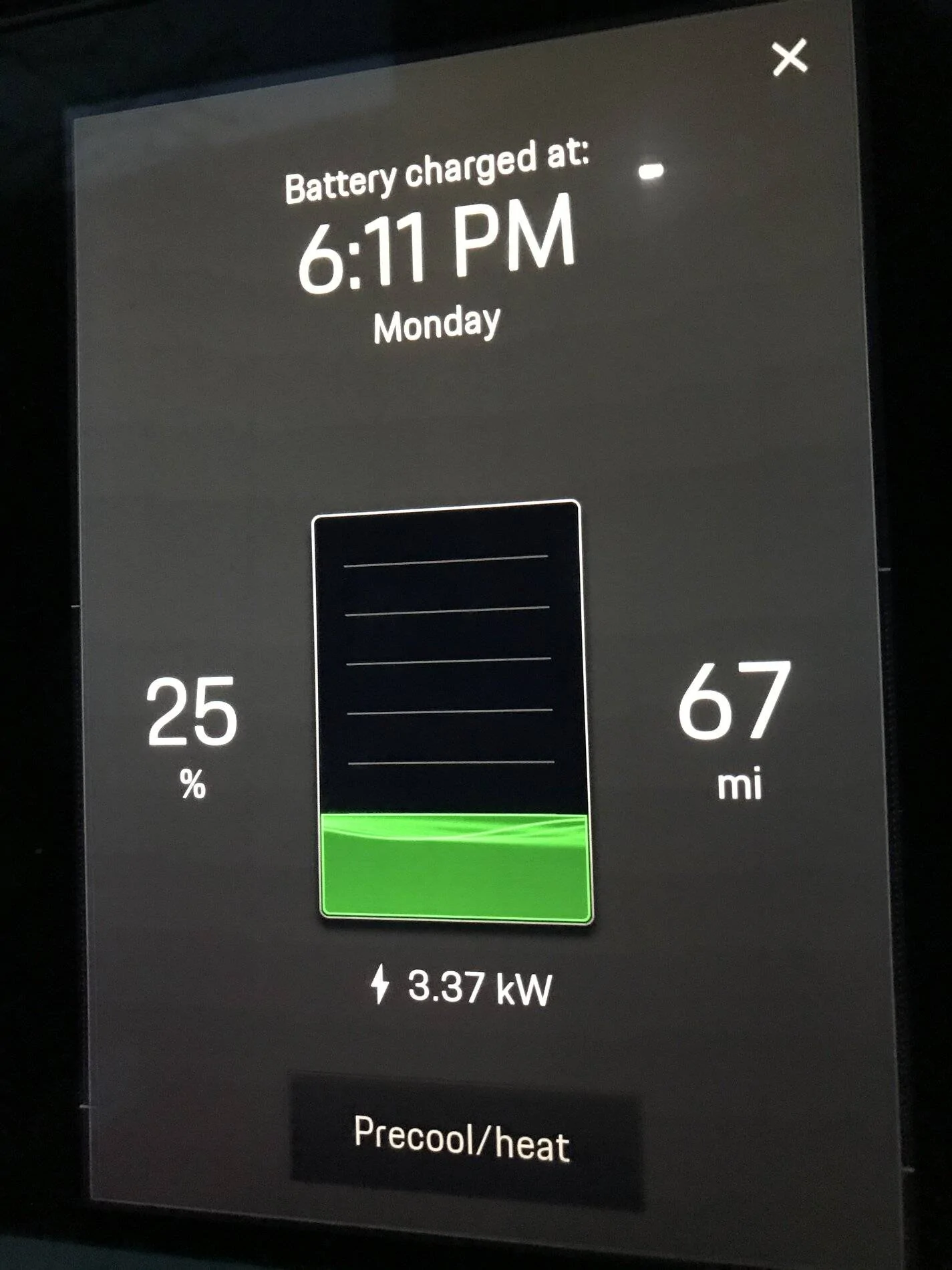

Thanks I’m still confused why it is so slow. Thanks for searching . Some pictures that may help?

My wife’s charger is one of these and she gets 7.2kw. I’m wondering if there is a dip switch inside that unit that you need to flick to get a higher output??
Power (kW) is the product of current and voltage. If your supply current is limited to half, the output power will be cut in half.
That thread I linked to talked about a jumper inside the unit that, when removed, would limit the current to 16 amps, (instead of the regular 32 amps). So, the first thing I would do is open the unit and check for that jumper.
But you also have to be careful that the breaker it’s running off of is large enough to handle the increased current.
It’s probably best to just have a licensed electrician come look at it for you.
Edit: I’m going to stress getting an electrician to look at it for you. Electricity is no joke.

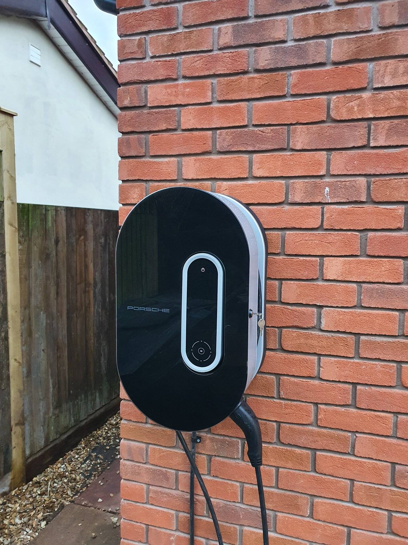

It is 11 kwh. 3 phase is 22kwh.
Mobile conector with 32Amp socket if fine for that. I added the extra housing.
Porsche Taycan Home charging in the UK 20201020_080102
Hmmm interesting. Yes I’m sure it says up to 11kw on the web. At the moment I’m thinking I might start with a 32a commando socket for the mobile connect and decide on a fixed charge point in due course. As you say I’ll have to remember to take it with me if I might need it when away from home though. Cheers
