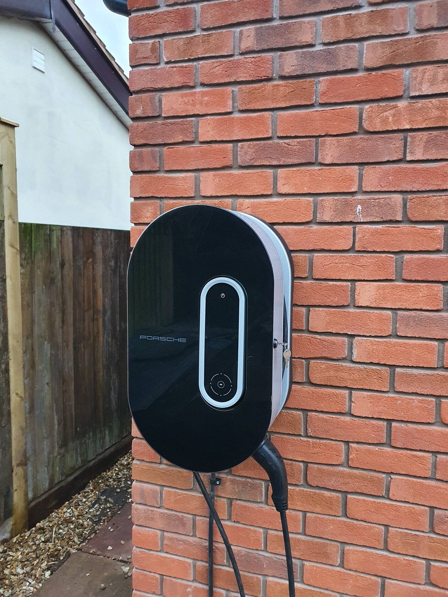

One of these. It doesn't have to be a taycan one. As long as it does 7khw its as good as the taycan unit.
What’s the blue socket mean/ do?
When you say bought used, do you mean just the cabinet? Don’t think I’d need the cabinet, thinking I will just mount the unit on the cart lodge Inner front pillar. What length lead do you have?
Porsche Taycan Home charging in the UK 20201020_080102
