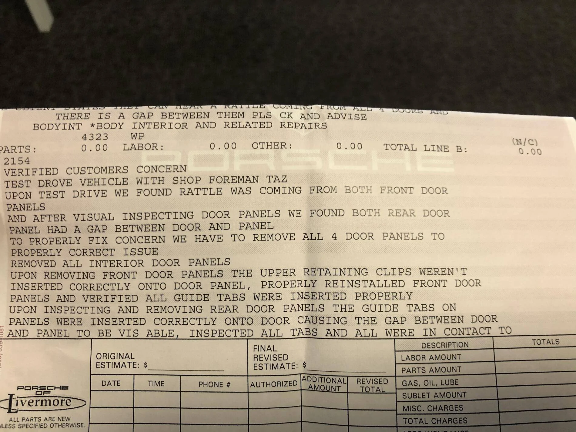

I just came back from the dealer the rattles was driving me nuts. This what they did
Porsche Taycan How I fixed the door rattles tempImageqrBkc7

I just came back from the dealer the rattles was driving me nuts. They what they did
Did it fix your rattles? Can you also circle back after a month?
Usually removing and installing the door panels fixes the issue temporarily but it comes back because the gap is still there by design (i.e. it is a bad design).

Sure, I can check in a month and see. I'm not sure if they placed some foam inside the panel, despite they didn't mention as such in the report. I would assume they can't put it in writing, as foaming is not porsche standard approach. Could be also the clips as they re-inserted them right.
Who knows!!

Sure, I can check in in a month and see. I'm not sure if they placed some foam inside the panel, despite they didn't mention as such in the report. I would assume they can't put it in writing, as foaming is not porsche standard approach. Could be also the clips as they re-inserted them right.
Who knows!!
Your dealer certainly did a better job. Mine just touched the passenger door and ignored the others. Btw, they wrote in my service order that they added foam so it is up to Porsche's standards :p

Quick update 2 weeks later after they fixed the rattle. The rattle is better 80% but not 100%. Therefore, I duct taped all wire tubes which goes to the 4 doors. The reason was they rattle on bumps, and once I move them up / down, I can hear the rattle noise. Hopefully this could fix the issue permanently
