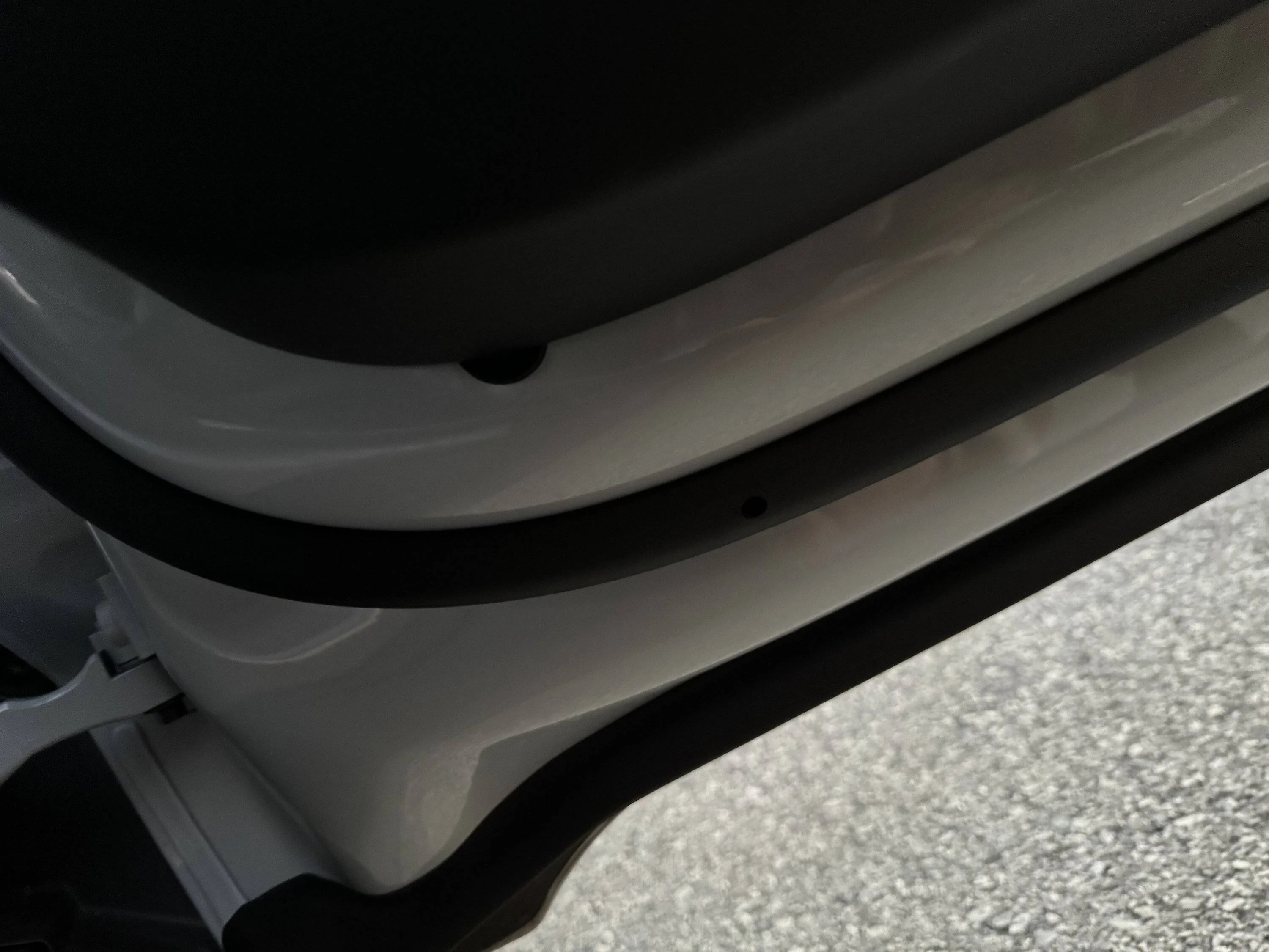

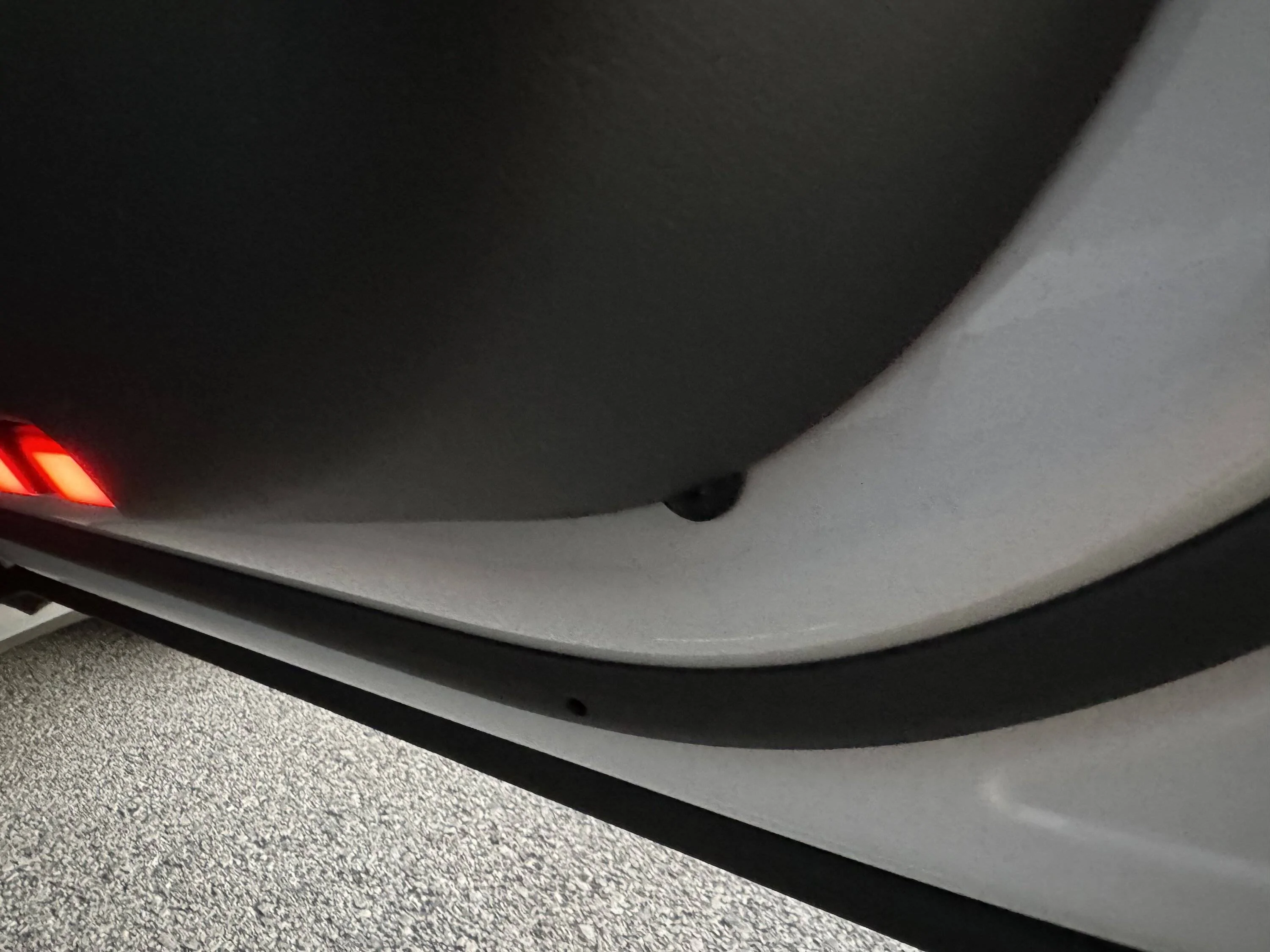

My Taycan 4S MY 24 had passenger door rattle since day 1 of collecting (dec 1 2023)
Thank to this thread I put 2 little rubber shims that you can see in the attached photos.
They are like 2 mm thick and given that thickness they don't put much pressure or tension between frame and card but seems to be enough to stop rattles.
I'm not in love with this kind of solution since I think that Porsches has to be rattle free, but it works.
I only hope that my 2 shims do not slip in or out.
I don't know either if it would be better to bring the car to the dealer in order to find a better solution, but I am afraid they would make things worse... what do you suggest?

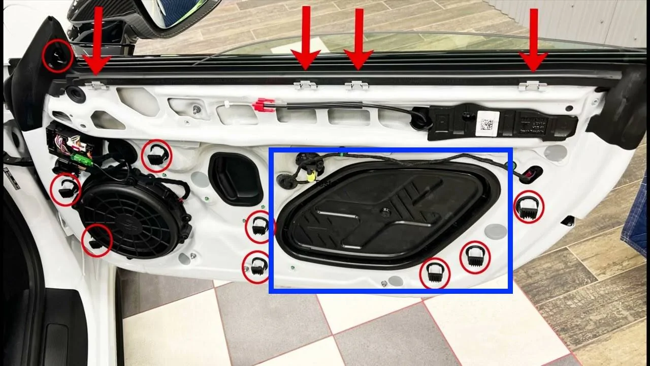

IMPORTANT UPDATE
Te root cause of the rattle is NOT the door panel.
I removed the passenger side door trim chasing rattles and vibrations.
Te door rattled even without panel, so I also removed the black cover in the door frame and noticed 2 grey hard plastic cables (the ones for the window) rattling against metal frame.
I secured the cables with a little tie and put sole felt on the metal in the position of the contact.
Reassembled door trim and FINALLY all is quiet as it should be, even without the shims between trim and panel
I attach a picture of a 992 door just as an example. You have to secure the cables behind the black part circled in blue.
Hope it is useful

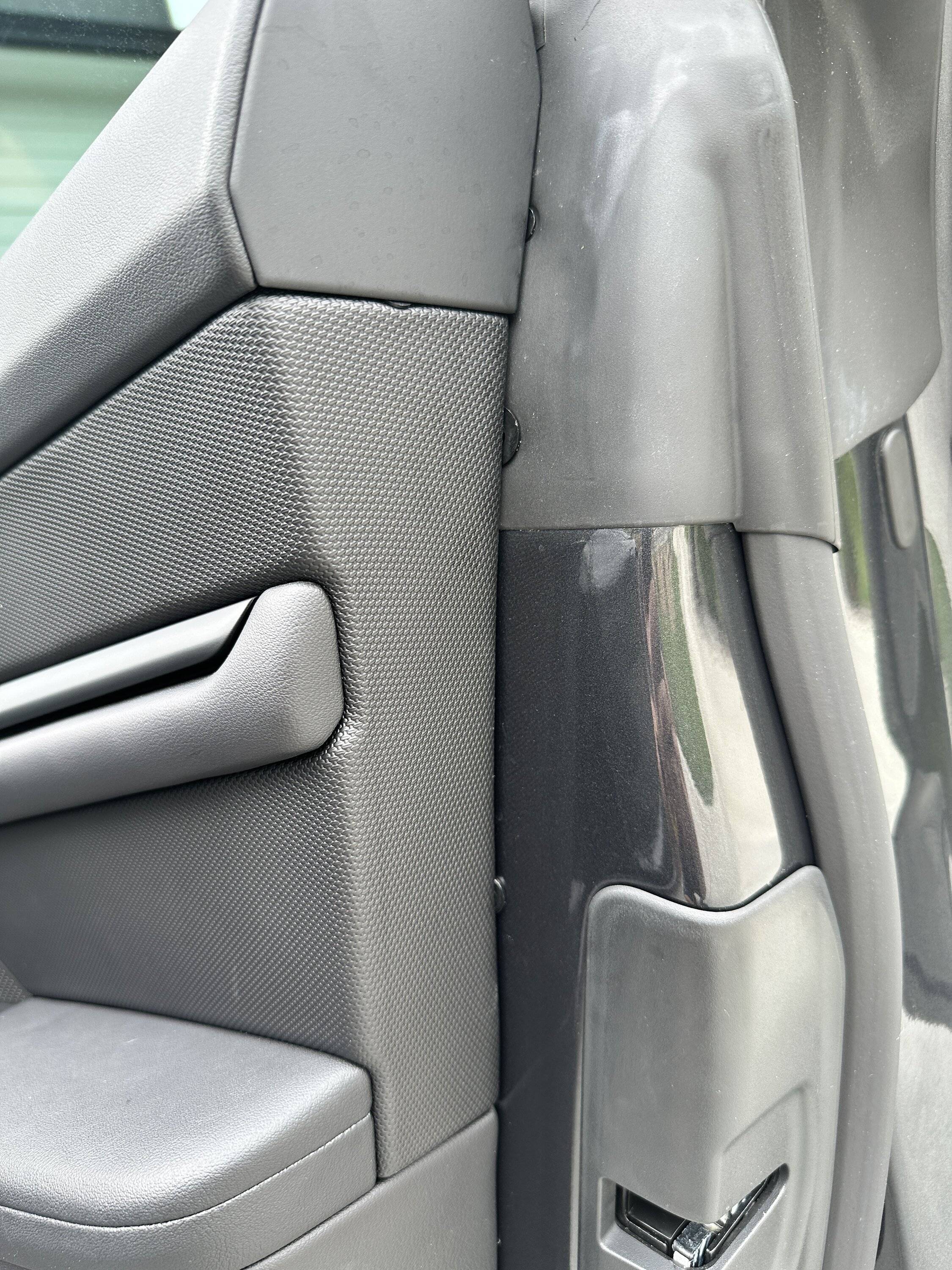

4+ years later, mine also developed a rattle in the upper side of the passenger door.
Something rattles when going over bumps / playing music even at low volumes inside the door panel. When even slightly pressed, it stops.
