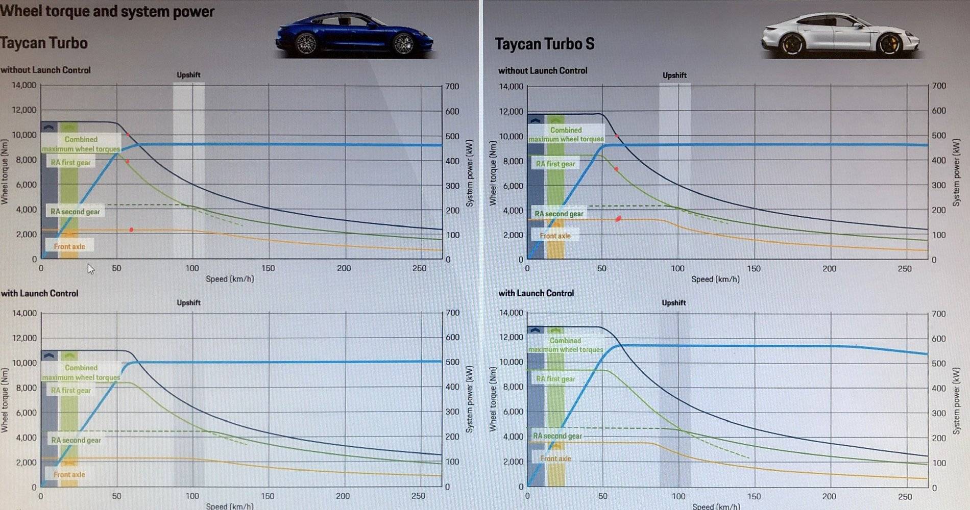

If an engineer came for a job interview his first question was always “which is important torque or power?”
a good engineer would answer: wheel torque is most important because it directly correlates to vehicle accelleration. :)
(getting true motor HP on a roll dyno is only possible if you know motor's rpm, know rotational inertia of gearboxes, axes, wheels and you need to be able to put all this in "neutral" and add the drag power of the system)

I'm sorry, but you simply forgot the gears in your equation (only mentioning engine and chassis above).
What I don't say: power is unimportant, it's of course the main driver in the equation, but it's a bit more complex.
At the end for an optimum acceleration you want to maximize the area under the wheel tourque diagram.
also Porsche knows it :)
https://www.taycanforum.com/forum/t...n-not-using-launch-overboost.1735/#post-22400
Porsche Taycan How much HP does a Turbo S REALLY have? Dyno Run Video e91536d4-6c6b-4d3b-9ef8-907fba19534c-jpe
