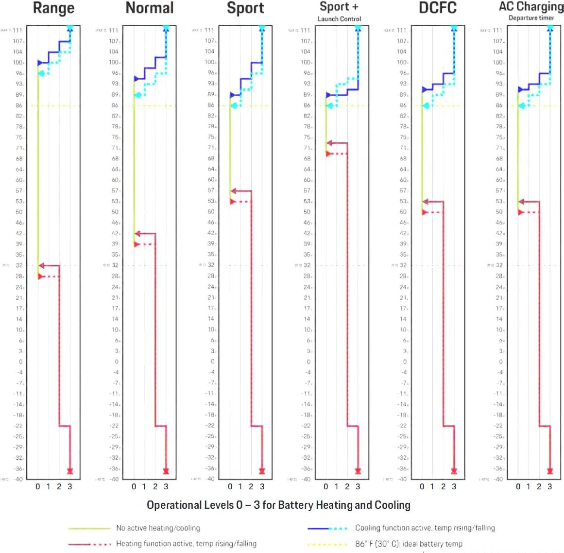

If you have sport chrono, you can put it in sport+ mode and the battery heating will target a higher temp (73F). Not quite the ideal 86F for max charging power but combined with some driving it'll likely get up to that temp much faster.
Porsche Taycan How to get battery to preheat for charger not recognised by Porsche nav EA9958D9-C4F0-47BD-B9A6-237059631B55
