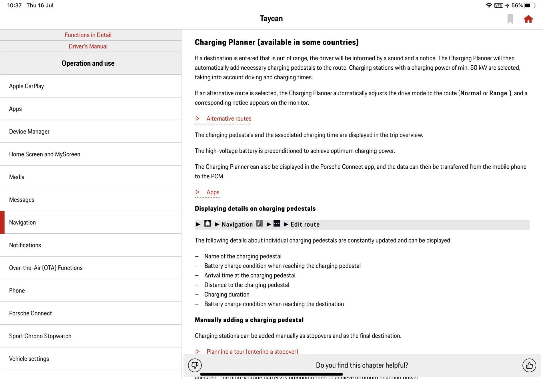

Do we know what the ideal temperature is before we rapid charge above 50Kw?
3,089
2,690
I can not find anything that says more than a general “optimal temperature”! But what that is I can not find. See screen shot of Good to Know app??
Porsche Taycan How turn on pre cool before charging? 9B5EBF4C-853D-4BBC-8E2F-9FF037A47FE9

Looks like 25c is the sweet spot. Or maybe its 50c. Big difference there. Unless I'm misunderstanding something.
3,089
2,690
I took from the charts that minimum 25 C and sweet spot 30 C, to achieve max charge rates and fastest charging.
But then the question on how you get that? Charging Planner when it works seem to do it but else?
