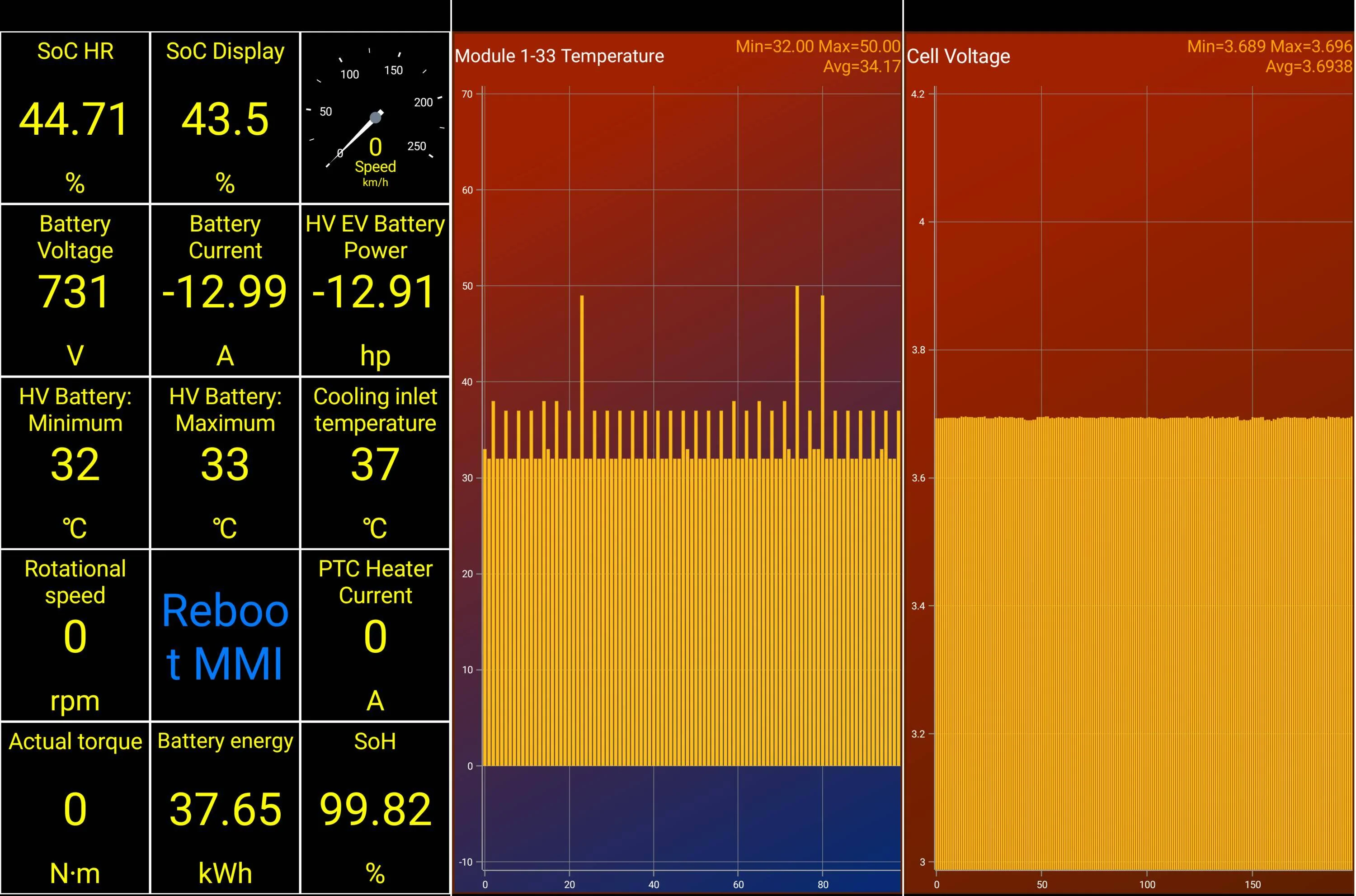

After the battery died, the SoH was 93.6%. This always seemed to me a bit low considering my climate, charging and use profile.
Porsche Taycan HV Battery trouble? 1683375631249
Today I used the battery scanner app. Interestingly enough, the SoC is much much higher at 99.8%! This is suspiciously high, after all only one module was replaced.
I am charging full tonight. Need to see how much kWh went in and what the expected range will be.
If battery is like new, maybe I hang on to the car for a little longer...

As per previous post, even if refurbished, seems to work well so far. It also would make sense, since it was fixed on warranty, and Porsche has a profit target...
