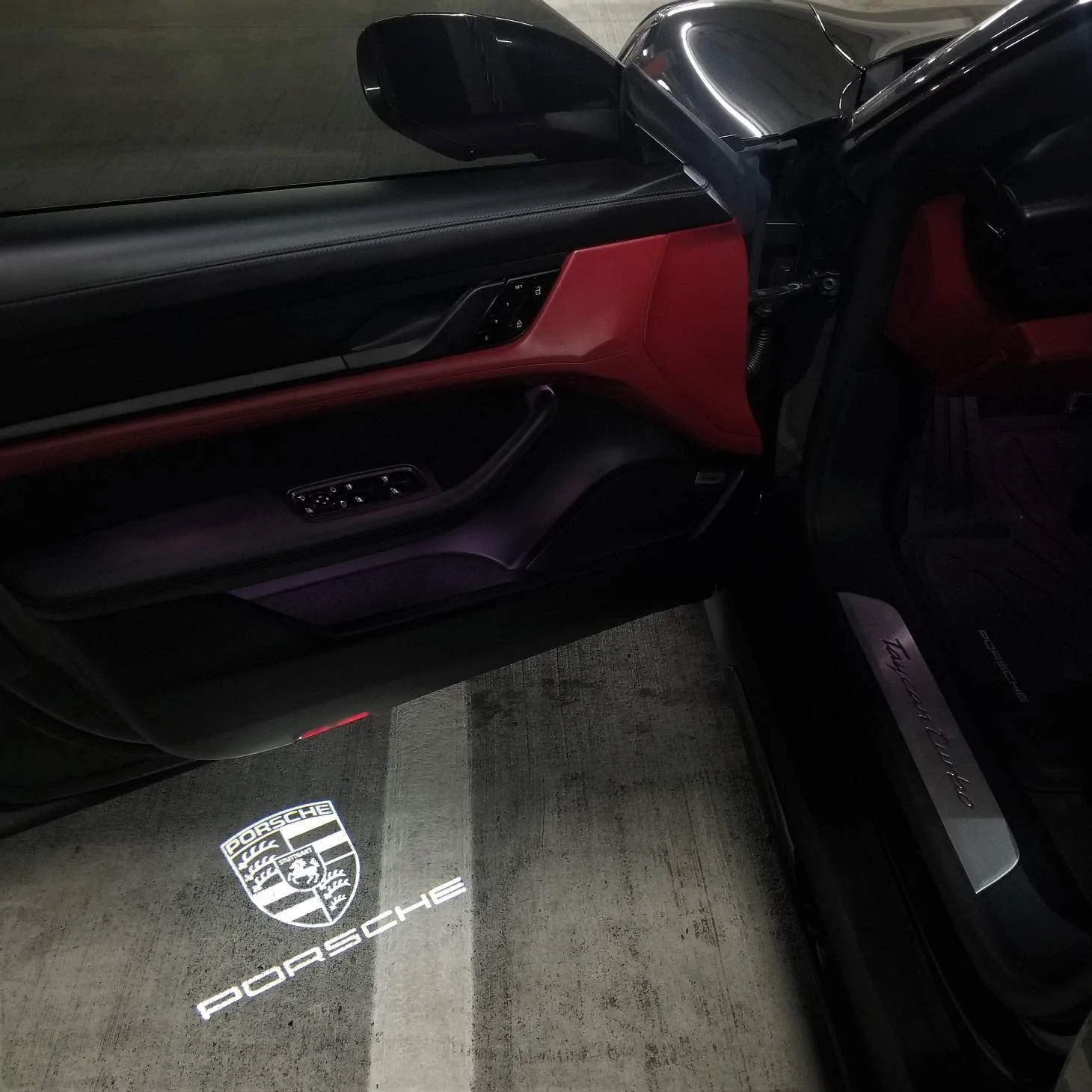

I also purchased these from a Chinese website. Cost about $80 USD for all 4. Very easy to install, took 5 min tops. No idea how these compare to the OEM ones but for that amount of money I don't really care haha
I‘m just scared these could burn or something ?.

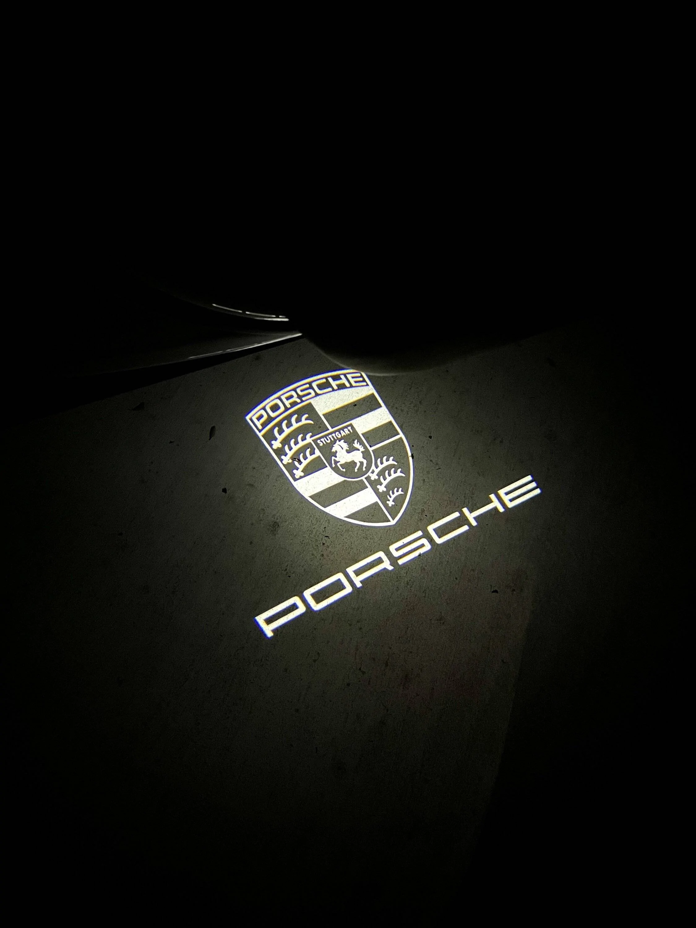

Just installed my puddle lights this afternoon. Took all of 3 minutes to do both sides. Used a plastic trim tool to be safe. Light popped right out, unclip both sides of the wiring harness and install new light. I got mine from…https://www.addcarlights.com/product/porsche-logo-door-lights/
Model D, Style A. If you use “newuser15” it gives you 15% off so price drops from $56.99 to $48.45 and free shipping. Takes about 2-3 weeks for delivery. Looks great. Me gives 13/10 for coolness and value. Also adds 6 HP.

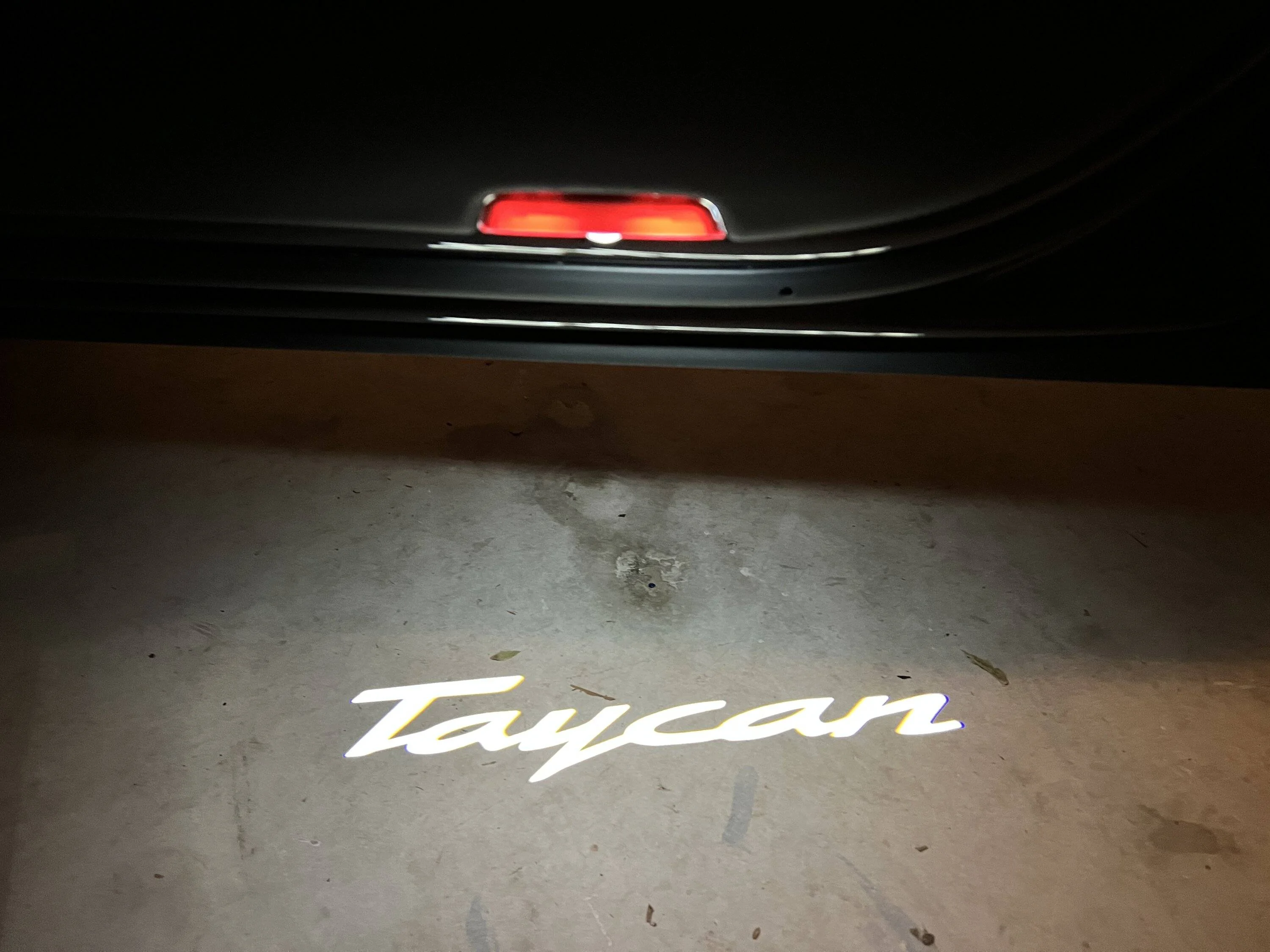

Another successful installation of the PimpMyEV custom puddle lamps. Followed these instructions from @PDACPA. Couldn't be easier and is so much better than Porsche's OEM lights. There is a little bit of light bleed around the lamp, but not significant at all.
Porsche Taycan Installed puddle lights “Taycan” IMG_5496
Did you have to adjust the ones for the rear doors? I installed mine but the rear ones didn’t project correctly, as the door panel is actually blocking some of the lights. The seller had me adjust the little disc inside the projector which seems to help.

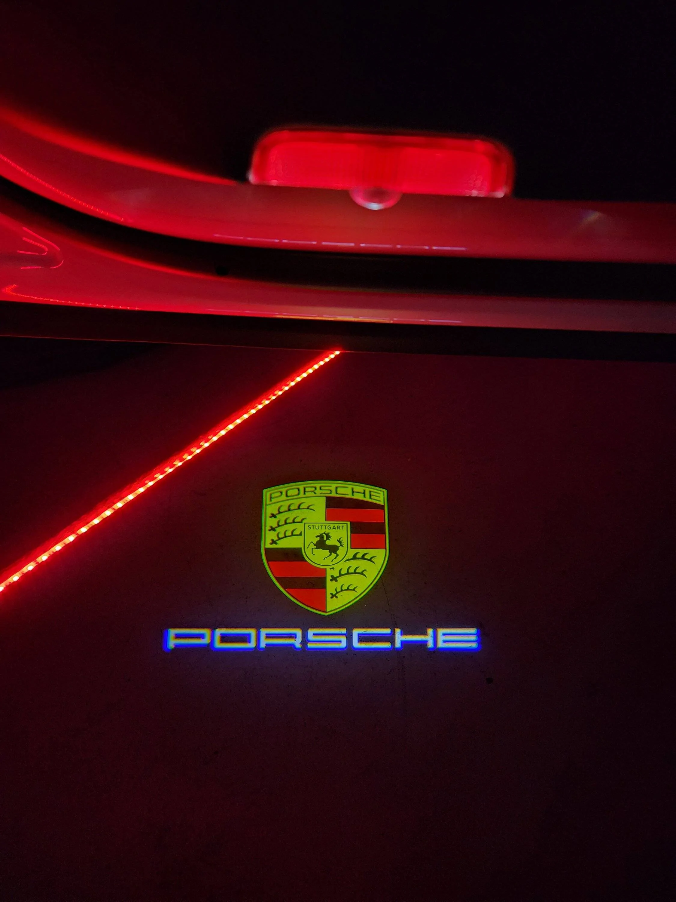

Ok I've been thru all sorts of Puddle lights for my cars. The biggest problem with Puddle lights are the bulbs. If they duplicate the bulb that the Factory puts in it simple cooks the piece of film that has your logo.
I went thru 3 different sets of Puddle lights on my Scat Pack Charger. They were using a similar bulb that the Factory uses. Runs way too hot for the film with the logo on it.
What fixed it was I found a Company that uses LED Light bulb vrs the factory one. They usually call it the No Fade Puddle Lights. They basically will last forever because the LED'S do not get Hot like the Factory bulbs.
So keys words to look for are No Fade and Lifetime LED'S.
This is the ones I have in PCASSOO.
Good Luck
Porsche Taycan Installed puddle lights “Taycan” 20230102_055840
