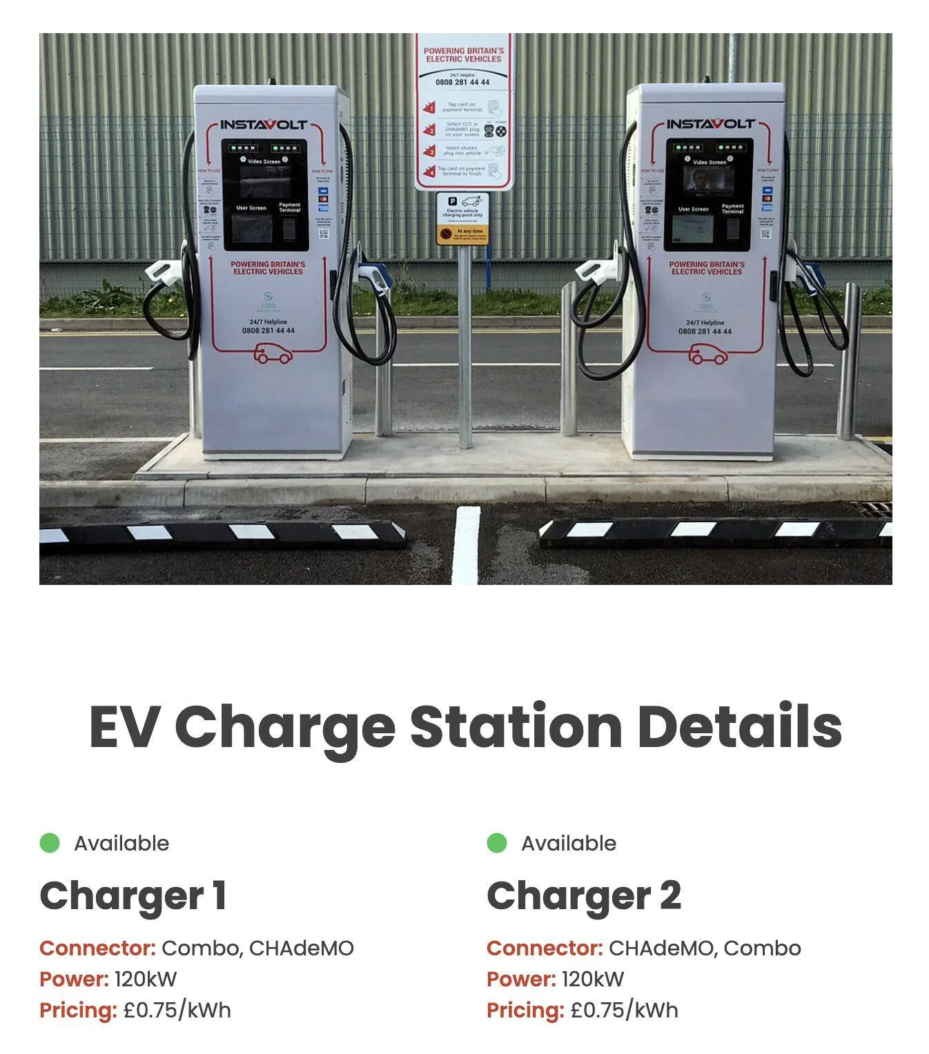

Instavolt 120kw 400v chargers

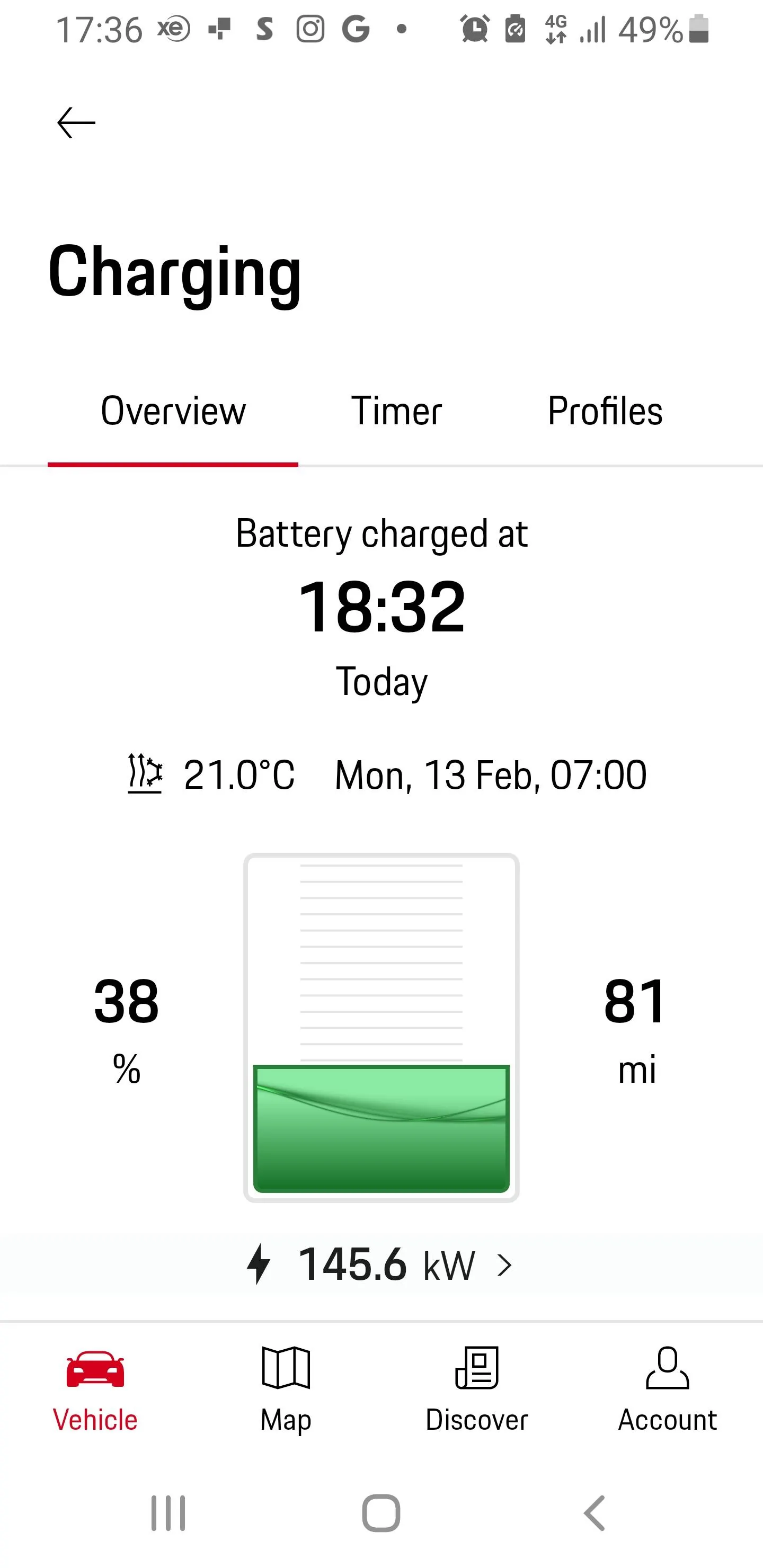

@CrossTComingSoon could you name one of the specific sites where you experienced high speeds? then we can deduce that all other units like that are in fact 800v and not 400v as I thought.
Oct 16, 2021
Herts
Taycan Turbo CT MY22

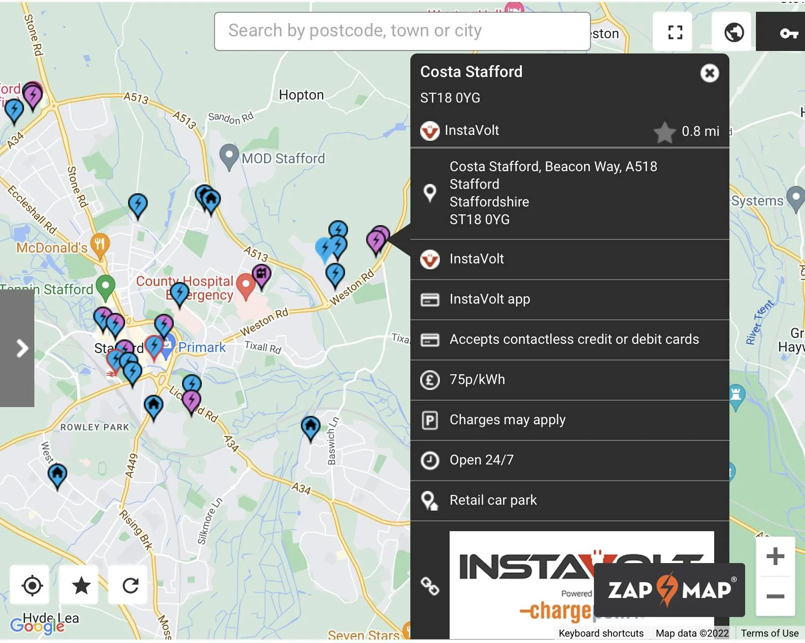

Sure. It's near Stafford Ionity (which was a shxt show yesterday evening). The irony of getting full 115kw charge from this empty charger Vs waiting in a queue for likely 90kw from the Ionity.
I didn't even know the 125kw chargers might only go at 50kw if wrong voltage.

Thanks! So to summarise, these 120kw units that @CrossTComingSoon and I were using must be 800v, so all Taycans should be able to benefit from the full speed (assuming other factors favourable).
Porsche Taycan Instavolt 120kw 400v chargers 1672356995638
I'll try some more Instavolts and see how that goes, this time with warm battery and hopefully no other cars charging at the same time.

*** Update ***
Used a BP Pulse 150kW EVSE today - 400v - DC booster worked a treat to give me 149kW - 5 mins voltmamd bolt tomadd 35 miles. Perfect!
This is a newly.commissioned EVSE and so 400v is alive and well.
