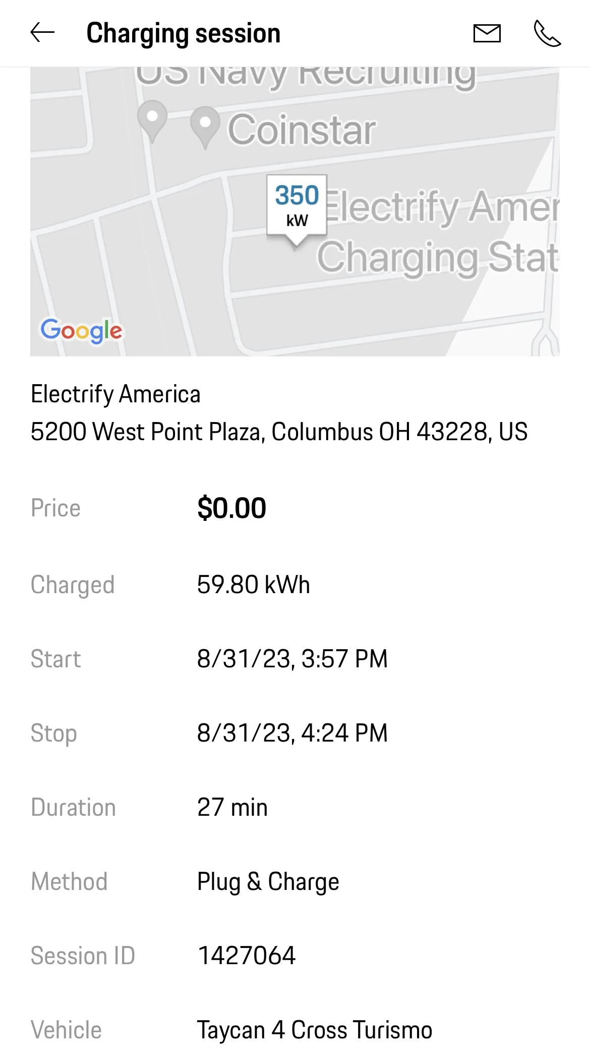

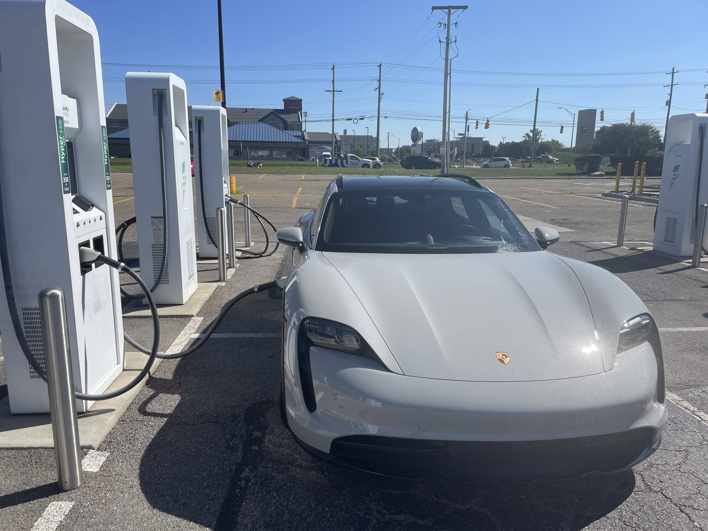

If the plug and charge does not work, start the charging from the Porsche app and then plug it in
plug in first then start the charge via app
sometimes it’s free and all you need to do is plug in
this mirrors the instructions at the station
