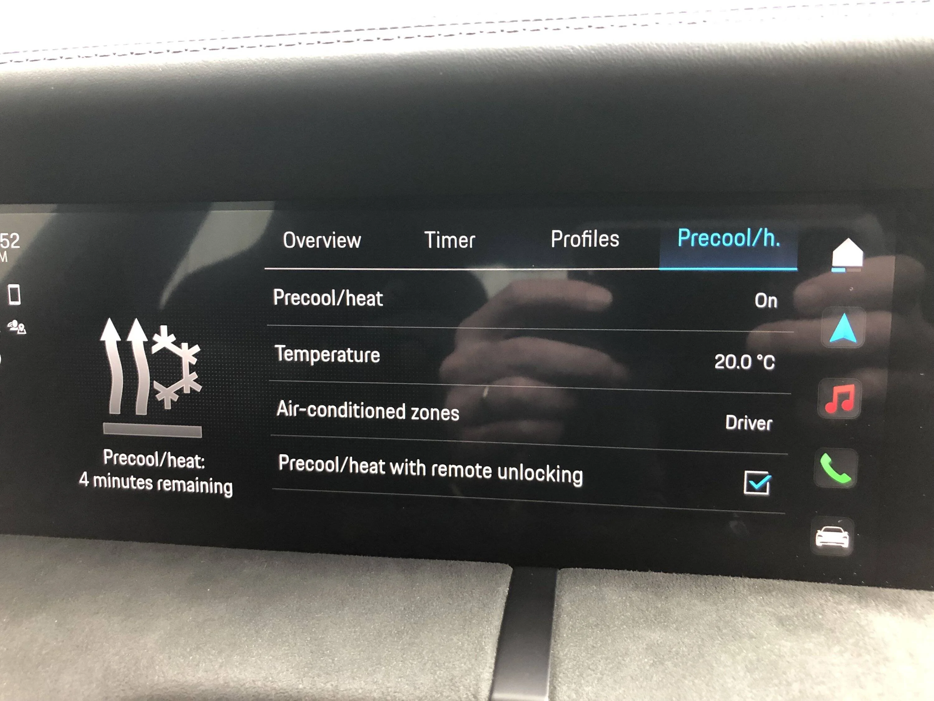

What's the 5mins preheat setting and where do I find it - in the app or PCM?
Go to Charging
Then Preheat/cool page
Tick the box
You get 5 mins conditioning.
Porsche Taycan Is preheat killing my range or is this normal? IMG_4510
As you can see bottom left. By the time I had faffed about getting the right page in the display to photograph just now there were
4 minutes remaining.
