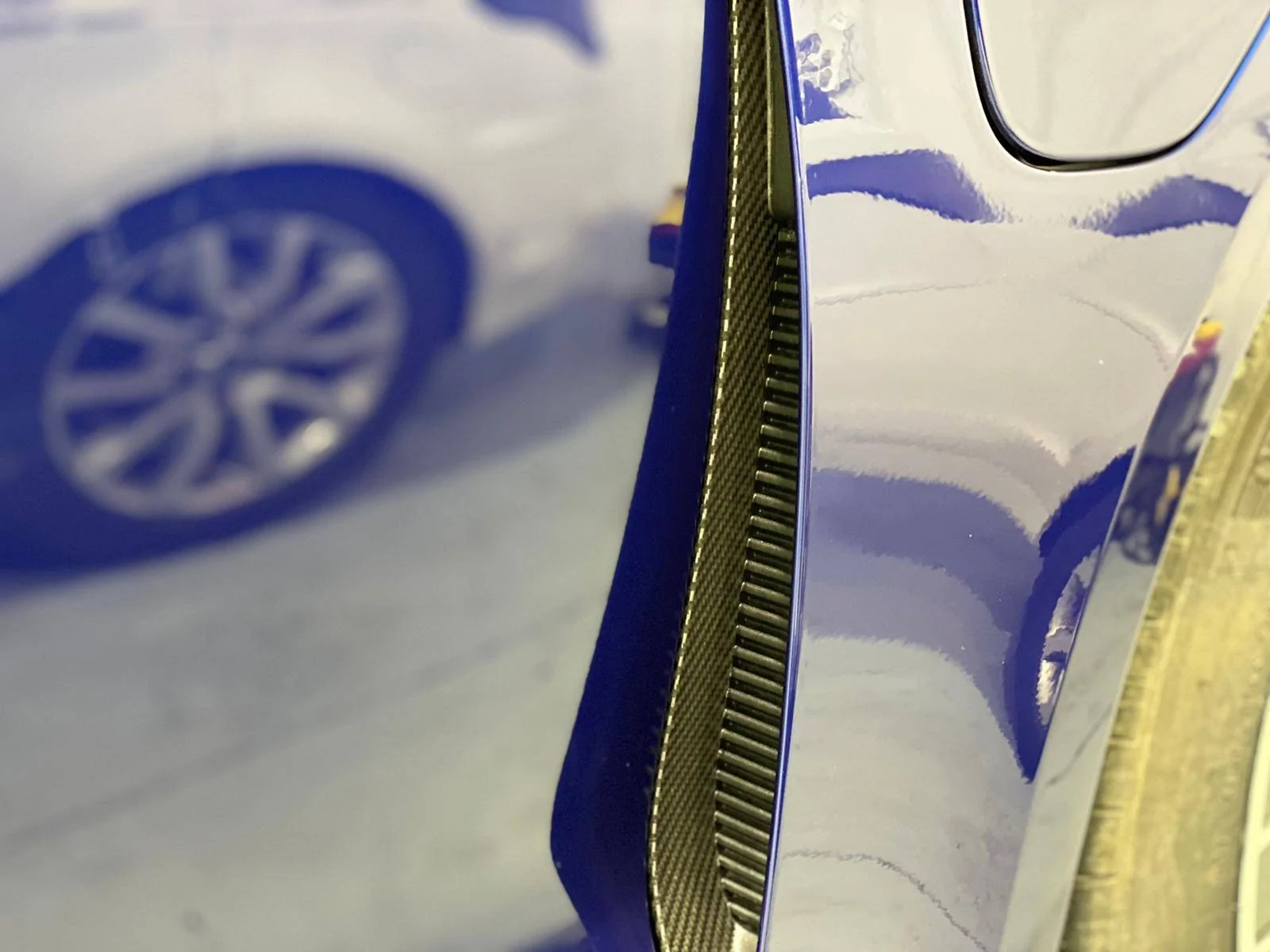

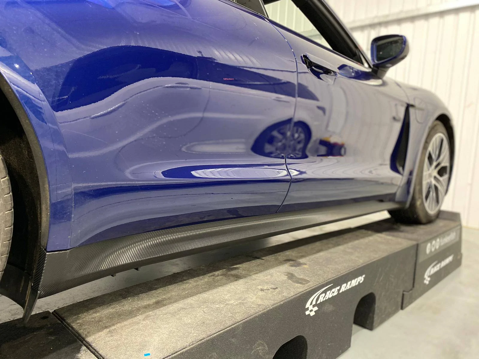

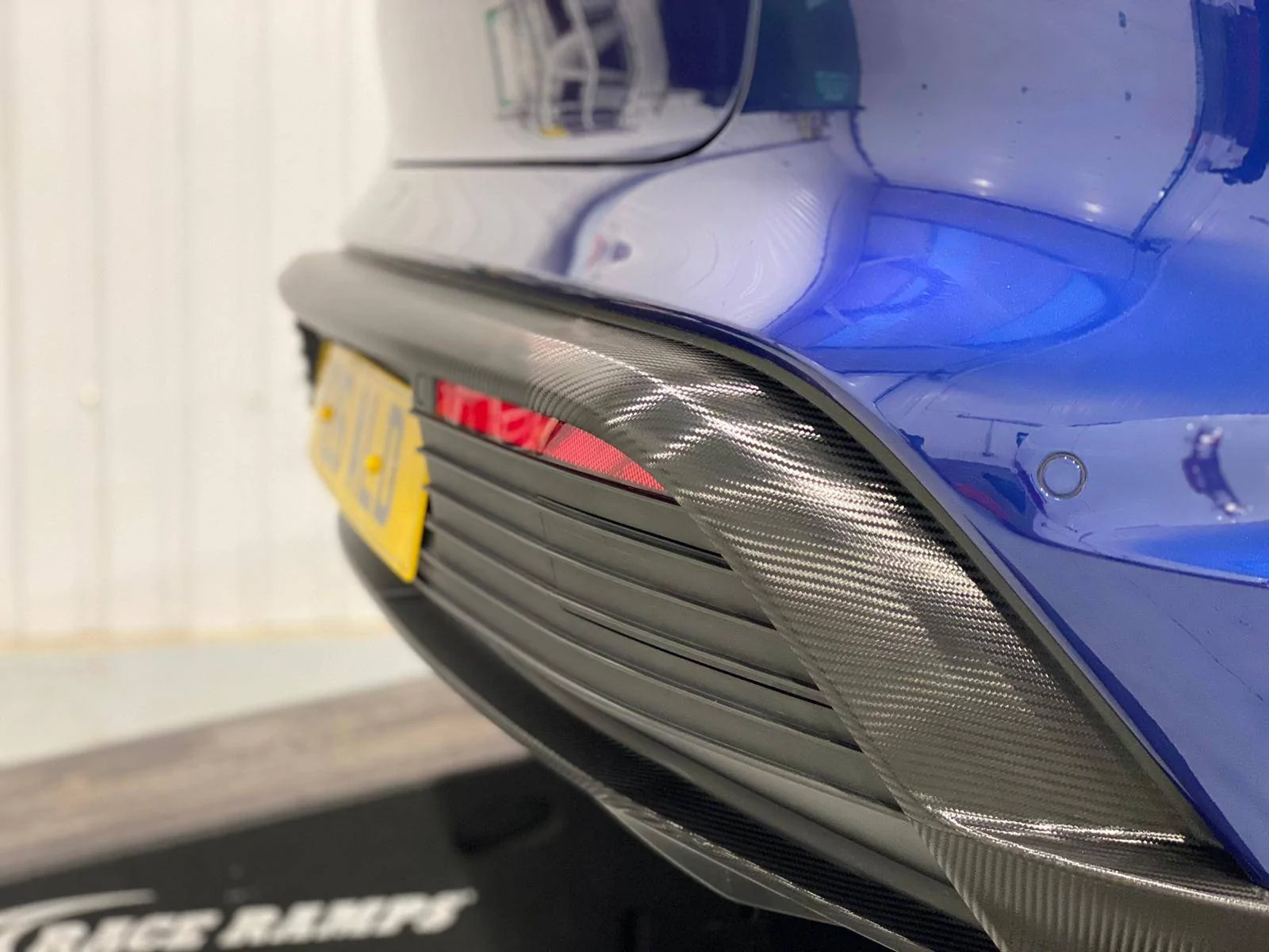

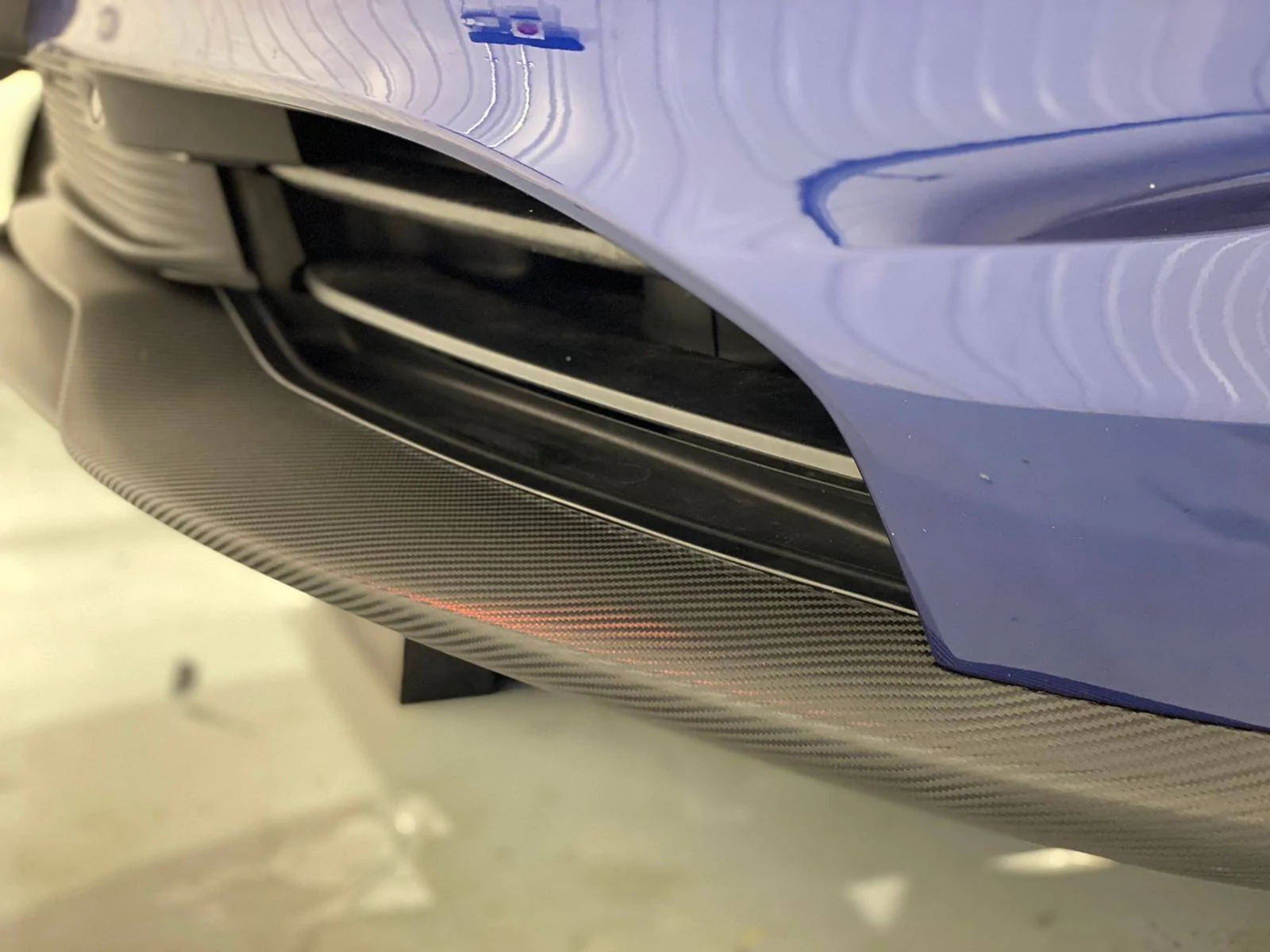

I was told the same BUT these guys work for my local Ferrari / Porsche centre so I trusted them with it tbh. Thought about spraying it but really wanted the carbon effect and is exactly what I wanted.
It was £850 + VAT

Looking really nice! ??
Would be nice to know if they have done anything to the plastic before wrapping it?
If not, I’m really interested in hearing how it holds up.

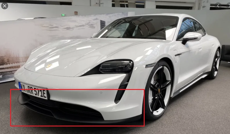

Hi,
I spoke to a part-time car wrapper today about a few places I’d like to add a carbon fibre wrap to and he said with his experience on a 4S that the front bumper material wouldn’t allow film to stick. He had previously tried with PPF but it’s just not adhesive enough.
He did say that I could use some plastic adhesive, but it would leave marks in the future when I come to remove the wrap.
I notice the turbo has a slightly different bumper shape that’s already painted. Which is why some people frequently wrap it.
Therefore, I was wondering whether anybody knew if PPS would work on this material and not leaving a lasting mark?
