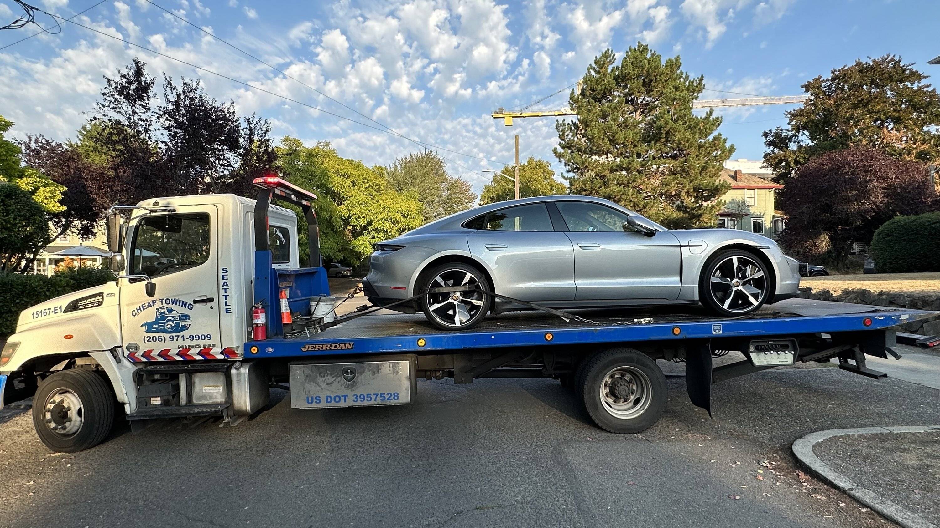

Mine was in a 1926 house, in a super narrow garage, down a slope. I got the tow hook out of the frunk, removed the back bumper cover, and screwed it to the rear tow slot. Tow truck diver secured a strap to the tow hook, I jumped in to steer it, paced it in neutral, and it was pulled out and placed onto the flatbed.

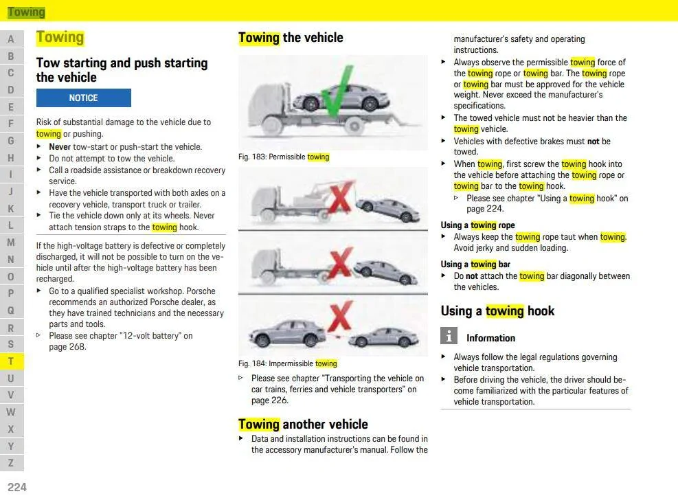

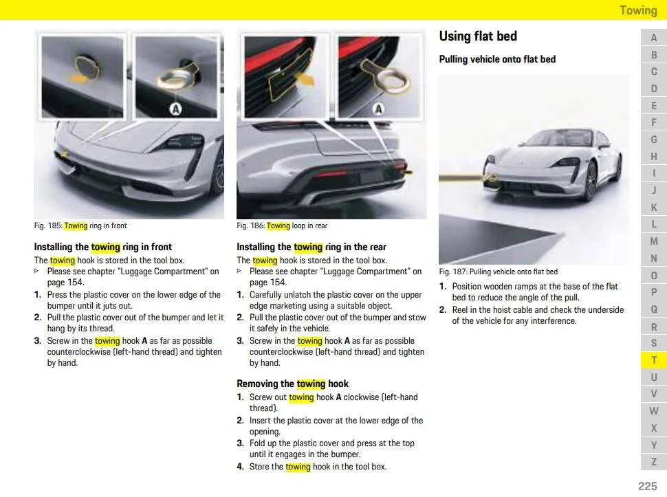

1. Read 3 pages in owners manual on "Towing". Describes towing hook.
2. Porsche tip sheets and videos by emergency recovery service contractor Agero:
https://info.agero.com/blueprint/porsche

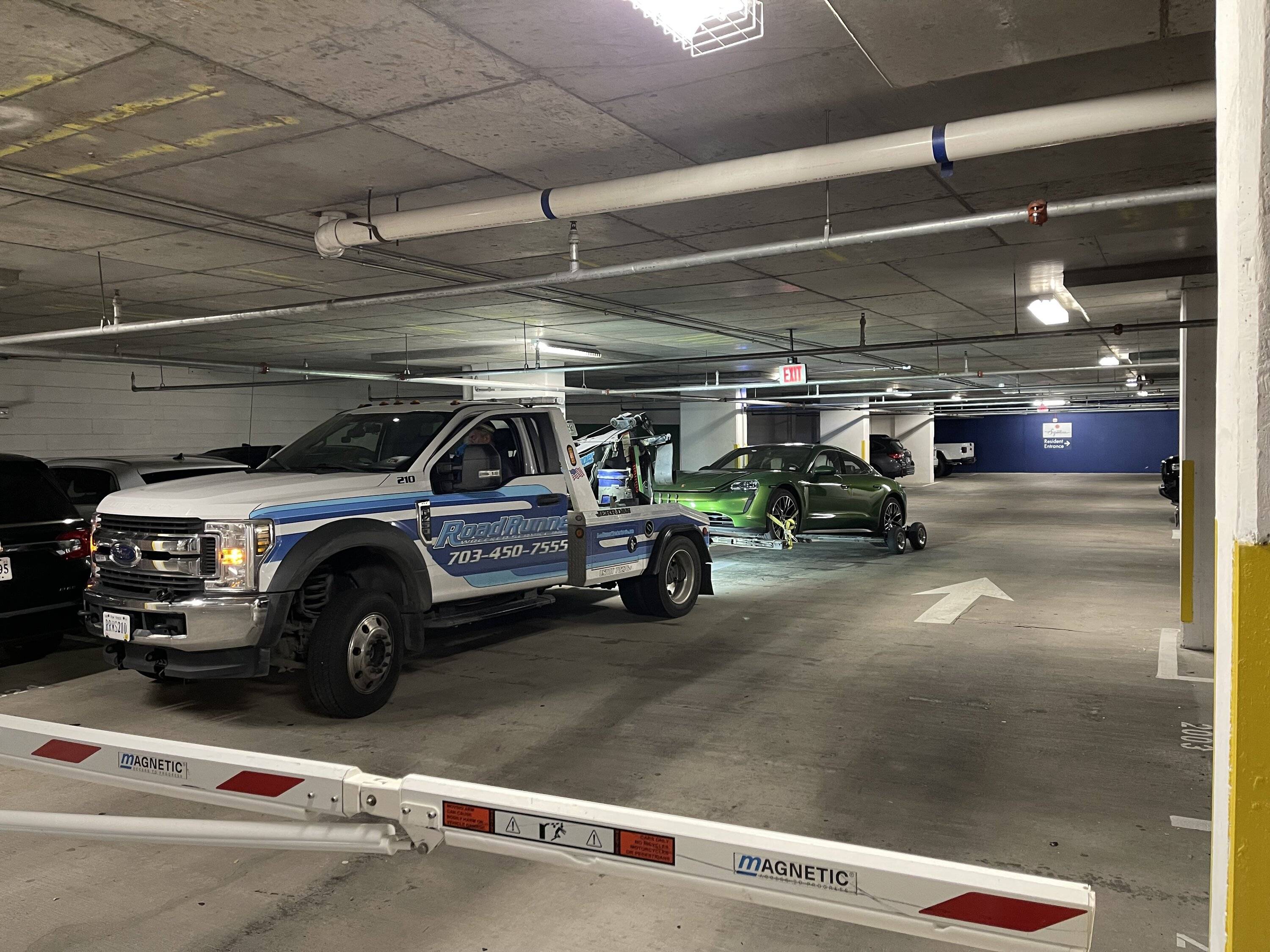

Porsche is giving me a new high voltage battery for Christmas! On Sunday I got the red Electrical System Failure Message upon starting the car. On Tuesday the tow truck arranged by Porsche Roadside Assistance limbo-danced under the low clearance fire sprinklers in my building's parking garage and the driver employed Cirque du Soleil skills to extract my Taycan from a narrow parking slot without excessively delaying all of my neighbors trying to get past to get to work. On Wednesday the dealership told me that the diagnosis is a failed high voltage battery requiring complete replacement (not cell replacement). That is excellent news since the state of health was 75% (verified by the dealership a couple months ago after I measured it with the code reader), and because my 2020 Taycan will now get a battery pack with the improved 2021+ battery chemistry, covered under warranty.
