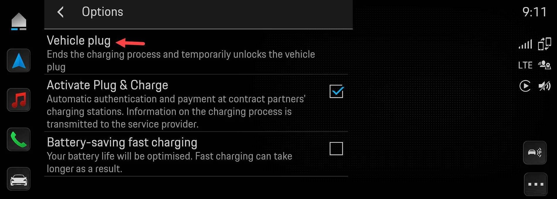

What is the rationale of this function, others can unplug you so they can use the charger?
Good question as I had the same thought. It may be limited to AC charging. No idea really.
11,063
6,846
It's a little hidden, but open the charging function in the app and then click the gear icon in the upper right. You should see two options, "Automatic AC plug unlocking" and "Uninstall plug & charge certificate". (I seem to be unable to post a screenshot here today for some reason).
I believe it only unlocks when you're AC charging; when it works, I can pull the charging cable out of the car after the charge is complete without hitting the unlock button, which is a small convenience that would be more important if someone else in my garage needed to use the charger. I've had it work, but after the big J1.2 software updates last fall, the car seems unable to remember the setting. It's settable from within the car too.
I only have the cert option. Perhaps different on J1.2 now.
Of limited use I'd say..

Auto unlock is on the app. Icon looks same as the car key fob. I use it when my car is valeted as I don't have to leave office to open car. Can lock it when they are finished.
Reference was to the charging port cable lock (Vehicle Plug) and not the car lock / unlock - 2 separate things and we all have that on the home screen of the app.
I have on my J1.1 but it is always greyed out - suspect it was one of several features that were quietly "retired".
