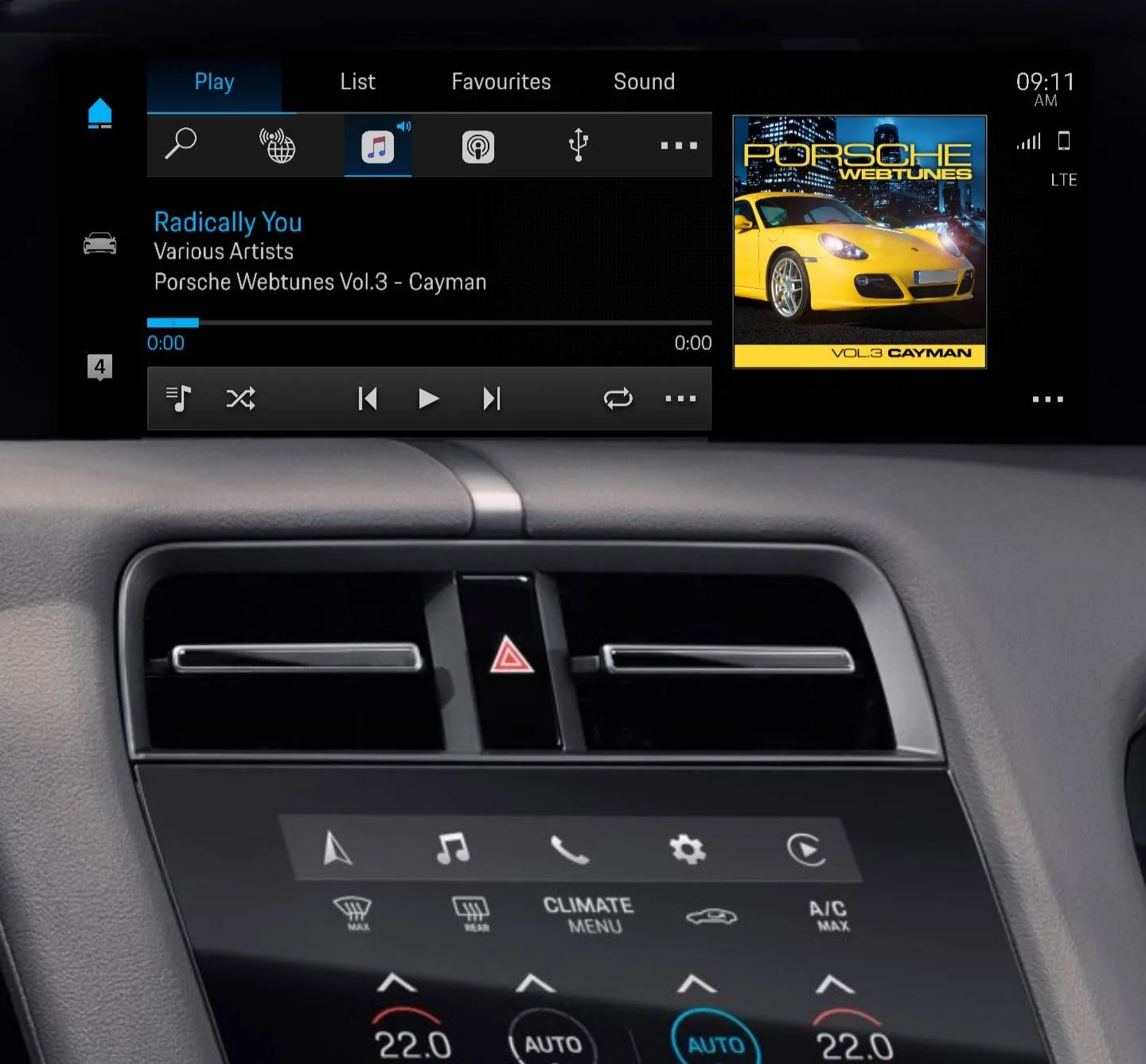

You mention data package - do you mean you paid for the Vodafone data package on monthly subscription?
If 'yes' and you did this purely for Apple Music then cancel your subscription as it it not required. The car has its own dedicated service for this purpose (and others).
In respect of Apple Music and Podcasts you need to link an existing Apple ID (or create a new one) to your Porsche ID.
Pretty straightforward - see page 11 of the manual below.
If linked correctly it will appear in Media - two icons - Music and Podcasts.
Android Auto is coming MY22 (last quarter this year) and may be added as a software update (my guess).

BTW: I am pretty sure the Apple Music Icon will disappear from time to time. Only wait a bit. ?

After working for several months without issue, my Apple Music and podcasts icons have disappeared. A bit frustrating as I prefer to use the native apps over CarPlay for audio. The bugs in this car …

As a workaround try switching to guest profile then back to yours.

My dealer had to reset my PCM and since then Apple Music and podcasts are permanently missing. I’ve tried removing my profile, guest mode, privacy mode, unlinking Apple Music using the iOS App, selecting the source via a function key… no dice.
Anyone else? I do have LTE service. If I select “show connected services” the PCM says it’s not currently available. The green light is lit on the emergency services button (on star like thing).

Are things like Weather or Searching Destinations via Google (not normal search) active?
I have seen this happen where the LTE service is connected but the PCM still acts as if there is no data. It is for sure – a very frustrating – software bug that needs fixing.
FWIW, the only thing I have found that works – rebooting PCM does nothing strangely – is to park the car in a strong LTE signal and lock the car. Walk away with the key and make sure the key is out of range for at least 40 minutes (I know!!). That – for me – has reliably returned functionality.
Nuts.
Porsche's Workshop documents are full of instructions to shut down car, lock it and walk away to allow the car "sleep". Given that this all over their technical info – I don't see a fix coming soon.

It was parked overnight in my garage where Verizon does work (it’s not 4 bars, but it works). I was able to log out and log in, etc., so it does have data. Frustrating for sure. Prior to this last visit to the dealer it worked 98% of the time.
