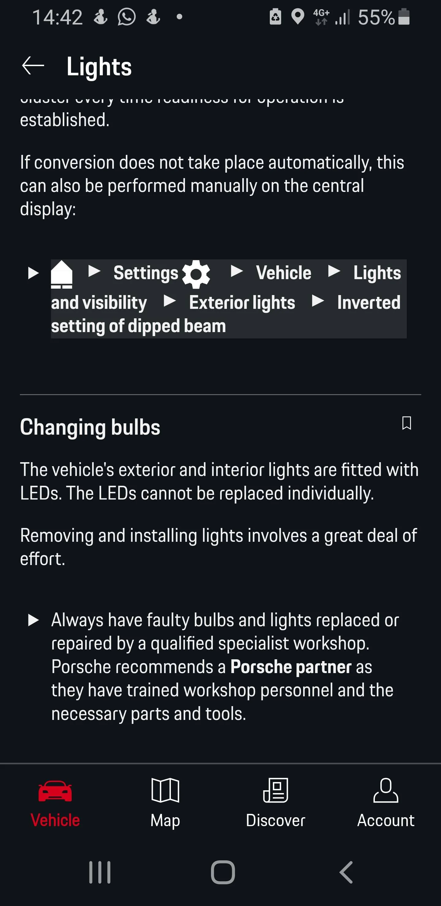

There is a setting for switching from left hand side to right hand side driving - check that that isn't set incorrectly for starters
There are other settings too
Porsche Taycan Matrix LED Light Issue Screenshot_20231201-144234_My Porsche
