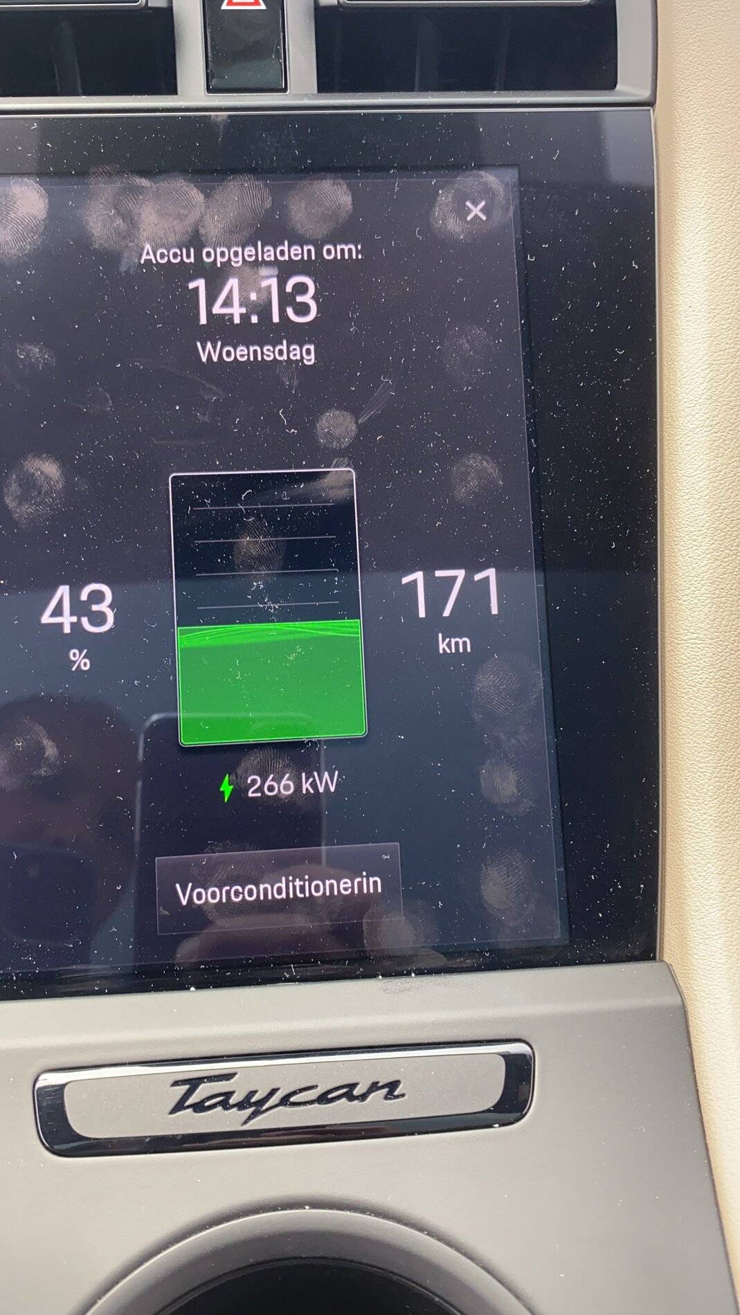

Peaking at 166 kW on a 350 kW charger when starting at 7% SoC seems bad, am I missing something?
The last month a lot of taycans are charging at lower % . i’ve contacted Porsche but no response yet. But at one charge point again 267 kW
Porsche Taycan Maximum charging speed 0B597129-F9B9-4383-9086-CB13557FB6A3

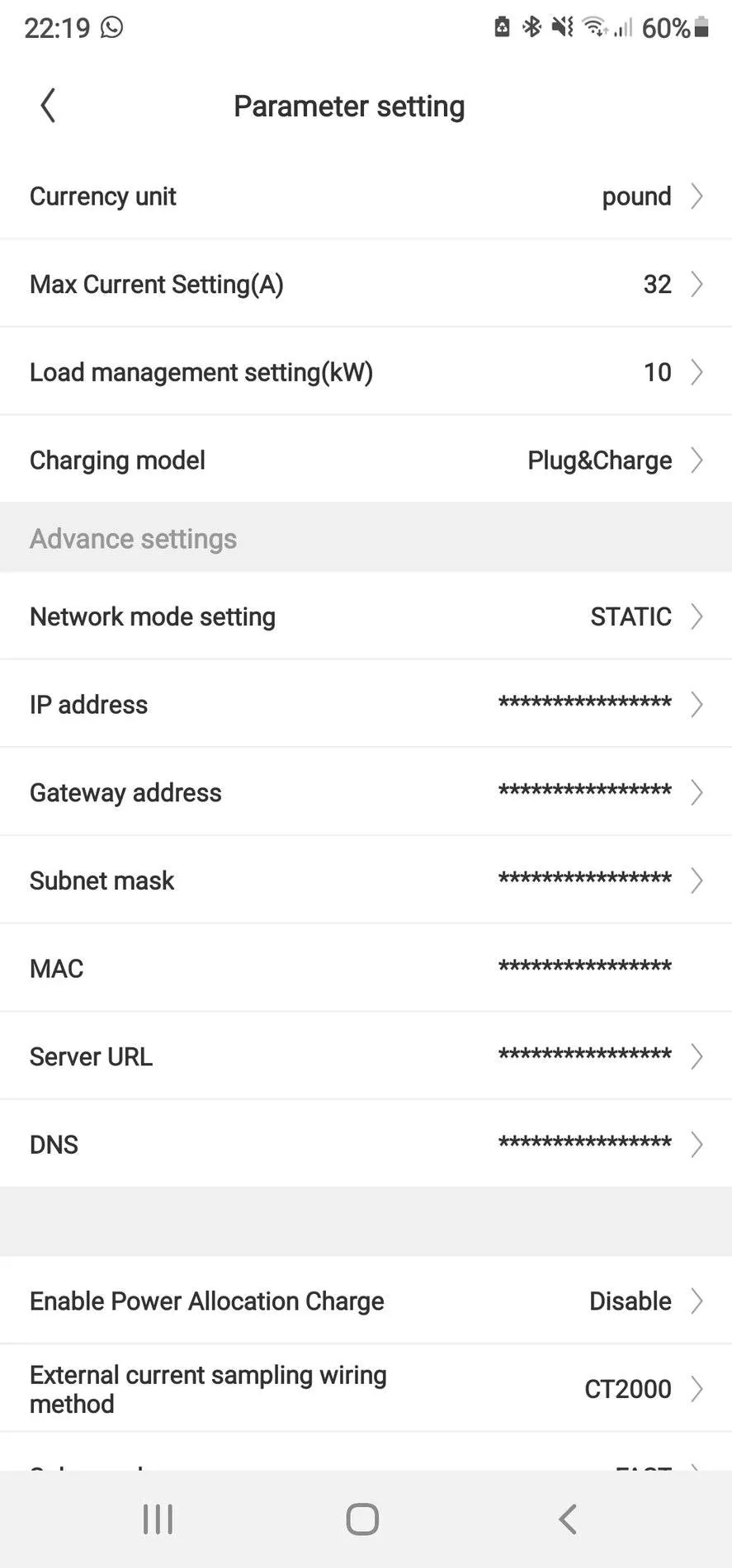

Basically you need to ensure that the supply has a 32 A fuse and that the supply connector from the fuse box to where it terminates at your charger (before connecting) has the same 32A rating (16A will reduce the available electricity supply). If this all hold true then you know a full single phase of electric is being fed into the charger. This will support a max of 7.4kW).
32A fuse in consumer box and screenshot shows charger set to 32A.
Didn't know cables were rated differently...the Audi cable charges at 7kw, the Porsche one at 4ishkw
The cable from the charge point to the car must also support 32A.
Ensure the charger is set to 32A.
Porsche Taycan Maximum charging speed Screenshot_20210726-221905_Project EV
