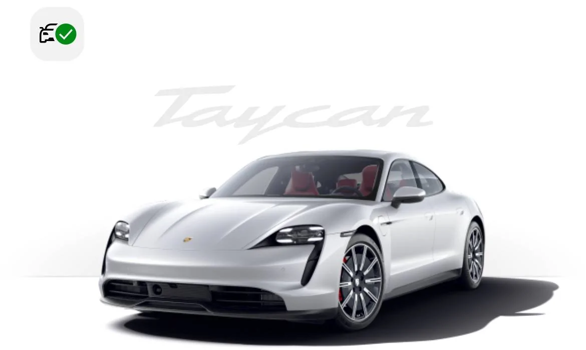

I used to have the problem frequently, and maybe it’s a coincidence but with the latest MyPorsche app update the problem has not reoccurred.
Porsche Taycan MyPorsche app and website showing wrong rear windows status. IMG_5519
freeforall
freeforall
Sep 30, 2022
76
62
Paris
Taycan Sport Turismo
From my side the only difference I see with the new app is the fact it refreshes the status on its own after launching the app: after 10 seconds or so the status will go from red to green (which makes the problem slightly less annoying)
Before the update I had to force a manual refresh by swiping down and wait (sometimes a lot looking to the grey icon spinning)

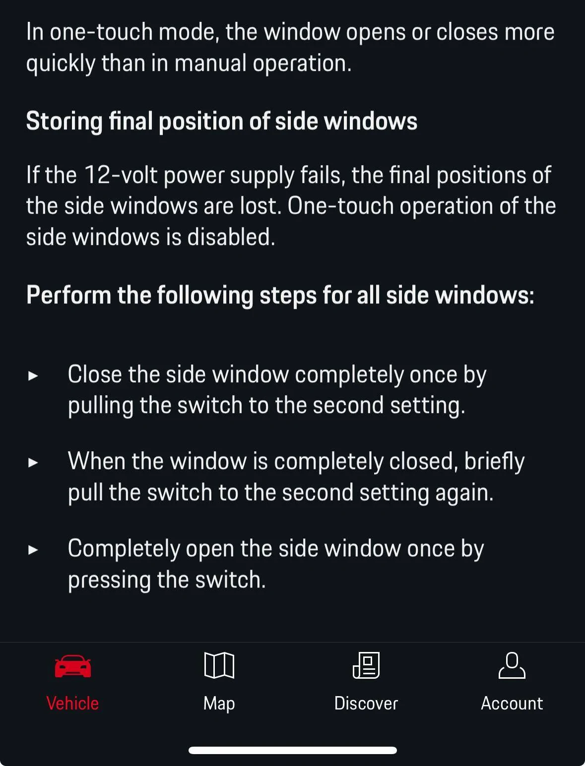

Check out the method to reset the "Closed" state of the rear windows at this link - https://www.taycanforum.com/forum/t...new-interface-and-functions.18587/post-287187
In my experience this fixes the problem.

Thanks. If the Closed position is lost the status should never turn to closed. In my case and many others, it just shows the status as open when launching the app and refreshes to closed afterwards. (So it does eventually identify that the status is closed which indicates that the position is not lost)
If you wait 30 to 45 seconds it then updates the status to the correct closed state. At least this is how it’s working at my end.

Porsche Taycan MyPorsche app and website showing wrong rear windows status. 1706886922301
I performed the last 3 bullets last night and issue resolved. This is from the windows section in the user manual. When the issue happened to me I lost the vehicle status in the app and refreshing did not fix, but after performing the steps, vehicle status returned in the app.
