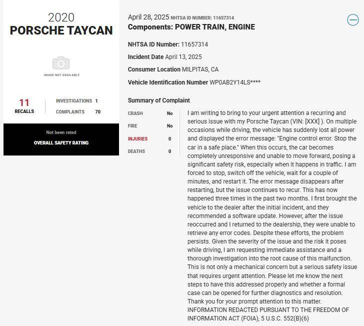

Hello, I'm wondering did you experience any further issues, or did they fix it? Or did you trade it in? I experienced the same exact situation in September of last year and Porsche had my 2020 Taycan 4s from Sept 18 - Dec 18 saying they had over 18 parts to replace and just two weeks ago I experienced the same problem again. I'm back in a loaner car and they're trying to figure it out again.
eastATLceo
Feb 12, 2024
Conyers, GA
:(Really worrisome. Stopping in the middle of road like a computer “crashed”.
Hopefully OP got a detailed explanation of the reason and would be able to share here.
Yes, this is exactly what happened to me as well. It's super random and you don't know it's coming. However, what has been consistent, it only has happened when trying to pull off from a stop or when the car was going under 15-20 mph... So it's like you're stalled pulling out in traffic or while coasting in traffic. Scary is an understatement.

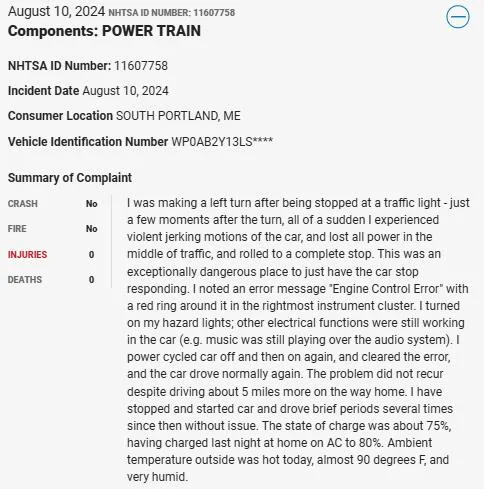

dnigrin
Mar 2, 2024
Portland, Maine
Happened to me today. Was making a left turn after being stopped at a traffic light - just a few moments after the turn, all of a sudden violent jerking motion of the car, lost all power in the middle of traffic, came to a complete stop, super dangerous place to just have the car die. "Engine Control Error" with red ring around it in the rightmost ring. Turned on my hazard lights, power cycled car off and then on again, and thankfully that fixed it, didn't recur despite driving about 5 miles more on the way home. Stopped and started car and drove brief periods several times since then without issue. SoC was about 75%, having charged last night at home on AC to 80%. Temperature was hot today, almost 90 degrees F, and very humid. 2020 model, purchased CPO ~6 mo ago.
Is this the "Red Ring of Death" I've read in other threads, or something different? In those, it seems the car dies and is not revive-able. I have an OBD scanner and will check the battery condition tomorrow AM... Is this an immediate "bring to the dealer" moment? I'm not convinced they have any clue as to what's really behind these events... But am I risking it by continuing to just drive it?
