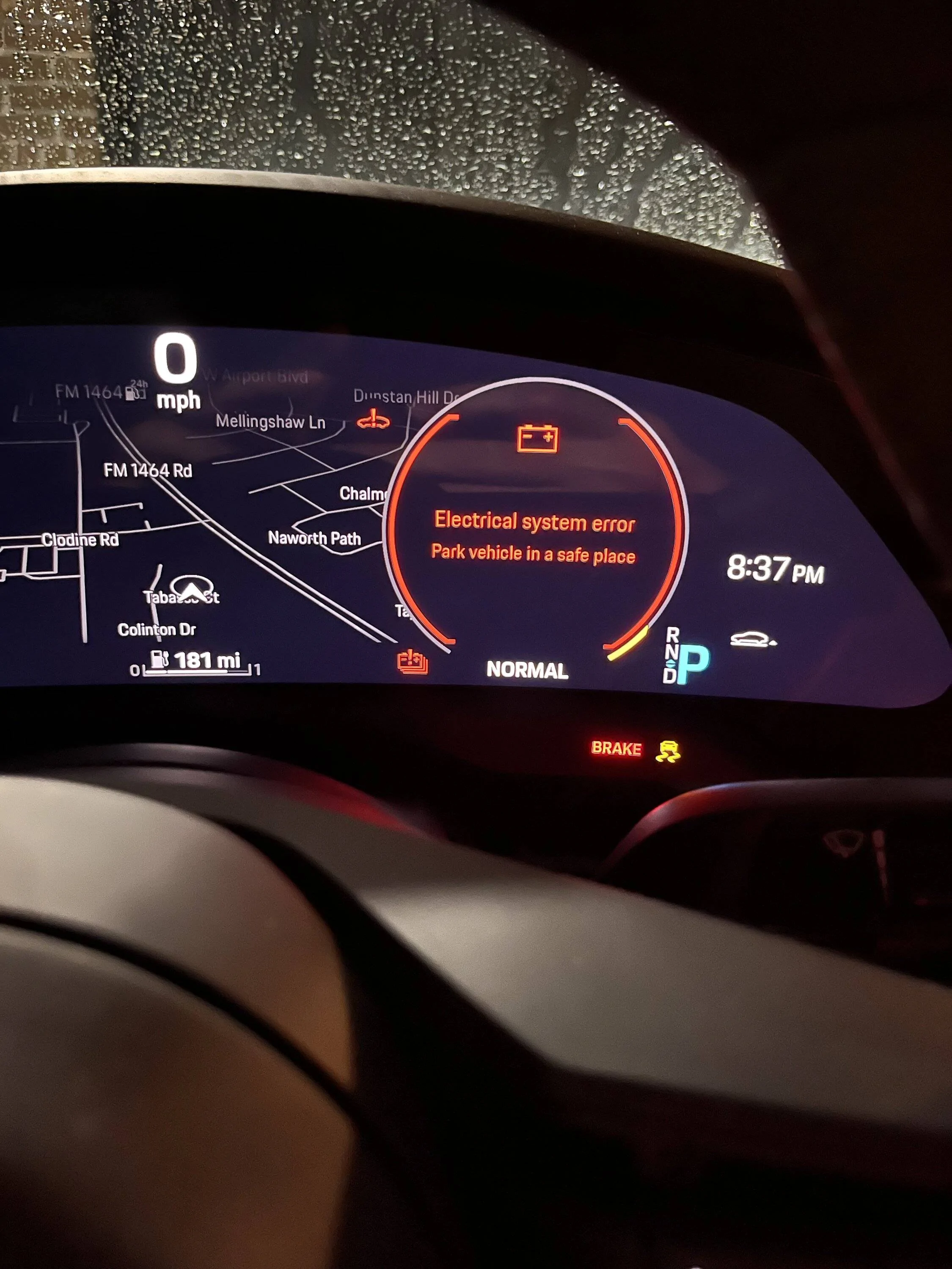

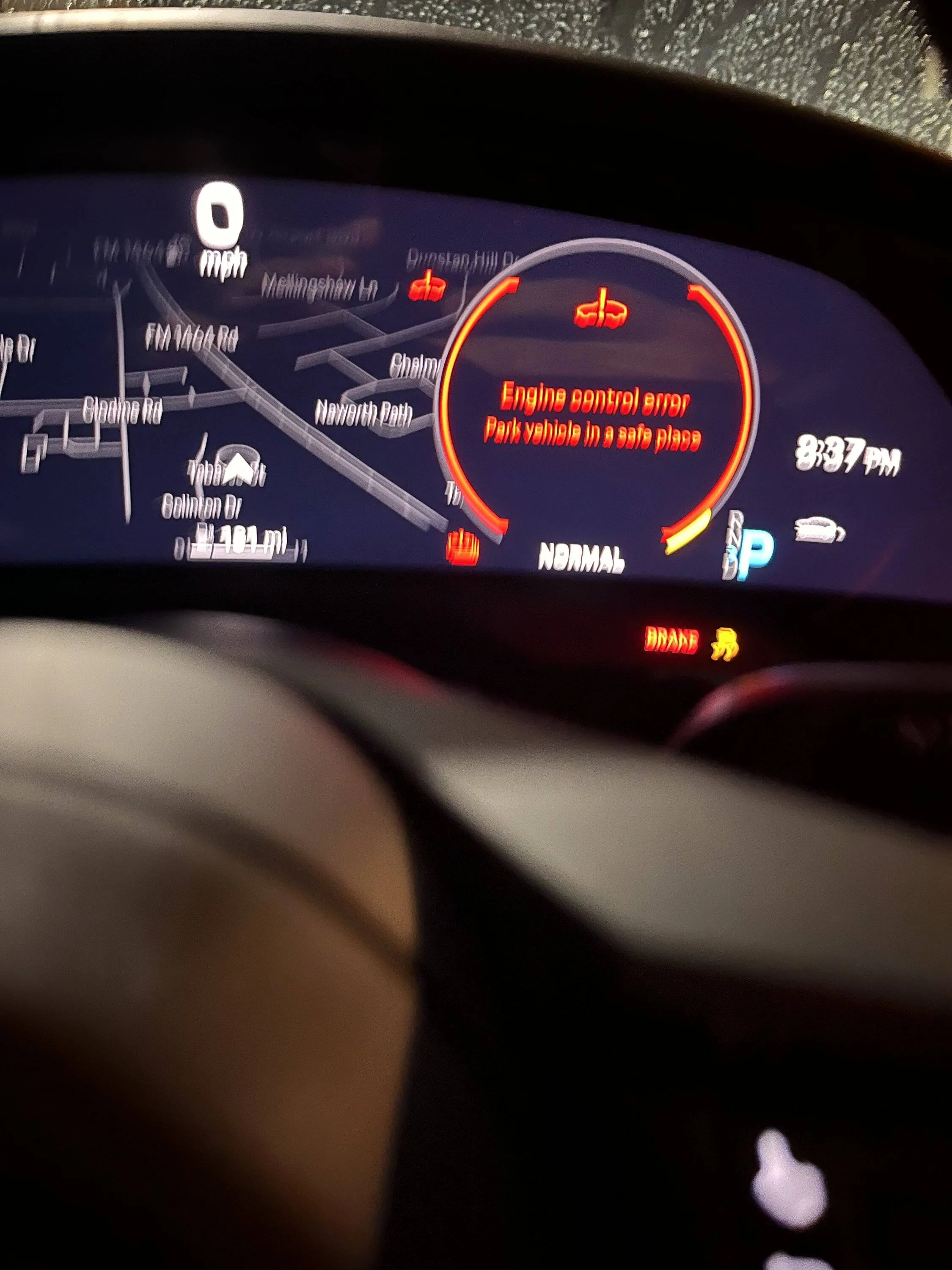

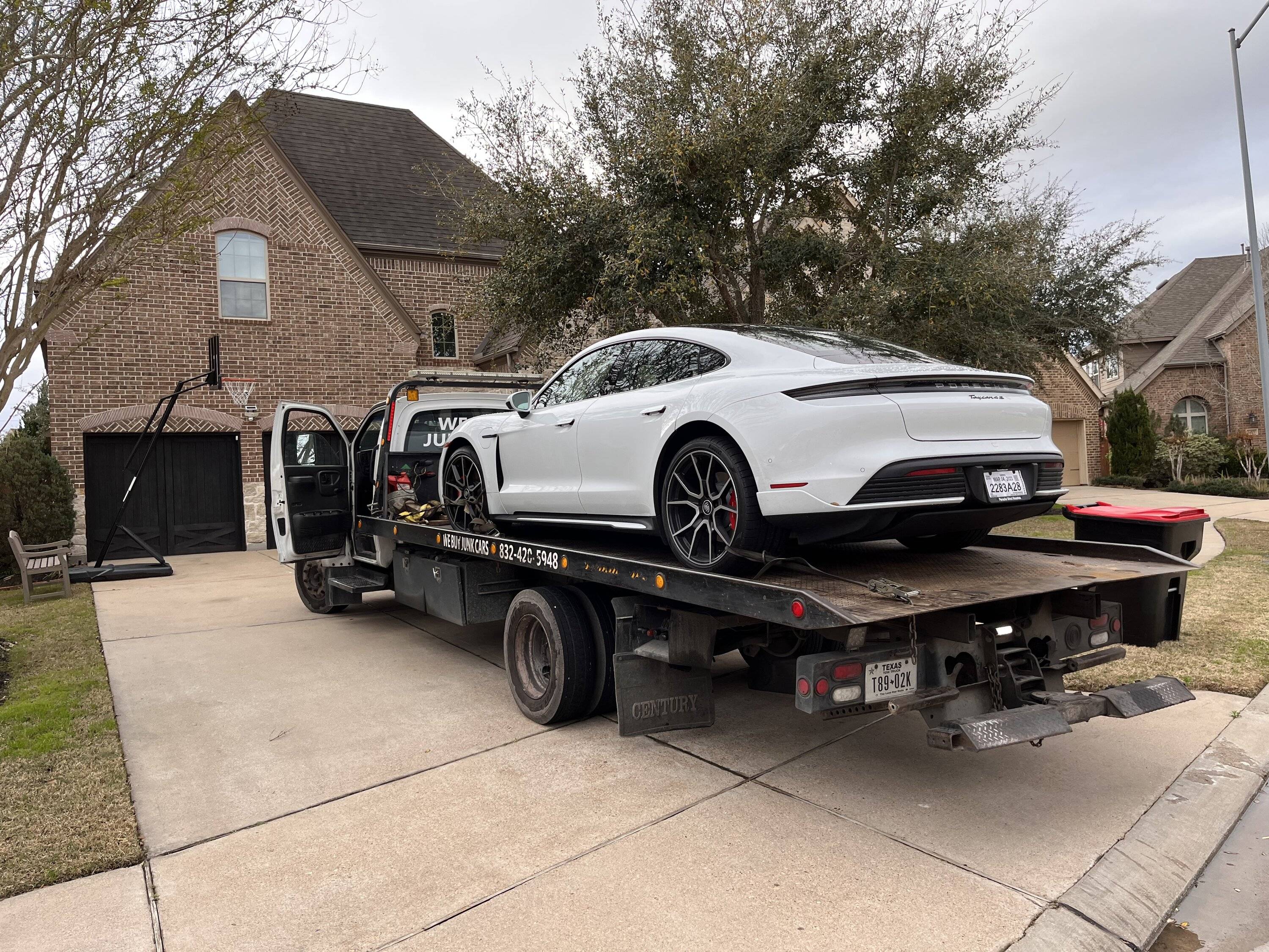

New to the forum so apologies if I’m duplicating threads. I’m a new Taycan owner - had the car less than a month and just hit 800 miles and had complete loss of power. Luckily the car was in a friend’s driveway but had to get towed to the dealership.
After reading some of the posts on this forum, I have some major concerns about this issue and the fact that it happened to me within a month of owning. But I have not seen any fixes. Unless I’m missing something, am I screwed?? I live in Texas and lemon laws are generally NOT in favor of the consumer. It’s sitting at the dealer now for 4 days and they are still diagnosing the problem. They ‘believe’ it is something related to the airbag not communicating with the computer. Any advice or guidance is greatly appreciated!!!
Below is the screenshots.

I'm sorry you have experienced this problem.
Sometimes, instrument panel errors (and other unusual operational problems) on a Taycan resolve themselves. These steps can be helpful.
--Turn off car and exit it. Take key fobs and move away from the car (20 to 30 feet so key fobs are out of range of the car) for 5 to 10 minutes. This can reset the car software systems.
--Same as above, but for 30 to 45 minutes.
--If the above do not work, some owners do a hard reset. In this step, you briefly (few seconds) disconnect the 12 volt battery located in the frunk. There are posts on the forum that give details of steps for a hard battery reset.
It's not always feasible to wait and try the above. You can read lots of posts here about electrical system error messages. Not clearly any one cause or fix.
