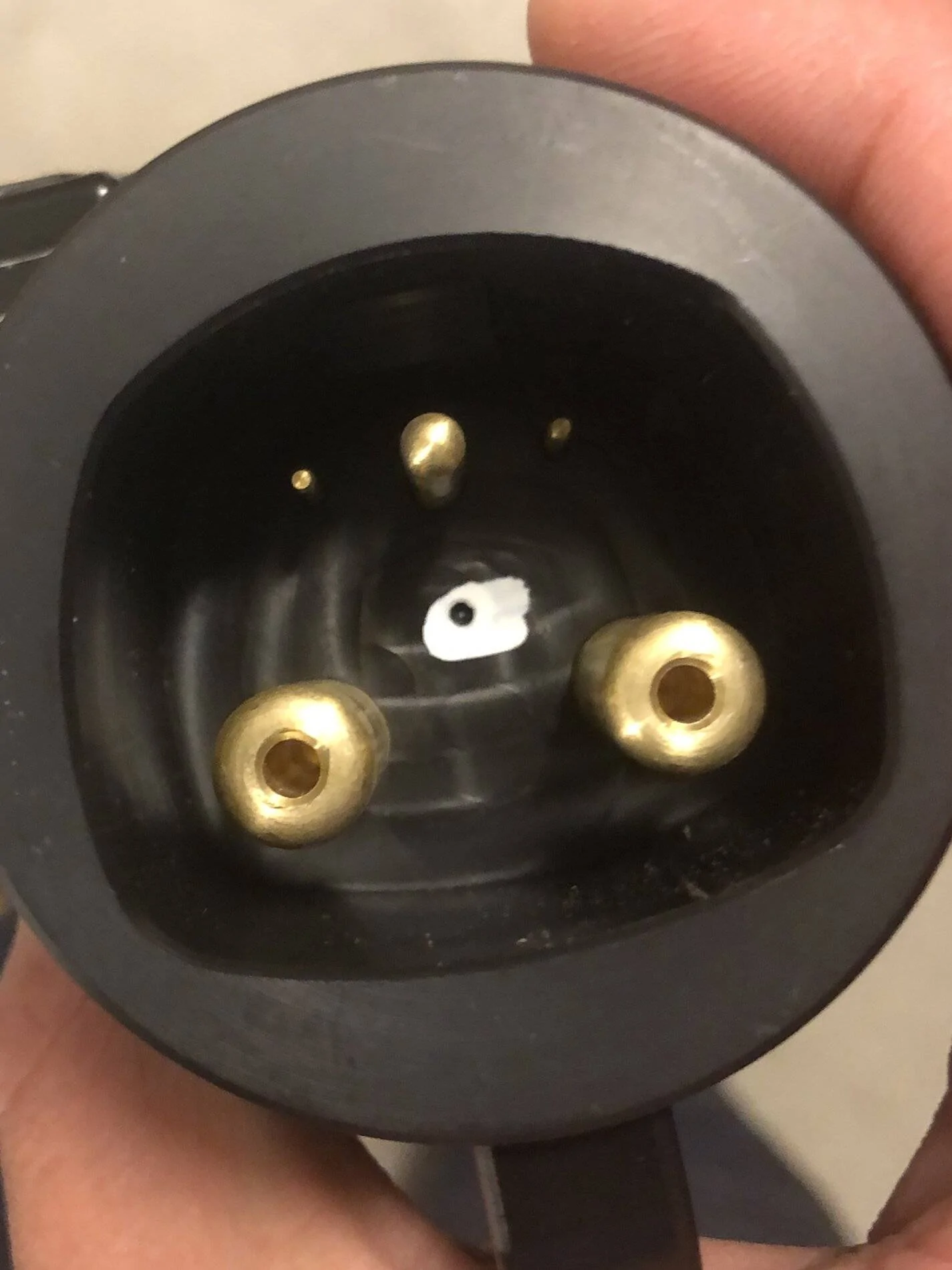

No, at least not for me! This is a little concerning and hope I didn't get the wrong one either!
I just sent [email protected] an email and hopefully I'll get a response.
My box says 80 AMP but mine has a red painted dot. There are no other paint dots. See pictures:
Hmmm.... good catch. Let's see what he says, otherwise I'm happy to write him as well.
ciaranob
Jul 3, 2021
3,519
2,573
Would def like to have clarification on the red and white dots too - hoping you can update soon vs everyone flooding him with calls :)!
I ordered a 80 AMP awhile back and when it arrived I called re. this question. I was told the 80 AMP has a white dot, which mine does have.
ciaranob
Jul 3, 2021
3,519
2,573
Have the white dot but came in a 60 Amp box! Sure would be nice if you could just look each unit up by its serial no. to validate - but no obvious means to do this on site.

I ordered a 60A. It came in a 60A box and has a white dot.
Mine as well. Paperwork says 60A but there’s a white dot.
Chedman13
Aug 10, 2021
101
Illinois
GL63 Brabus B63 Widestar, Awaiting Taycan Turbo
Does anyone have a red dot ? like me? If so please list what you ordered and what it says on the box!
1) ordered = 80 amp
2) box says = 80 amp
3) color dot = red
(Anyone reading this that hasn’t read the whole thread, no idea if I have the right amp one or not)
58
4,952
4,131
Believe it was marked on the box
I ordered mine about a month before this group buy, but I don't recall if there was a box or the markings on it.
I ordered an 80A. Box said 60A when it arrived so I called. They said if there is a white painted dot on the Tesla end of the charger than it is the 80A. Does this jive with those who ordered the 80A?
Well, you might have the 60A version. I pinged their support and got the following back via email (from Dave):
The serial Number or In the Tesla end there is a testing mark/identifier.
Red=80
White=60
None=40
I ordered 80A and the adapter the one which came has a red dot on the Tesla end, so it is consistent with the above description. I have tested the adapter at 80A, though only for a minute or two.
If you ordered the 80A but don't have the red dot, I would reach out to the company before using it to charge at 80A unattended for prolonged times (e.g. overnight charging) - I know that some Taycan owners who already had Tesla HPWC were planning to use it for daily home charging. It's possible that in the flurry or group buy orders some mistakes happened on the fulfilment end.

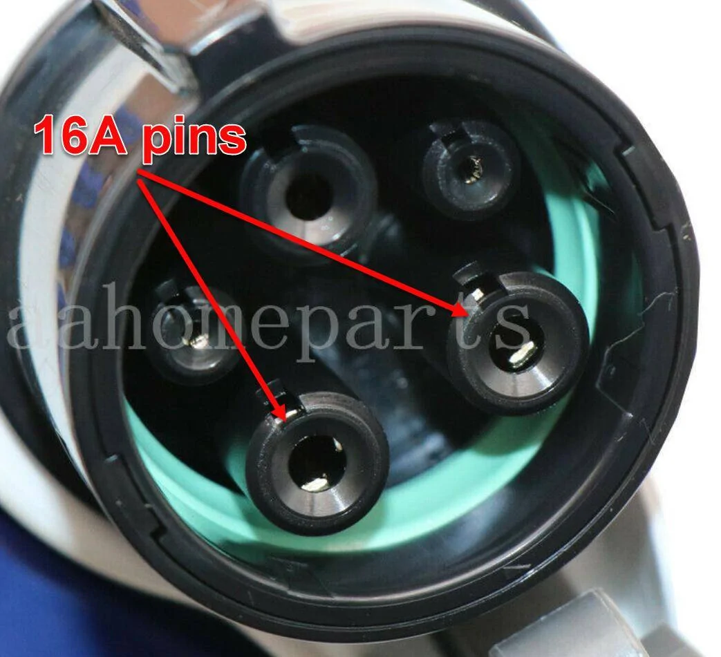

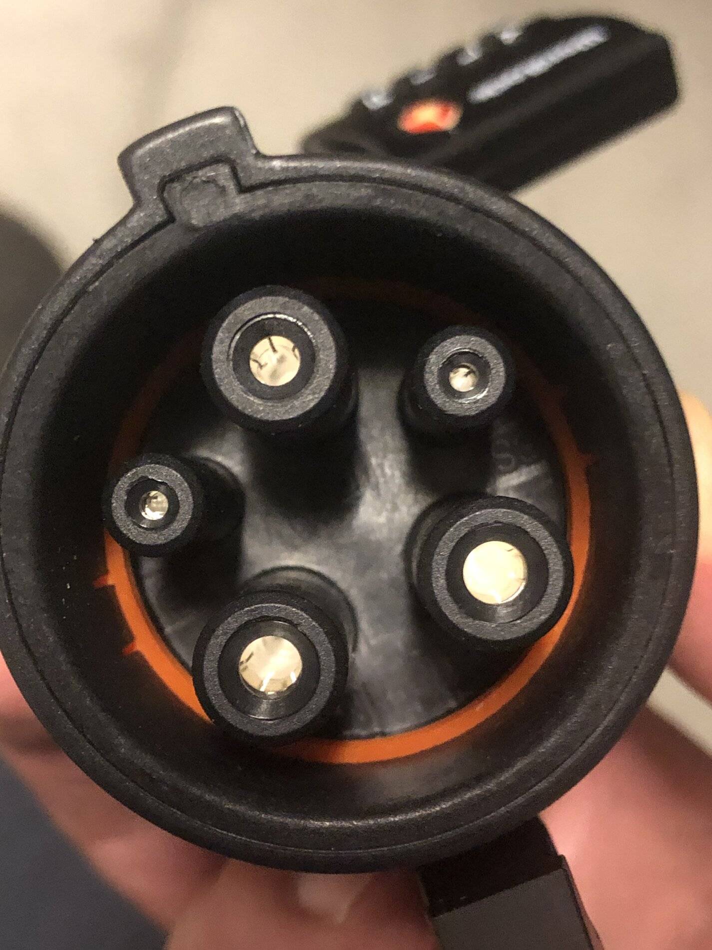

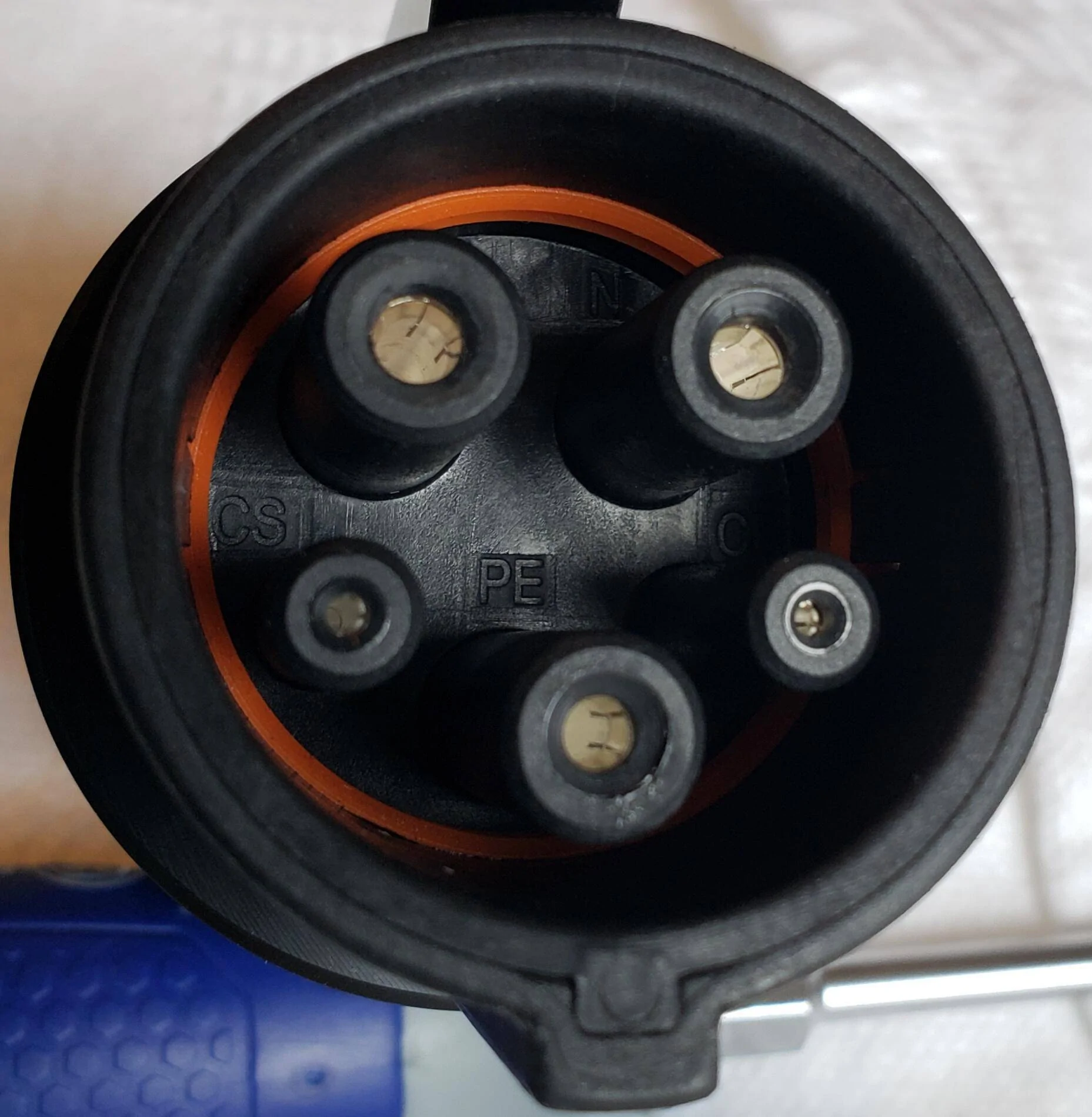

Out of curiosity, do you have a picture of the J1772 end of it? Often different current rated pins look different (less contact surface area for lower currents). Mine looks exactly like @Chedman13 post #46 above.

Here you go.
Your J1772 pins look the same as @Chedman13 and mine (both of which have red dots on the Tesla side), so perhaps the pins used for 60A and 80A are the same, so the difference could only be inside connections. Another possibility is that they only build 80A and 60A the same and just mark them differently before shipping, or maybe they were short on 60A to relabeled some 80A's as 60A - only the manufacturer will know so you'll have to wait to hear back. Let us know what they say.
Below is my TeslaTap 80A adapter:
Porsche Taycan OFFICIAL:  TeslaTap Mini Adapter GROUP BUY is now AVAILABLE 1630908123097
And for reference, here is a picture of a 16A rated J1772 pins, notice a lot less contact area inside the pin.
