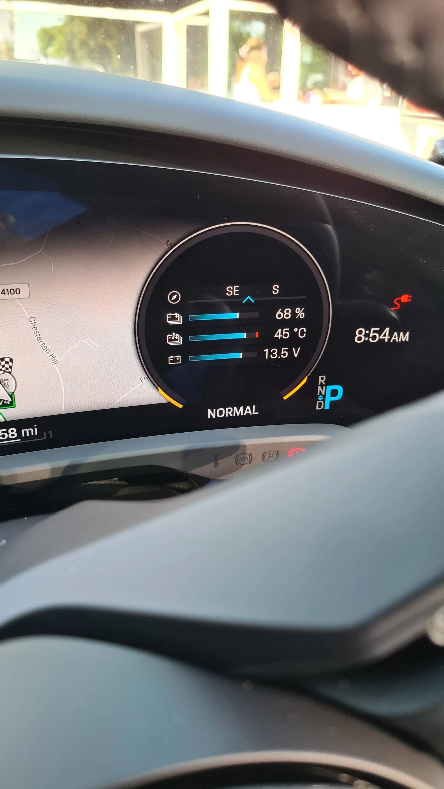

Has anyone noticed that battery preconditions to a higher temperature following update?
Only my second DC Charge since update, the first time I thought battery temp on arrival was higher but today it was definitely higher than pre update. Battery went from 32° c to 45°c in the 15 mins before arrival at charging station.

I have noticed this as well. I am seeing ~5C higher than before the update.

I have seen preheat to above 50 C. Makes me wonder if it is healthy - can we trust that? Tempting to use battery saving DC charge mode, as five minutes more or less when fast-charging normally is unimportant to me.
Edit: I'm not sure my memory is correct about pre-heat versus temp during charging. But I have definitely seen it well above 50 C.

That seems very close to the battery temp trigger (55C IIRC), when the thermal management will drastically restrict power delivery to the motors.

That does not sound good. Too close to Turtle mode! Once you charge at HPC you would heat up the battery to too high temperature.
have you seen this more times ?
