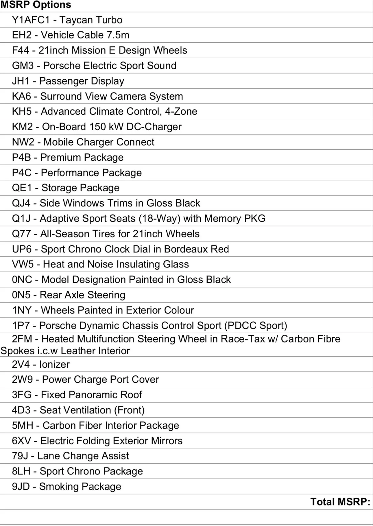

Good point thank you for mentioning. I got a list of option codes from the sales sheet:
Porsche Taycan Overwhelmed by options available Taycan Turbo IMG_3849
Here
Yeah, I consider this a well specced car otherwise, except for the lack of Adaptive Cruise Control. Some people don't care, but if you want it, I would not compromise on that. It cannot be added afterwards, and you'll be stuck with a car that does not do ACC whenever you think "ACC would be nice right now".
Also, "Smoking Package" is personally a bit of a red flag for me, though some people get it just because it's free and adds an ashtray for the cupholder that can be used for something else. If you can visit the car locally and thoroughly smell it out (keep in mind that smoke smell is something that can virtually disappear and reappear, depending on how strong), it might be fine. Just something to watch out for. Never mind if you're a smoker yourself, of course!
Here
this has the 400V/150 kW charger - that's the KM2 option - you're good to go for Tesla supercharger use at full 150 kW.
Here
this is a nice build - there are very few functional options "missing" - I can't think of any major one's right now.

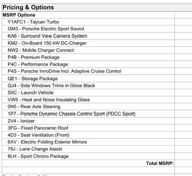

the dealer has another one, no PSD but InnoDrive and ACC, 5K more probably because because of these expensive options
No 19.2kw or 22kw :-/ it’s always something!
Good point on the smoking package, not something I’d opt for that’s for sure.
19.2 kW is not a thing in North America - there are few if any 19.2 kW charger "in the wild" - mostly you get this option if _YOU_ are going to have a 100 amp EVSE in your home/work/vacation home - otherwise it will go mostlly unused.
so I would not let the lack of a 19.2 kW charger deter you - also it _CAN_ be retrofitted at great cost if you desire.
