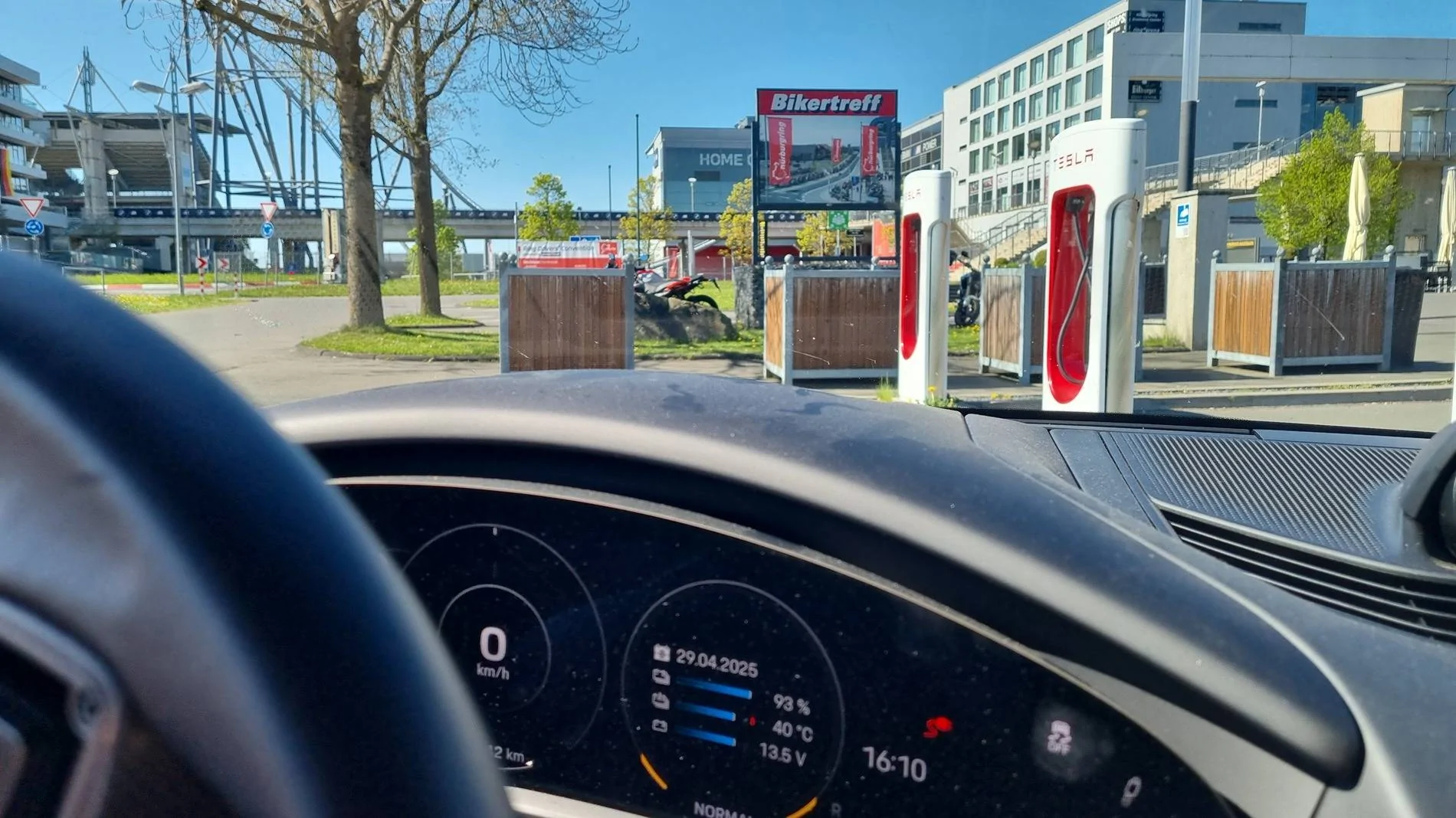

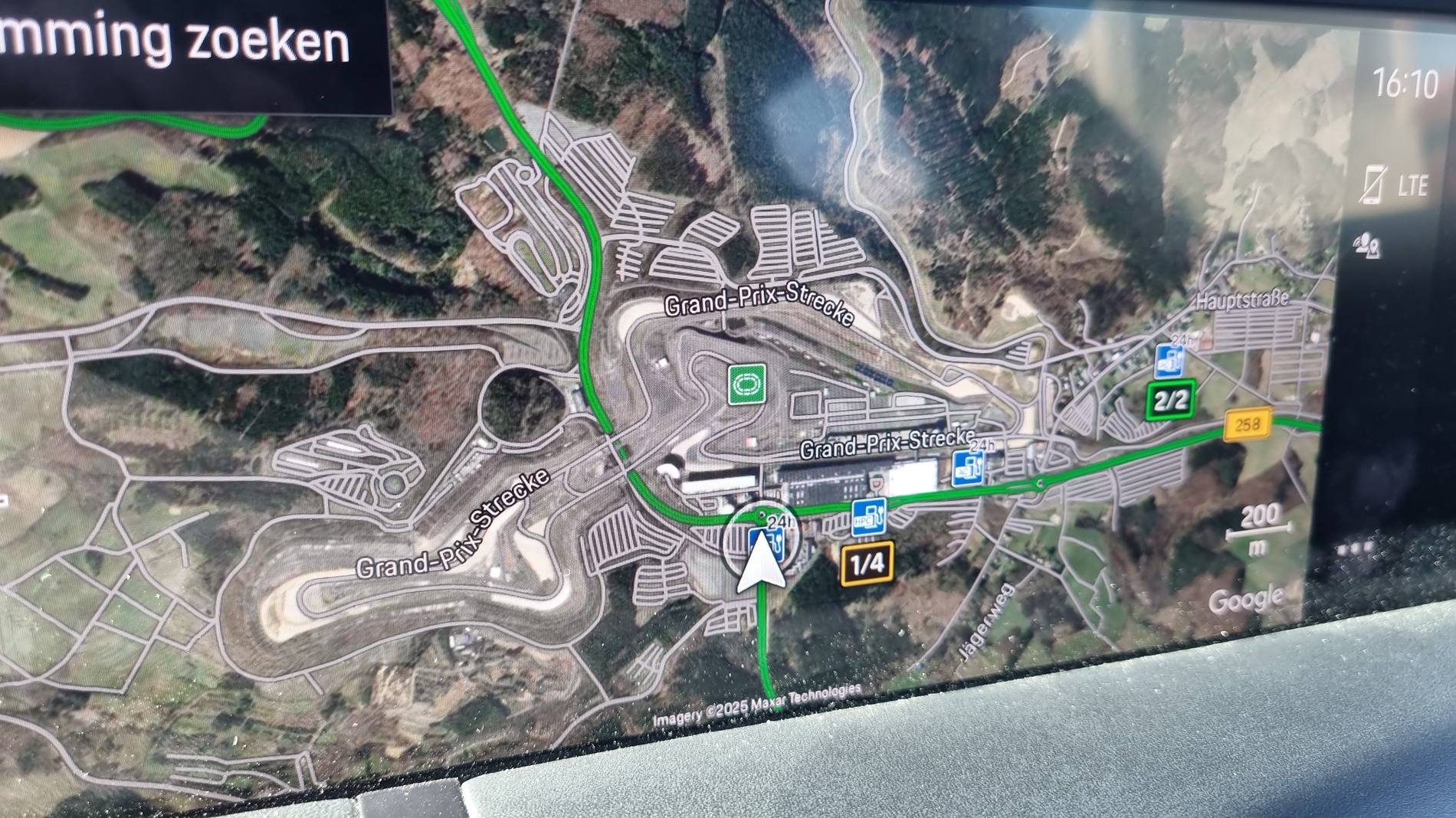

Rik_CT4s
Ricardo
Aug 6, 2022
399
263
One for the team...pre tuning testing :)
Germany Nurburgring Eiffel....with a full battery this time.
Due to Tesla short charging cables this is the way ....some Tesla drivers waiting :) (well sorry, I need full juice before hitting the track)
Oh I'm suuuuure this was a painful one taken for the team: oh snap, I HAVE to ride the Nurb Nordschleife for testing, too baaaad :( ;)
Good that they have this Tesla SC - but having more charging slots would be nice.
