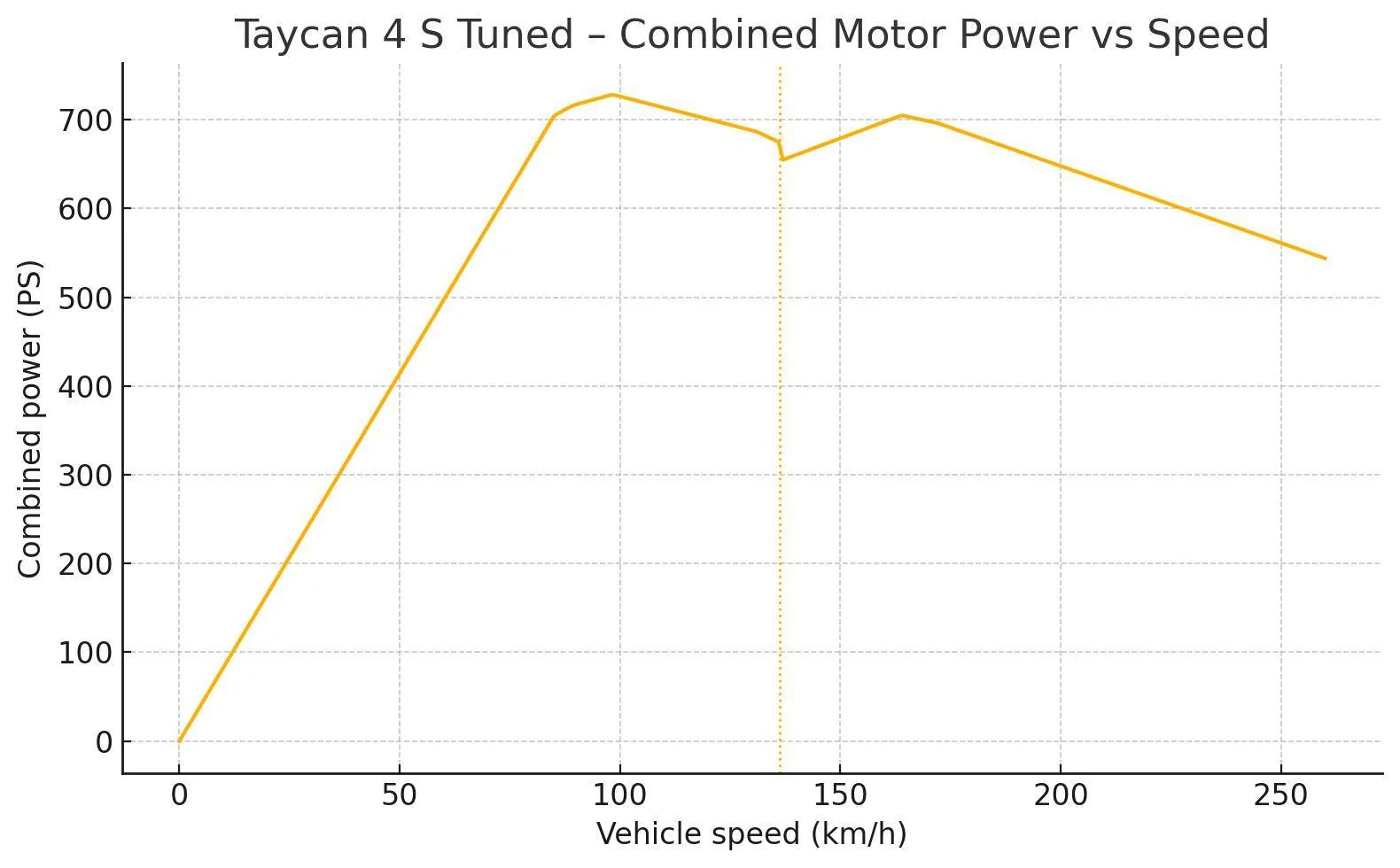

It is interesting how the 2 motors with their different torque curves as well as 2 speed transmission on the rear motor combine to give an interesting power curve throughout the speed range.
Here is the graph for 4S:
Porsche Taycan Part 2: The J1 Powertrain 1745619118318-g6
Because the rear motor of the 4S reaches max power of 480 only at 10 000 rpm after the shift to 2nd gear we fall back to 8000rpm and out of peak power band and that is why there is a "dip" at 130km/h before it picks up again and reaches 700hp at around 160km/h but still less than at 100km/h because now the front motor is making less power.
The power graph of the big rear motor in the turbo is much flatter without the dip between 100km/h and 160km/h because the rear motor reaches max power 525 PS peak earlier (≈ 7 000 rpm) and doesn't fall out of the "sweet spot" after shift to 2nd.
Comparing the 4S and the turbo after between 80km/h and shift to 2nd gear there is only 30-40hp difference. The difference after the shift to 2nd until about 160km/h is about 100hp and after 160km/h it goes back to only 30hp advantage to the turbo.
Real life chart doesn't really look 100% like this, because the gearbox takes some time to shift. But somewhat close.
Porsche Taycan Part 2: The J1 Powertrain 1745620332969-79

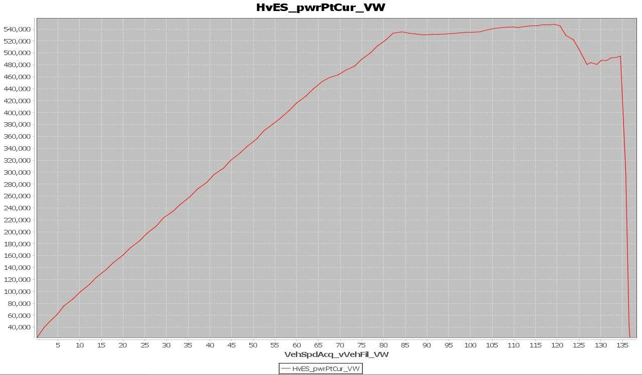

The gearbox shift is not instant, so it is not possible to complete the shift after 125km/h or so, otherwise it could hit the rev limiter during shift. 133km/h is 16000 rpm. I will see if invcon enforces this next week. Maybe we can go a little higher RPM.
So yes, you can't keep the small motor all the time in power band, but this is the best that can be done. After the shift the power output drops to 650 PS at 125 km/h and then goes back up. At 136 km/h it's already 680 PS though, which is the output of the stock Turbo.
It also makes 740PS. I quoted 730 exactly for this reason here :)
Your graph is a bit pessimistic.
There's one more reason why the drop is this significant. I noticed that probably some kind of timer expires on the inverters and by the time you get to the shift it has dropped out of launch control torque limit as well and maxes out at 340Nm instead of 360Nm during first gear.
Doesn't happen unless you start from standstill. Of course not a problem with the larger motor cars since their optimal shift is between 85-95 km/h.

Thank you for the detailed graph. Do you get the data with your VehiCAL software or is this some development tool u use to tune the ASG?
Mine wasn't meant to be precise, sorry if I gave a wrong impression. It was based on the graphs of front and rear motor you provided. I just wanted to get a rough idea of the interaction of 2 motors and how their power bands overlap depending on speed.

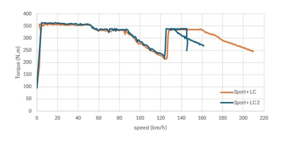

This is interesting. Another member pulled a LC torque curve for RWD from CarScanner. (See attached). And 360nm is only available for 3-4 seconds, up to 50-60kmh at launch and then car defaults to 340nm max after that, even though LC is still active. (I also observed this on CarScanner).
How would this work with your tune? Eg if you slam the accelerator at high speed (eg say 120-130kmh) do you still get the 360nm for 3-4 seconds? or 360nm will only be limited to 0-50 kmh speed range?

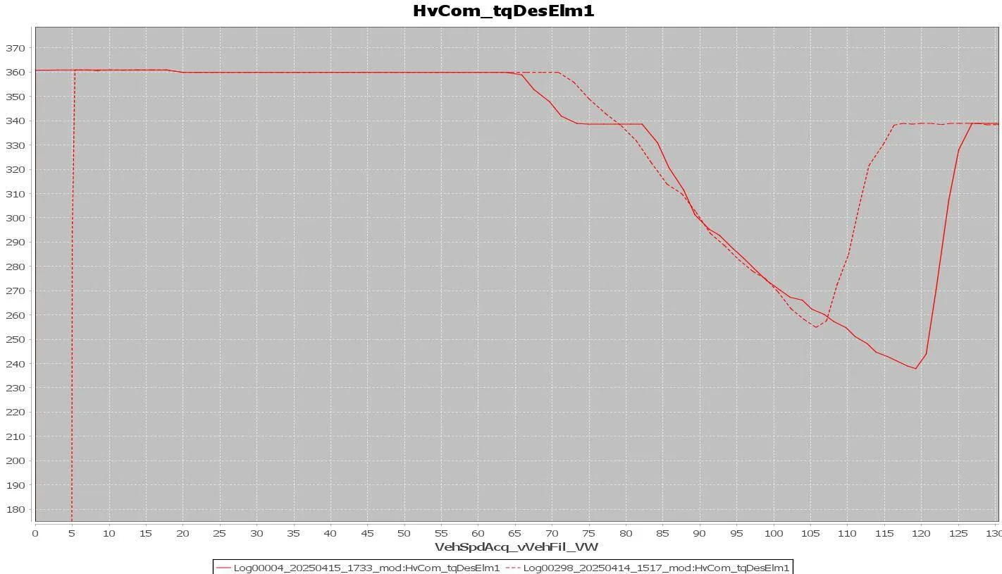

It's a timer, when you hit it at speed you still get 360Nm on the rear motor. 2.5 seconds on the dot.
You can see here from a standstill vs hitting at 5km/h (with my patch) from a roll, the entire graph gets shifted by 5km/h to the right. Ignore the different gear shift rpm, I was still in process of tuning the car, and moved the shiftpoint (the solid line is with a later version of the software with the shift point adjusted to 125km/h).
Porsche Taycan Part 2: The J1 Powertrain 1745660602663-j2
If you floor it at speed, you also get the 360Nm for exactly 2.5 seconds max.
This only affects the cars with the small motor though. Probably RWD is the most affected. The big motor cars are long out of the peak torque limit at that point and are power limited. This graph is from an e-tron GT.
