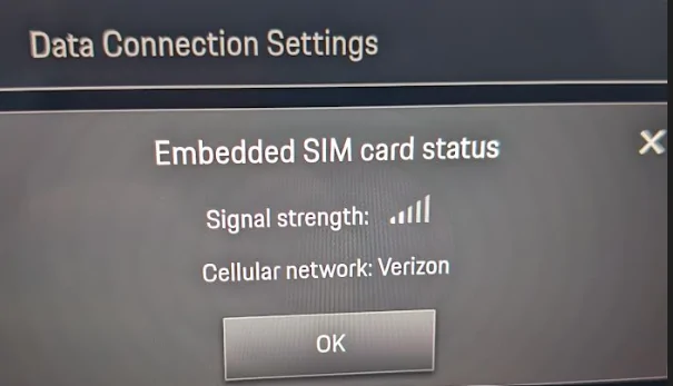

I have lost LTE connectivity with icon showing a slash across for several days, going to the dealer tomorrow to fix. However, SIM status screen show good strength and provider listed as Verizon but it does not have any indication of data status, what's the point of that screen then. I am not comfortable doing my own reset given that if systems do not reset correctly, then I have to go to the dealer anyway to fix them. I would rather them do it.
Very easy to do using the instructions above, takes a few minutes and saves a trip to dealer. My "Data Connection Settings" showed full signal and connected to Verizon, but also had the slashed icon on the right hand side of the screen... Annoying, but luckily, 12V disconnect fixed it.
