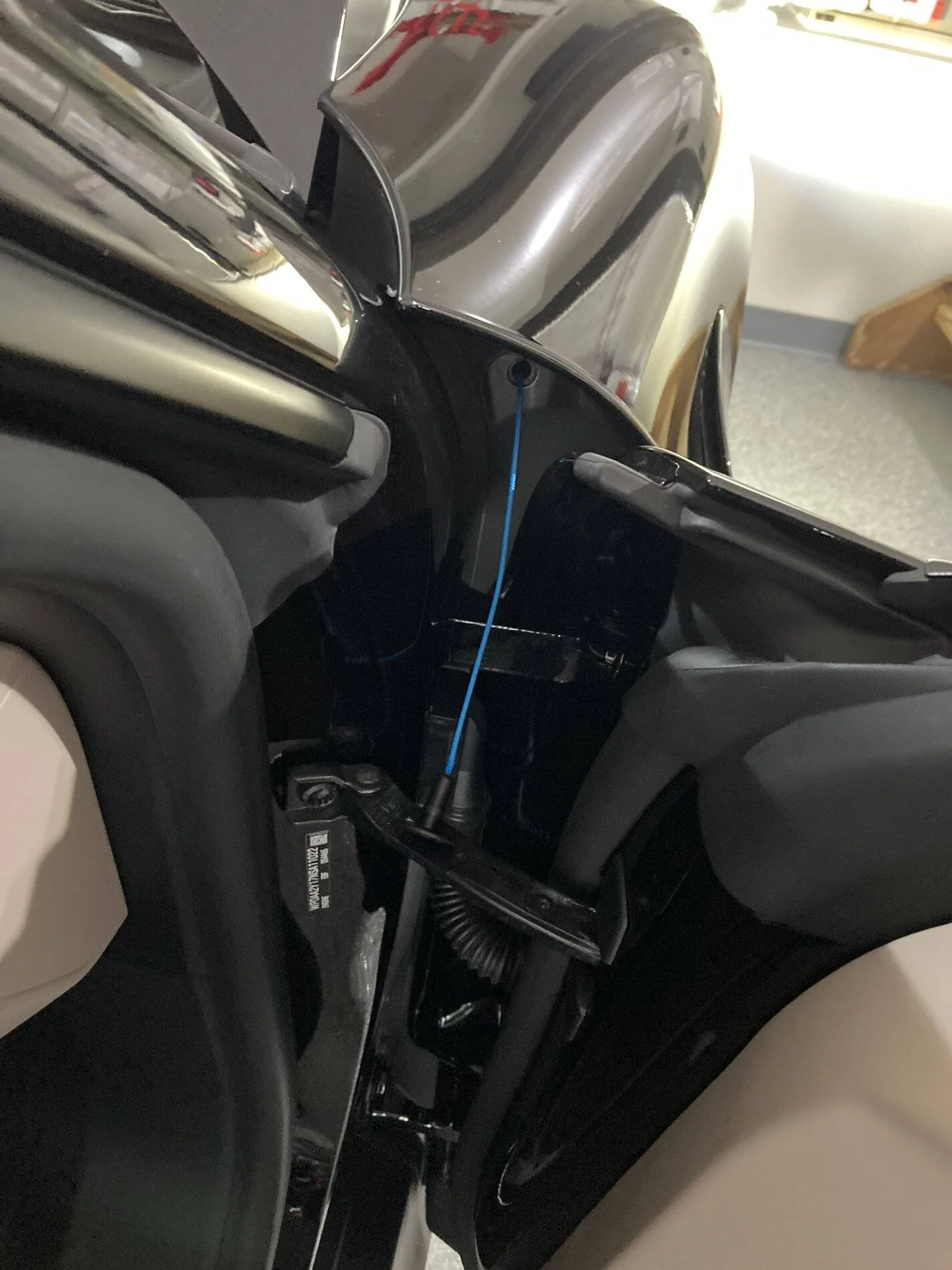

Anyone know how to return the plug release to original position? The cord has too much slack in it for me to simply shove it in by hand.

I had the dealer fix it when I brought it back to repair another issue.

I had to get the dealer fix it. They said something in the mechanism broke when I used it. They implied they were seeing other cases like mine.

Thanks for your help! I got it back in. Used the tip from one of the previous posts - slowly push the cord back into the hole.
