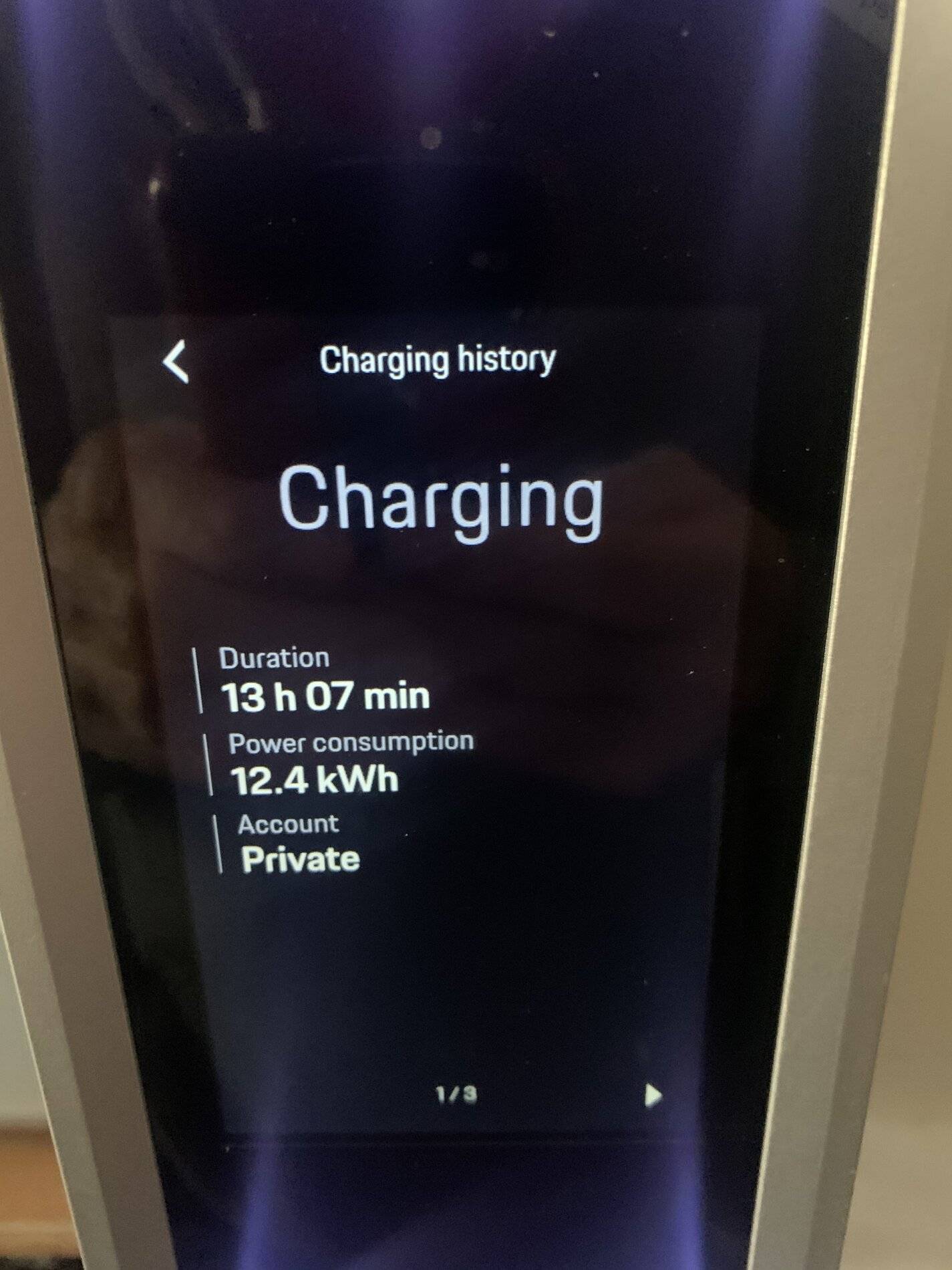

I tried looking at the charger. It has three pages of charging data, presumably the last 3 days. Like this:
Porsche Taycan PMCC electricity usage? FA4F65F4-BFD5-4FE8-ABBD-8FE686C0EDFD
not very useful. It doesn’t even say the dates. I tried pointing a browser to the IP address of the charger. Nothing there. Too bad. It wouldn’t have been very hard for them to give you a lot of useful info. Presumably other chargers do.
