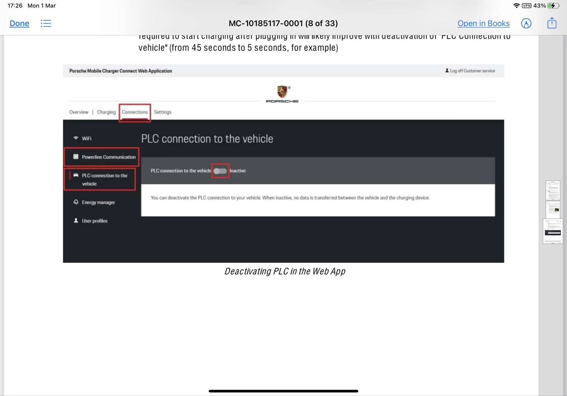

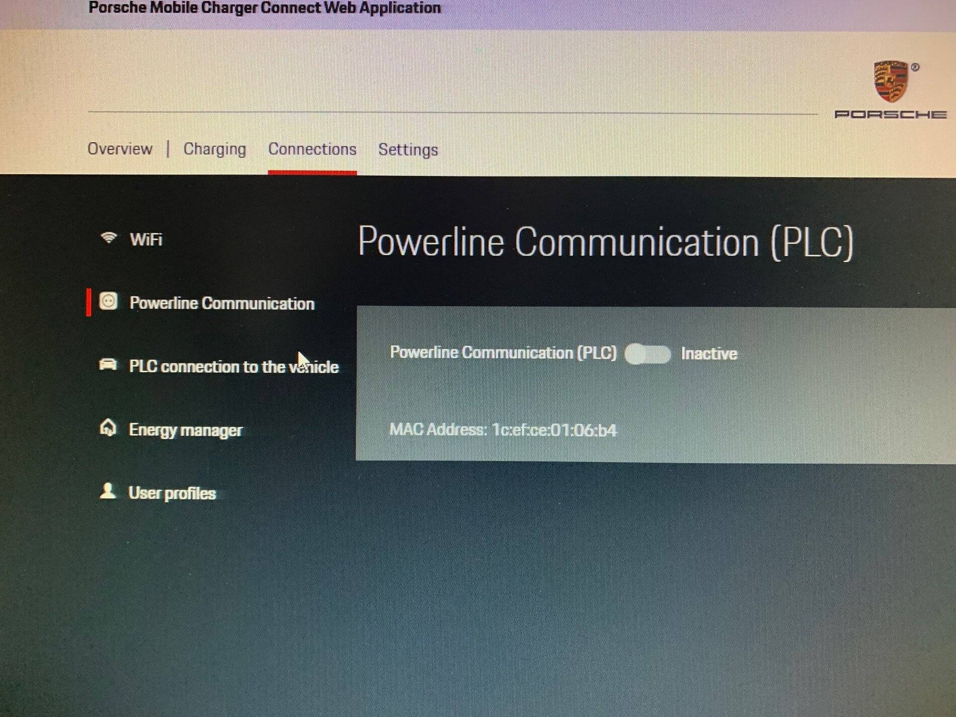

In the PMCC web application, there seem to be separate settings for disabling/enabling PLC into the charger ("Powerline Communication") and for disabling/enabling PLC between the charger and the car ("PLC connection to the vehicle"). I disabled the first one but left the second one enabled, assuming that the charger and the car need to recognize each other somehow. Wrong?
In Europe we can have PLC connection between the PMCC and the Home Energy Manager. That way the power the car gets is monitored depending on how much power is available without blowing a fuse. What reason there is for the car to have the PLC connection to the charger I have no idea. Could be reserved for some future updates so that you can distinguish between different cars using the charger. It seems to be in the menu of the PMCC but no idea how to activate that.
So, the warning to disconnect PLC to minimize the risk of 12V issues, would that be for the home-to-charger PLC or for the charger-to-car PLC, you think?
Wrong. Do not use PLC unless you have no WiFi. One is a substitute for the other.
Risk of 12V drain issue if PLC enabled and charger left connected.
Thanks. I will switch the second one off as well. I wrongly assumed that the handshake between car and charger happened via this car-to-charger PLC.
I would have thought that it is for the Vehicle to PMCC? I looked at the information in the TSB as below.
