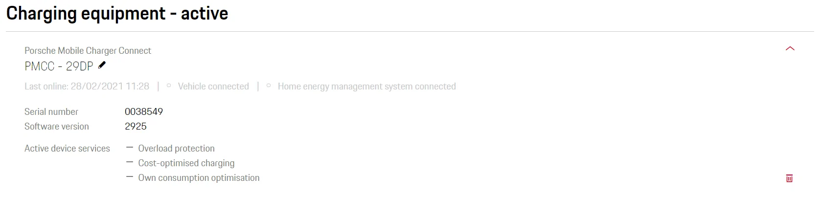

I tried multiple times on a few occasions to link the charger up to my account without any success. Then the update came and I tried a few times more again without any luck. I'll keep trying...
Ok! I have had my charger visible with all charging sessions in MyPorsche before the update. I guess the PMCC was connected to my account since I received the update. But now I have not been able to establish that connection again. I am able to see all charging data etc via my local home WiFi, no problems.
I guess I could try a full factory reset and see. I am a bit reluctant to do that since I need the PLC connection for linking my Energy Manager?

Have you tried a full reset on the charger and started over?
Have you checked My Porsche under Home Charging service if anything has been registered? It could be that there are incorrect details associated which also need to be reset so that you can make a clean start.
I have seen the reset function, but did not do it, since I prefer to keep the data. But that will be on my list in order to get Plug&Charge with PIN enabled.
Good idea, I will look into this.

Your data should be available on My Porsche - Services - Charging At Home tab - you can export all history (PMCC only stores a limited amount) to a CSV file for posterity or whatever.
On the same page scroll down and check also - where your details are registered (if ever).
Porsche Taycan PMCC Software Update This Morning 1614766271644
However, in your last post you mention your PMCC is too far away from your WiFi - if so, I don't see how you can ever register the device nor associate your Porsche Connect ID to the PMCC - it must be networked in some way otherwise you are effectively chasing your tail and attempting the impossible.
PMCC can act as a hotspot but that essentially enables you to connect via a mobile device directly to the PMCC but nowhere else and crucially not to the Internet where you need it to be for this to work properly.
