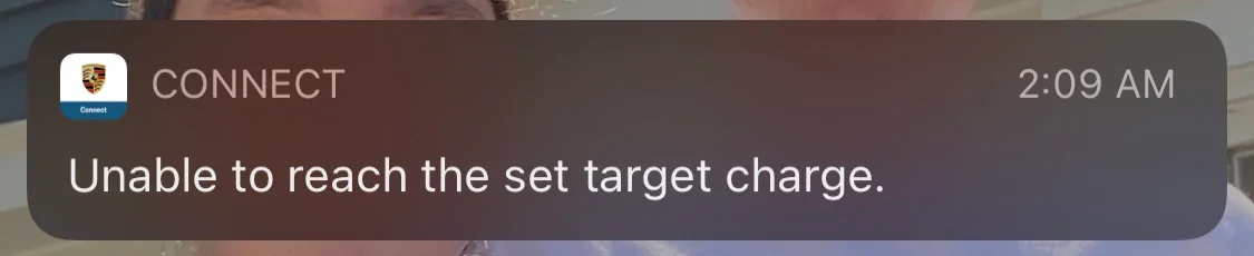

My PMCC updated yesterday and I'm running Connect v4.4 on iOS and got the following alert at 2am ET -- I've never seen this before:
Porsche Taycan PMCC Software Update This Morning IMG_4304
I haven't changed any charging settings via the app, car, or website. When I checked the car and charger this morning, everything was fine and my car charged to 80%, just as it should.
Has anyone else seen this? I'm thinking it was a spurious issue that was partially caused by the PMCC update.
I've had that a couple of times before (and pre updates). I think you can safely ignore and may relate to profile / timer settings which couldn't quite complete their tasks - a guess on my part.
Generally I see this when the specified time on the timer is close to being reached but there isn't enough time at the current charge rate to hit the desired target charge level.
