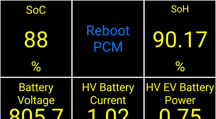

It's pretty simple with an OBDII dongel and the app.
Just press the "Reboot PCM" (my own custom text btw).
Or use the "two finger" reset.
Sadly, the two finger reset did not work (that's what I meant when I said "reboot via engineering mode") - did it twice, both times the PCM got stuck at "Taycan" on the screen. Is the OBDII reset basically truggetin the same thing as the engineering mode which shows up after the 2 finger tap?
