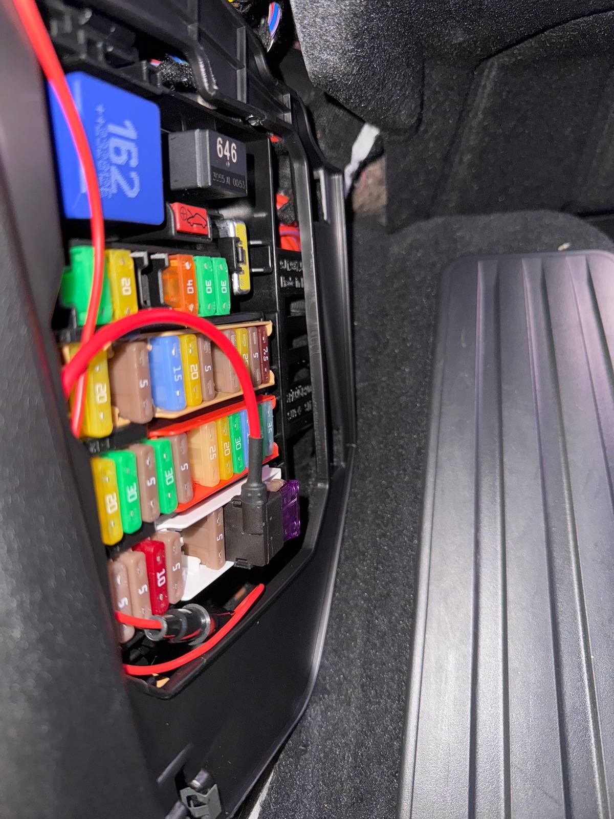

Very, very helpful guide, thank you! One addition in case it's useful, I just wired my detector in my 2023 Taycan GTS, I found that the entire lower fuse block in the driver side kick panel location is switched with the ignition, so if you have an empty slot (mine has several that are not used), you can just put a fuse tap into any empty slot and not mess with an existing circuit. Also, I think (but I don't remember for sure) that the powered side of the lowest fuse block is the bottom.

Thank you so much. Also want to confirm that the hot part (12v) of the fuse is bottom. I know it will work either way with fuse tap, but the right orientation, should I just follow your diagram and have the fuse tap wire facing up?

I think(?) it's dependent on the fuse bank row. I used a multimeter to confirm but you should also be able to see which side has the metal contact just by shining a flashlight into the fuse banks.

This was way way easier then thought. Thank you so much for the detailed pictures. The panels popped so easily with a single trim tool and the instructions were spot on even for RWD US version.

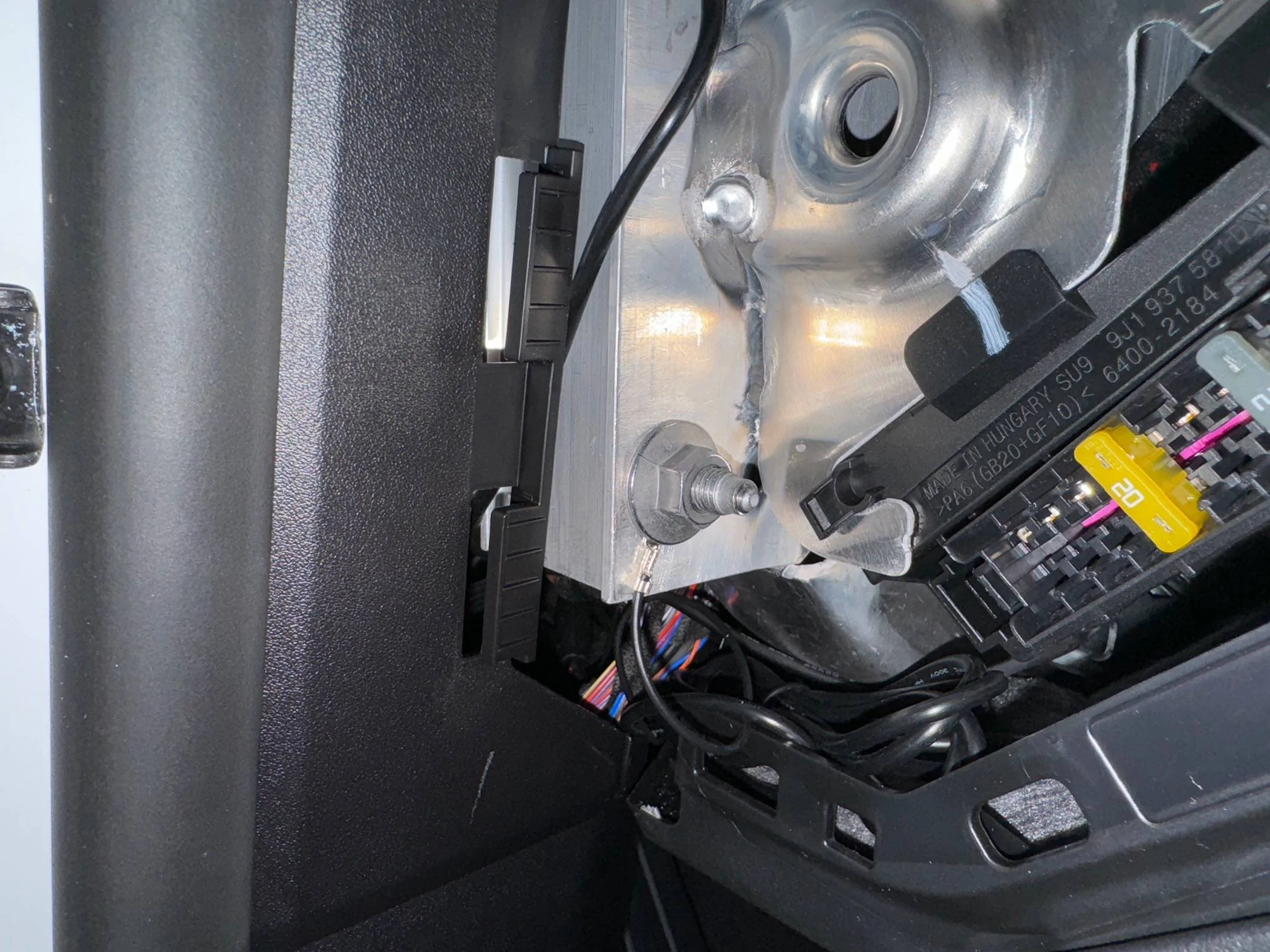

This week I received my new Valentine 1 Gen 2 radar detector. I wanted to hardwire it, but didn't want to use the mirror tap. I decided to use a fuse tap to power the V2G2. The fuse box is located in the driver's footwell for US cars. Row C, slot 8 is the fuse for the Interior Mirror. The power switches on and off with the "ignition". The pink plastic covers that cover the fuses are a pain to remove. I called the dealership to ask how to remove it. I got a long speech about how it is a high voltage electric car and I shouldn't be touching anything in the fuse box. It was a useless and clueless conversation. I found a black tab at the end of the pink plastic. Even after releasing the tab, it is not easy to remove the pink cover. I broke the tab on row A. It won't make a difference since the fuses are well seated just like every other car.
*EDITED August 1, 2021 - Installation of the fuse tap is still correct, but pic 7 was edited to correct the identification of the load and hot slots/blades of the fuse - thanks @911jeff
Fyi, currently the V1 Gen2 is mounted on the windshield just above the mirror instead of the visor mount in pic 1
Here some pictures.
