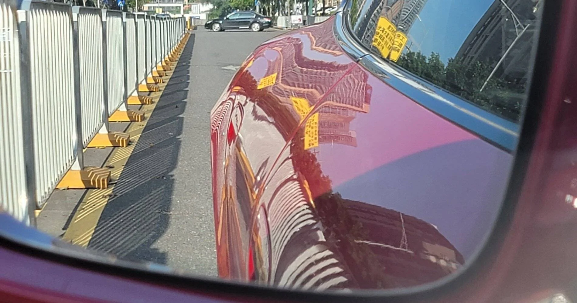

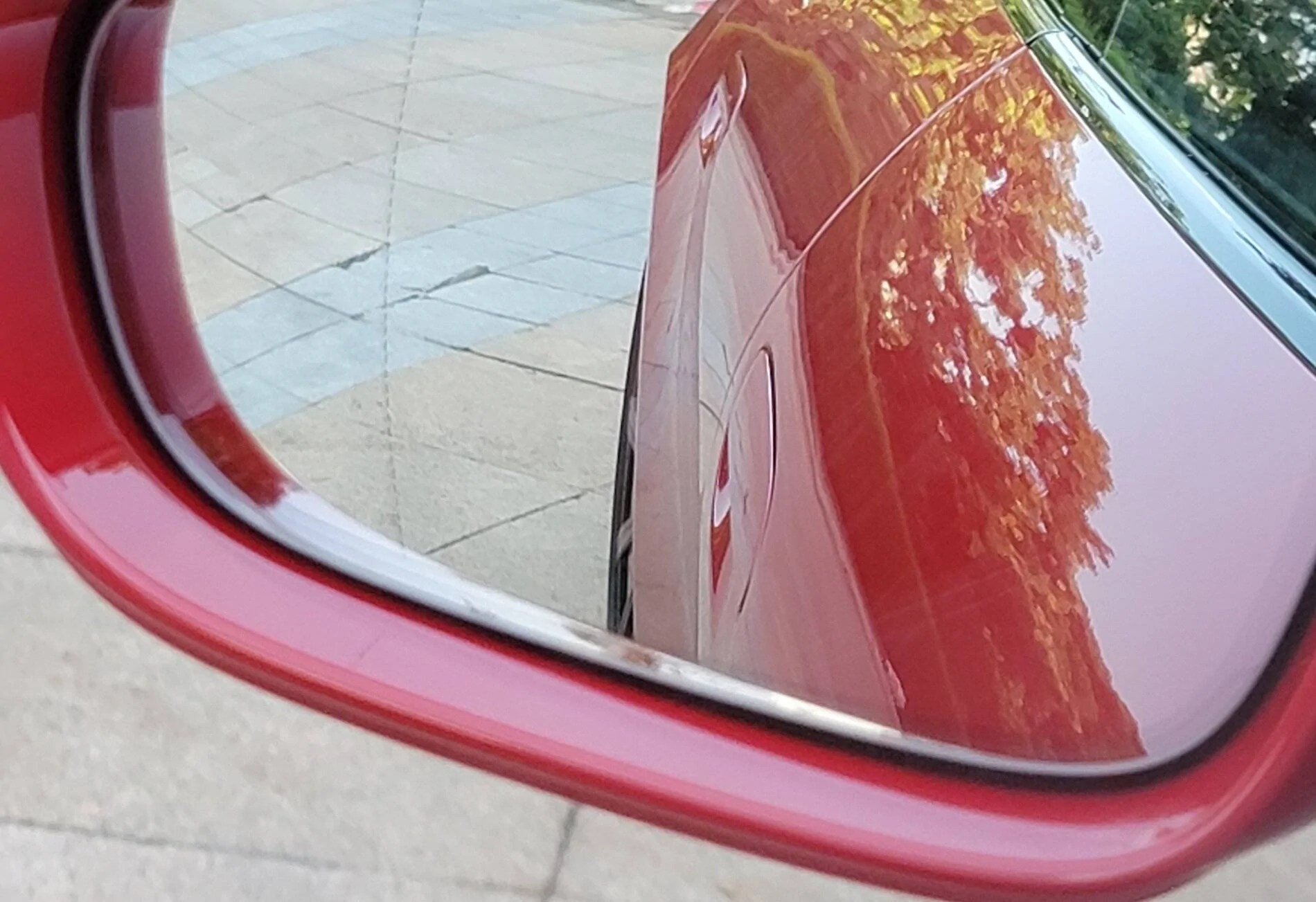

New owner here. Maybe this is a dumb question but how do I know if I actually have Rear-Axle Steering? ... I guess I can have someone stand outside while I slowly turn in my driveway and have them tell me if the rear wheels are turning too in order to verify it’s working. Has anybody actually done that?
RWS in action!
Porsche Taycan Rear axle steering 20211011_080534
Straight, cannot see the back wheel.
Porsche Taycan Rear axle steering 20211011_080820
Full turn, and clearly see the back wheel come out.
