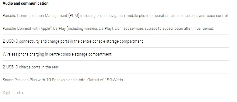

Wireless phone charger gets the phone insanely hot and decreases battery faster than it charges..
My dealer told me that it doesnt have wireless phone charging only wireless car play. Was she wrong?
I read that they had dropped the wireless charging and antenna. Certainly putting my phone in the cradle does not initiate charging on mine.
Market dependent.
Wireless charging in UK was / is standard BUT you have to enable Wireless Charging in the PCM (Phone ... Telephone Settings - General Settings - Cableless Charging). Once enabled a Qi indicator appears in the notification area when your phone is inserted in the holder (inside the impossible to use armrest) with the screen facing outwards.
UK standard spec (supply issues permitting):

Wireless CarPlay and Android Auto exist also.
