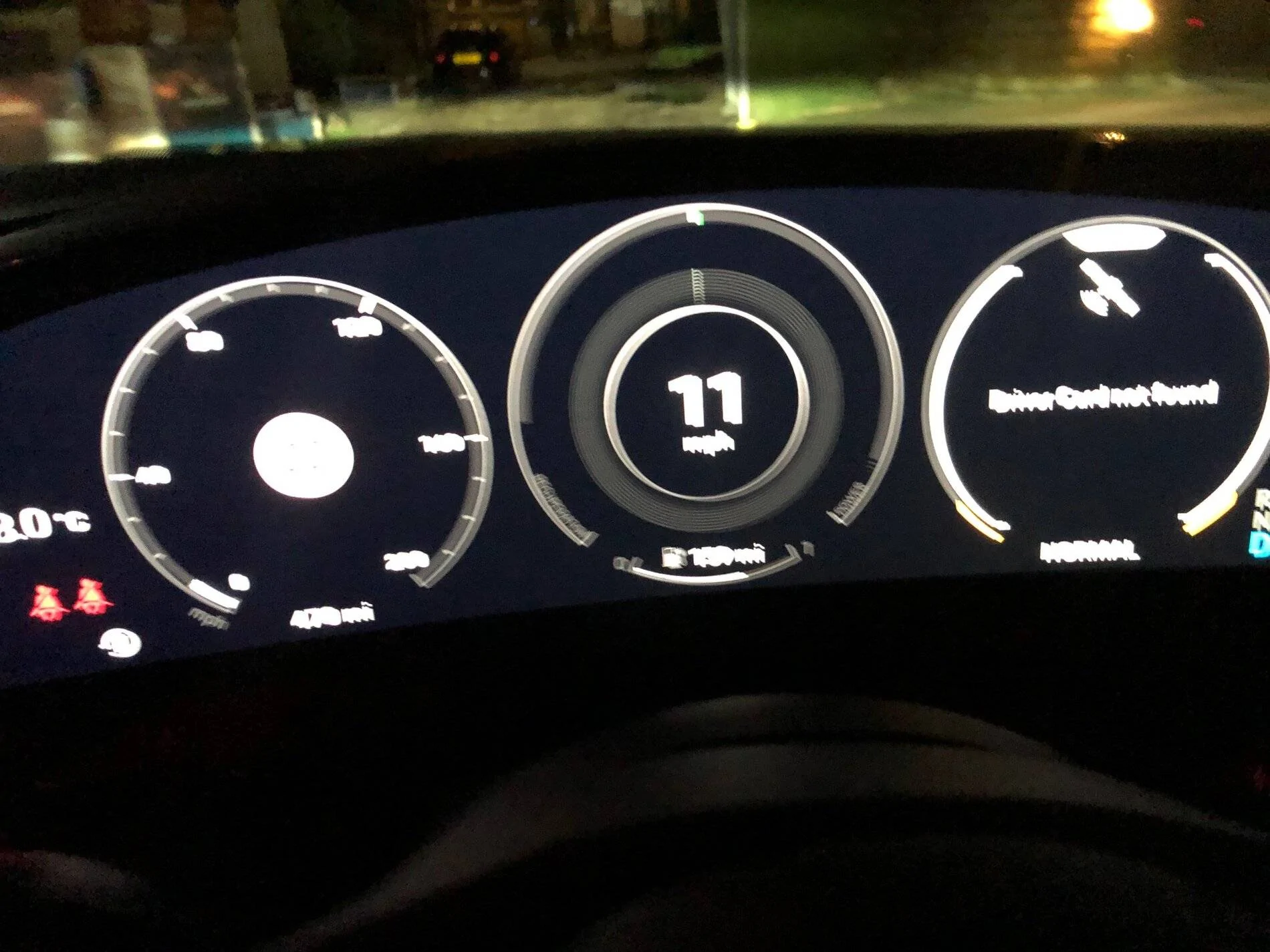

Does this help? (sorry it is a bit out of focus)
Yep, looks like the regen line goes around to roughly 9 o’clock which is correct, this grey line is dynamic in that it changes length depending on battery state etc. When you press the brakes does the green arc Extend?
