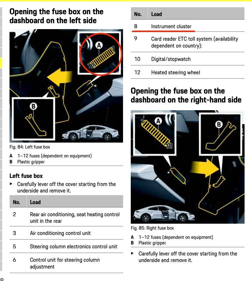

Did the terminal 8 reset procedure and Smart Lift reappeared in the menu.
  1. Remove the panel on the left side of the instrument cluster. Found it easiest to unclip from the bottom.
  2. Remove Fuse 8
  3. Lock your car and walk away for 20 mins
  4. Turn On the car without the fuse
  5. Reinsert Fuse 8
  6. Allow the PCM to fully load and reconnect to data servers
  7. Turn Off the car
  8. Reinstall panel by aligning tabs and pushing the panel back in
Wouldn't unplugging the 12v battery achieve the same result? And it's less involved procedure
xirtam2381
Apr 18, 2022
SoCal
Taycan 4s
Maybe, but I'd rather not deal with touching the battery if I don't have to.
3,904
3,549
Yes that works just the same.
My car came back from Porsche service after the latest ARB and brake recall. And all my stored Smart Lift locations had disappeared. I tried the battery disconnect and all came back properly then.
