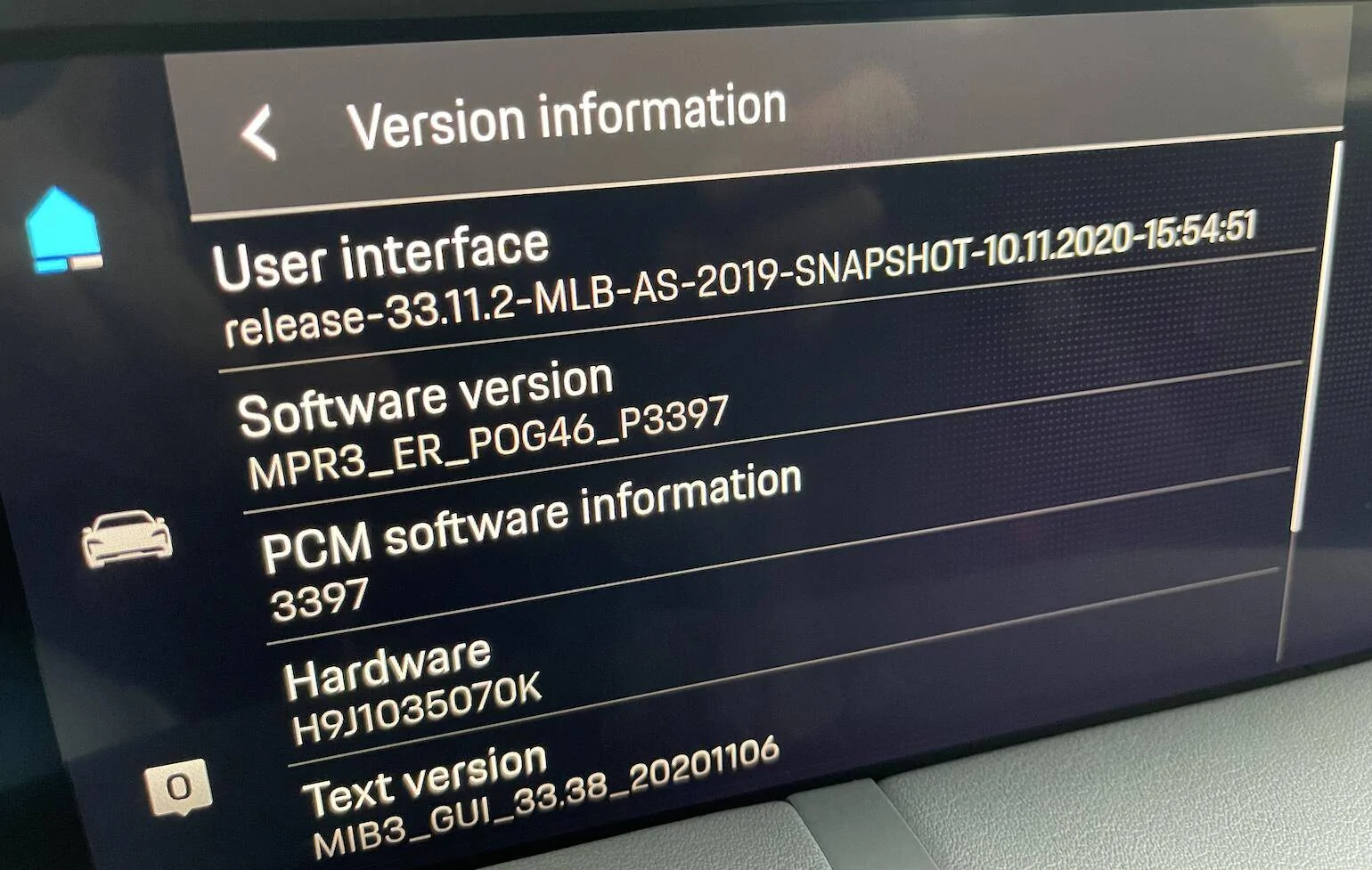

SmartLift disappeared on my 2020 4s about a week ago. Still waiting for it to magically reappear...

Did the terminal 8 reset procedure and Smart Lift reappeared in the menu.
  1. Remove the panel on the left side of the instrument cluster. Found it easiest to unclip from the bottom.
  2. Remove Fuse 8
  3. Lock your car and walk away for 20 mins
  4. Turn On the car without the fuse
  5. Reinsert Fuse 8
  6. Allow the PCM to fully load and reconnect to data servers
  7. Turn Off the car
  8. Reinstall panel by aligning tabs and pushing the panel back in
