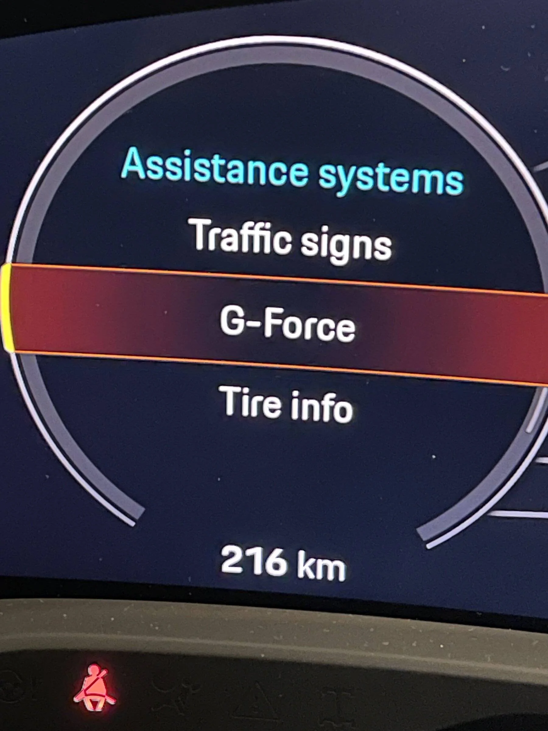

Do you have have the all wheel drive display in the instrument cluster (torque split)? I dont have that neither
I'm also in Vancouver. I just hopped into my car for you. No I don't have all wheel in the display. See photos.

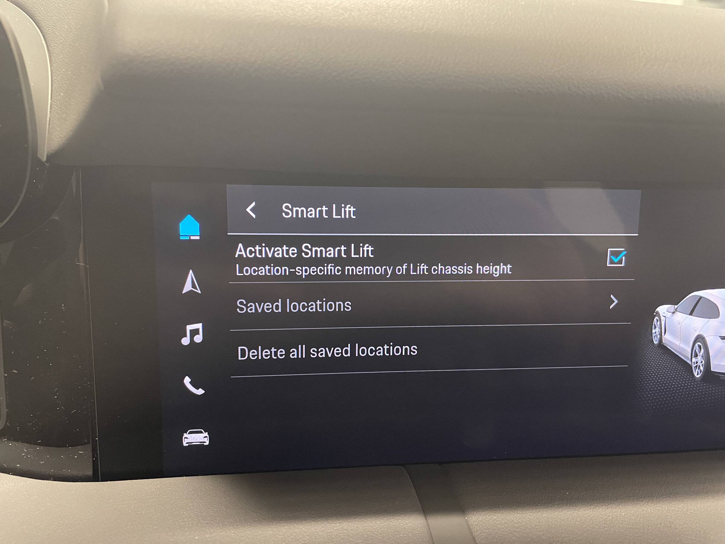

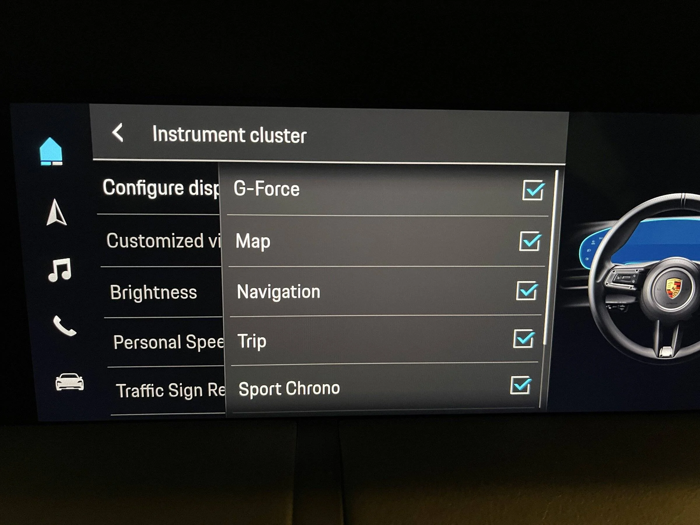

I am logged in though so don’t know why I don’t have smart lift. Can’t find a Porsche Pro who knows why.
Did you go to Settings + Vehicle …and scroll almost to the bottom ??mine was second from the bottom .
