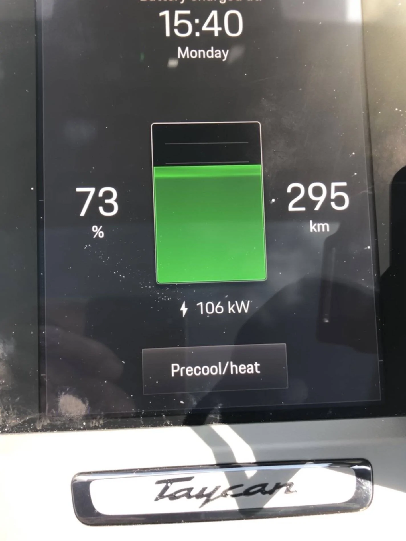

Having read some of the US guys reporting problems with HPC EA charging I wanted to see how Ionity worked. Great and no problems. Very decent speed in charging even at high SOC. see picture
