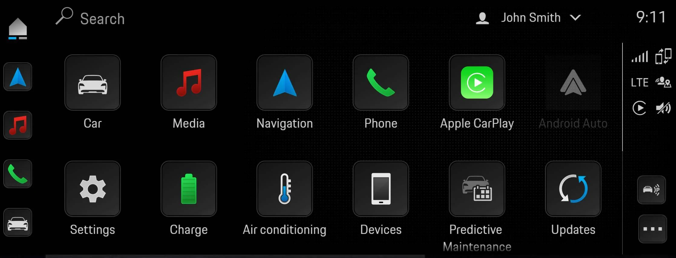

Bottom line is that the pcm update is not done if you still have the grey icons. It is possible to update other components without having the pcm update. no need to check the pcm version number.

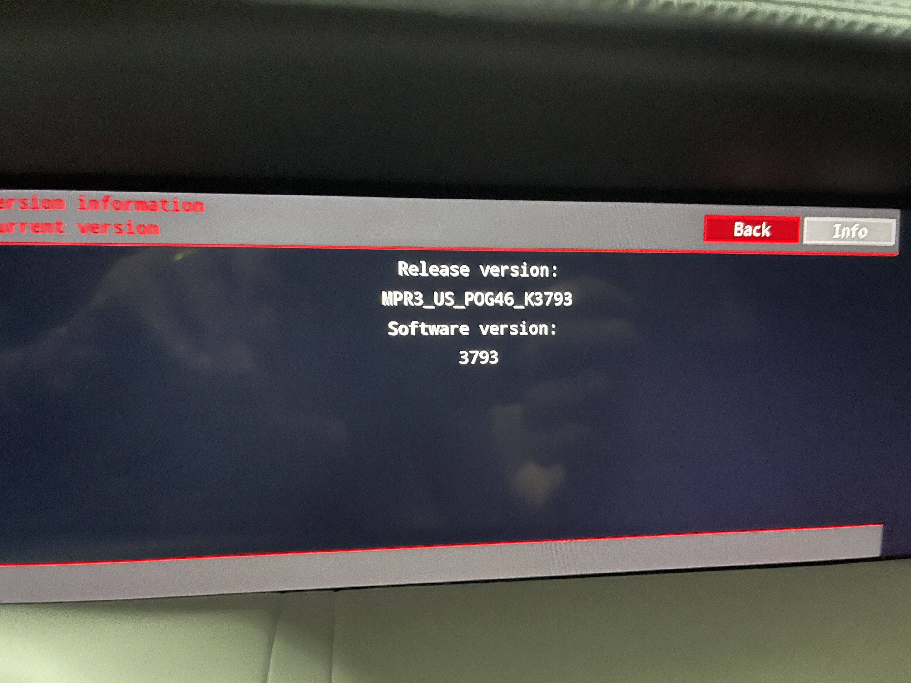

Press two fingers in upper right corner of PCM screen to get to maint menu.
2021 model - version 3793 - color icons etc. Visit another dealer who knows what they are doing.

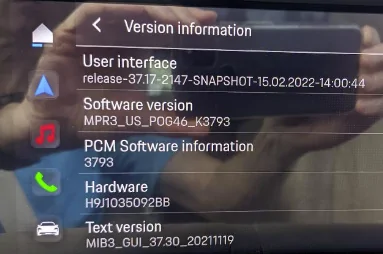

Another way to check without using the two finger technique:
My 2022 RWD was built in April and came with colored icons. The software version before I got the uPdate was number 3776.
My uPdate was completed last month (dropped off Monday morning and picked up Wednesday afternoon).
Tap the Settings icon (with the gear) on the PCM screen.
Then tap System.
Then tap Software information.
Then tap Version information. I have version 3793 as shown below.

It's a lot simpler and a basic visual inspection of the PCM will tell you immediately if you have the latest uPdate
If it doesn't look like this then you don't have it!
Ordering of the icons / tiles may vary but the crucial visual clue is that they are coloured!
Sounds like your dealer is not up to speed!
