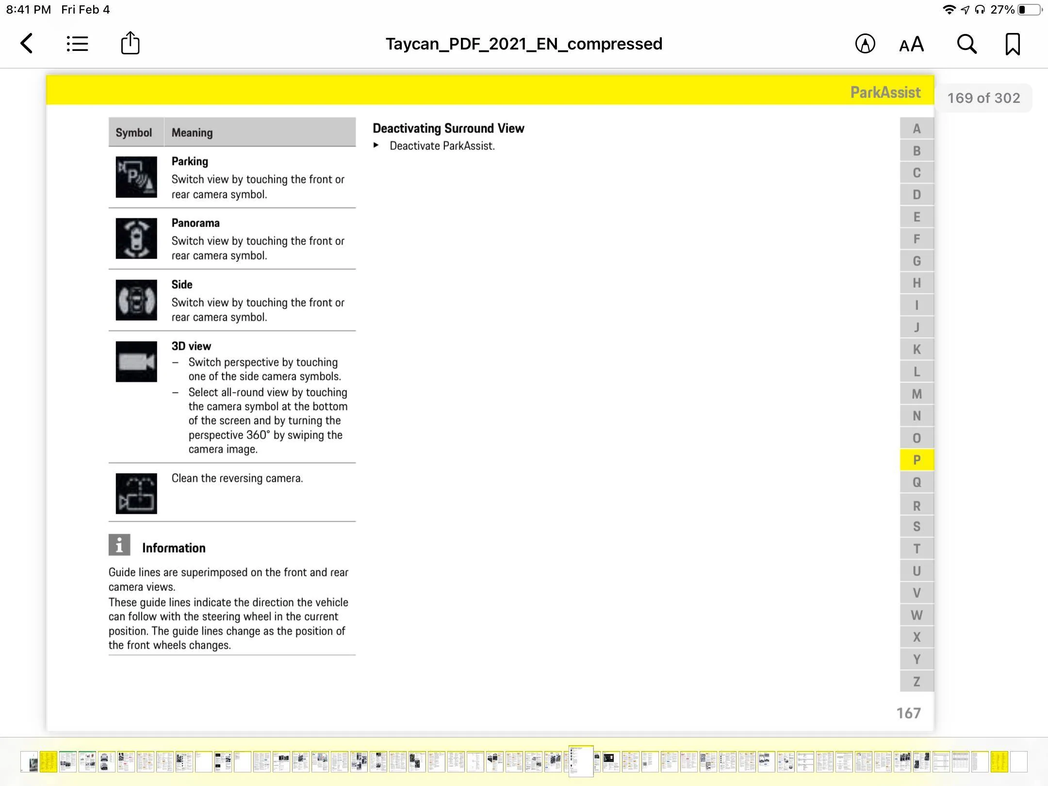

I’m noticing the same thing. From what the manual says, there is supposed to be a selection for the side mirrors, and a selection Of a camera that say 3D View. Neither are present on my car (Park Assist enabled). I have surround view (part of the Premium Package). Just another on the list for the dealer to solve…or explain ?.
